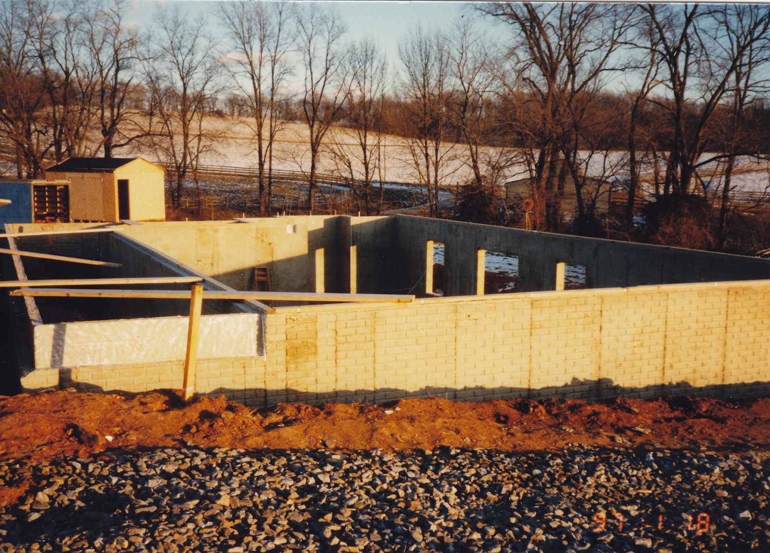

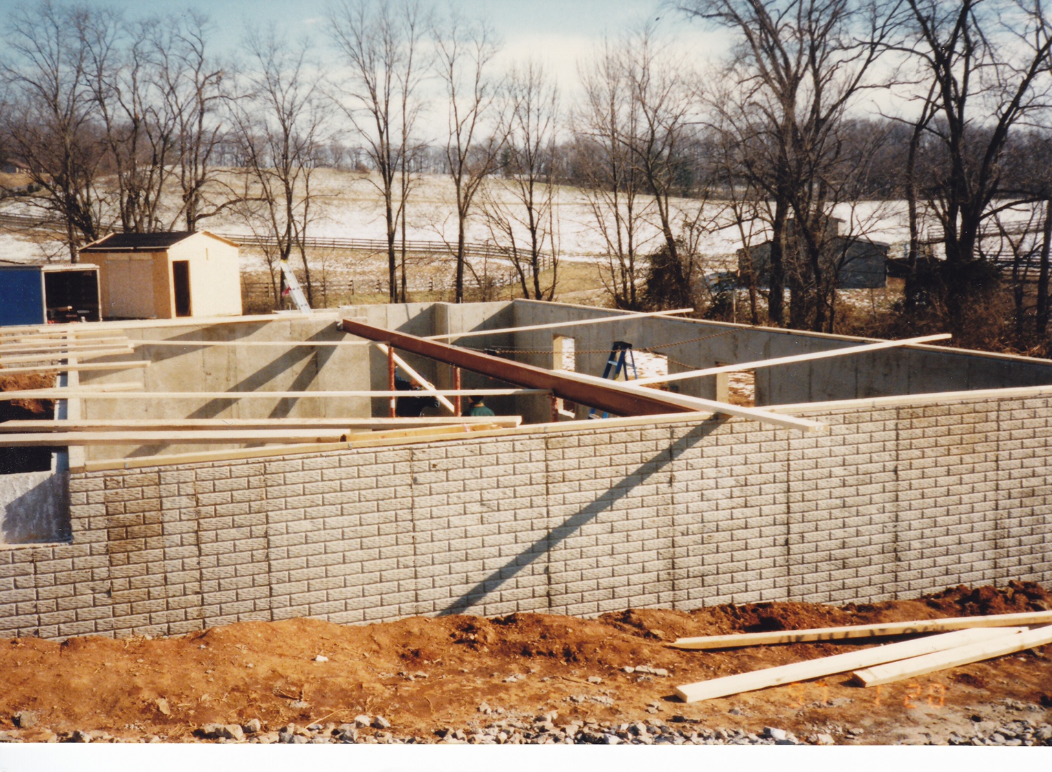

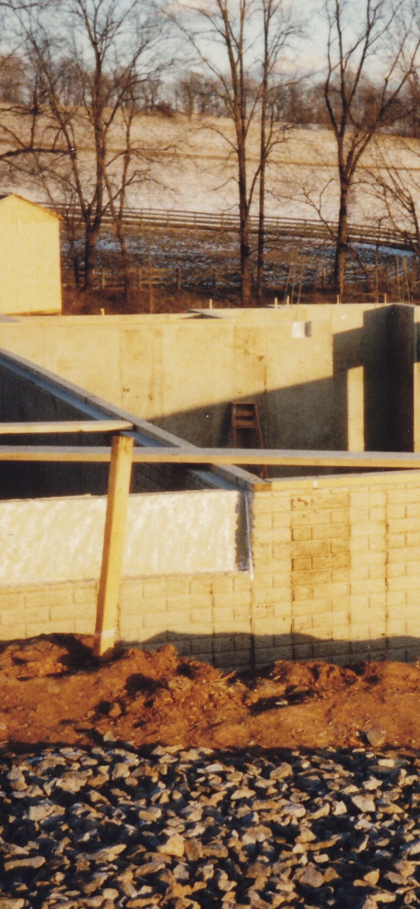

19970118 - started framing. Installed sill plates on top of foundation walls with foam seam sealer on concrete side. Bought an 8’ step ladder, as my 6’ ladder I had wasn’t tall enough . The basement walls are 9 ft high, to have 8 ft clear under the center beam and ductwork.
The sill sits flush with outer edge of foundation for the side and back walls, but front foundation is centered on the front edge of the house, so it will also support the porch slab.
Used my truck to pull the 41.5 ft basement steel beam up onto the foundation walls. There is a pocket in the foundation that the end of beam sits in, plus 3 steel columns. You can see the pocket on the far wall.
Post 3 has 2 more photos from this day.

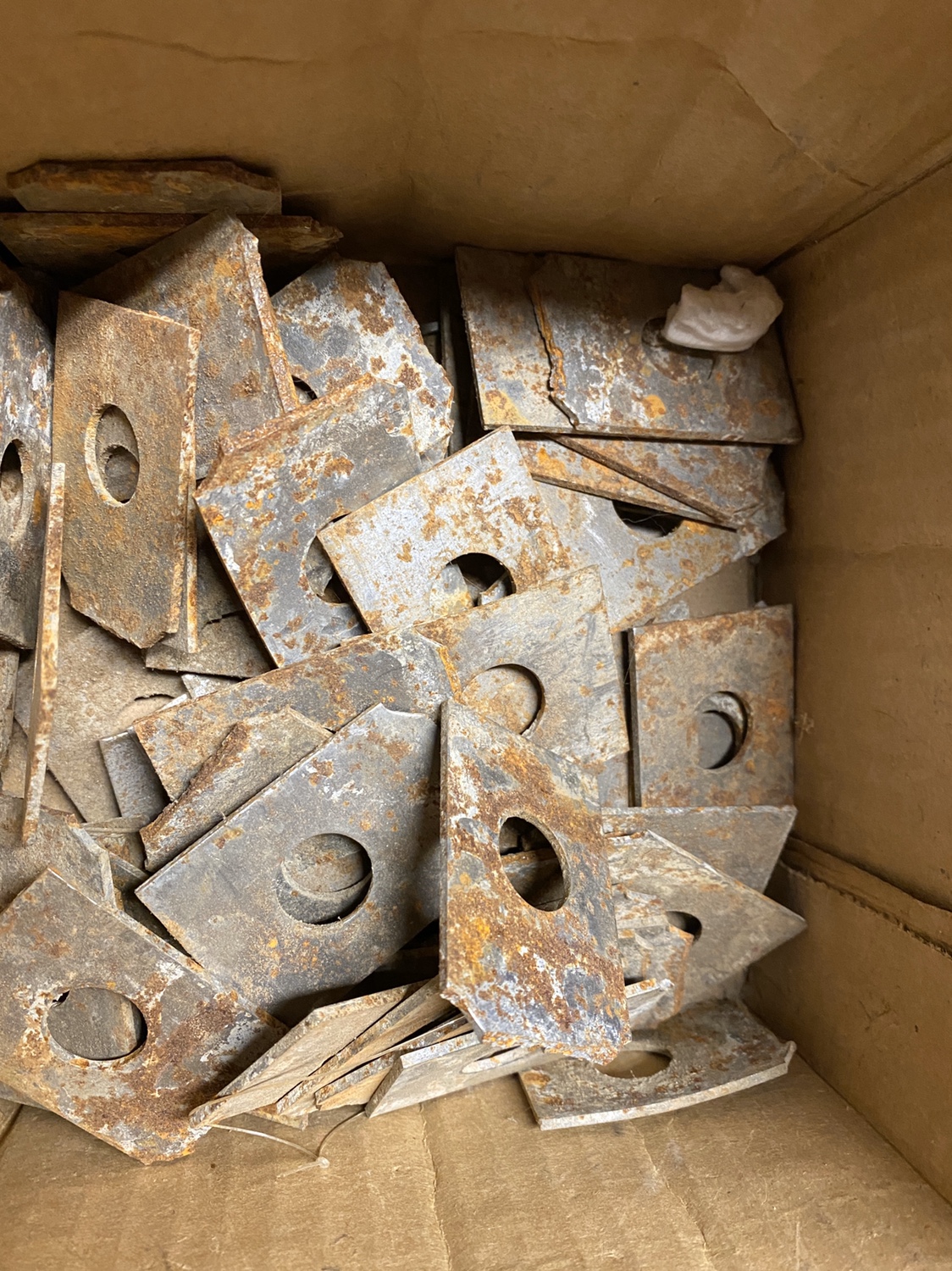

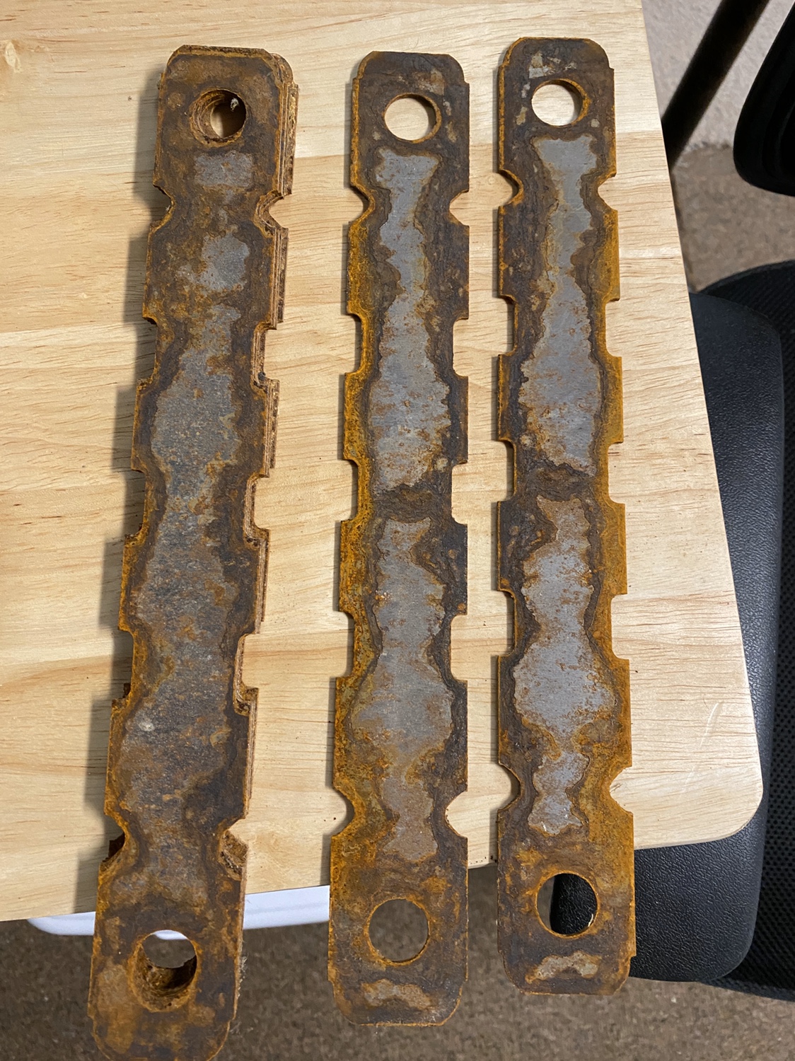

Found these on a shelf in the basement today. These are the broken off ends of the metal ties that got embedded in the concrete to hold the forms apart. After the forms are removed they got broken off. I kept them to use as large washers.
Dug some more and found some of the unused ties

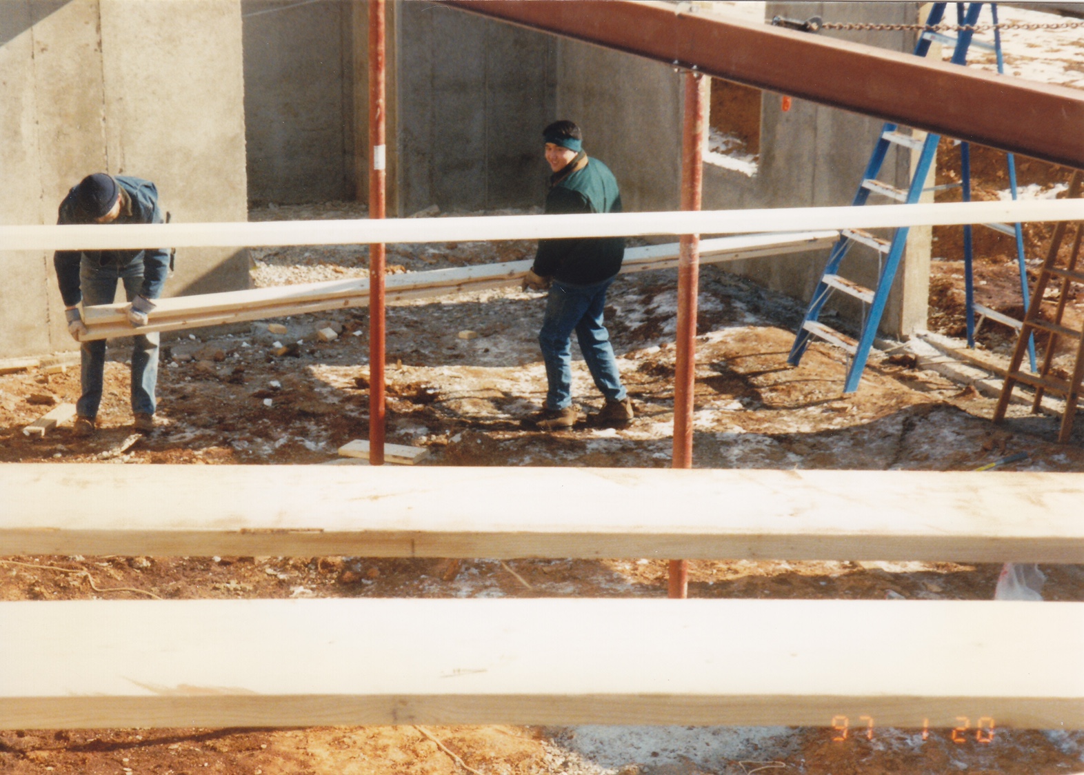

19970120 - the beam is set.
19970110 - steel beam was delivered
Had my first two volunteer helpers, hutch and a kid who’s name I forgot.

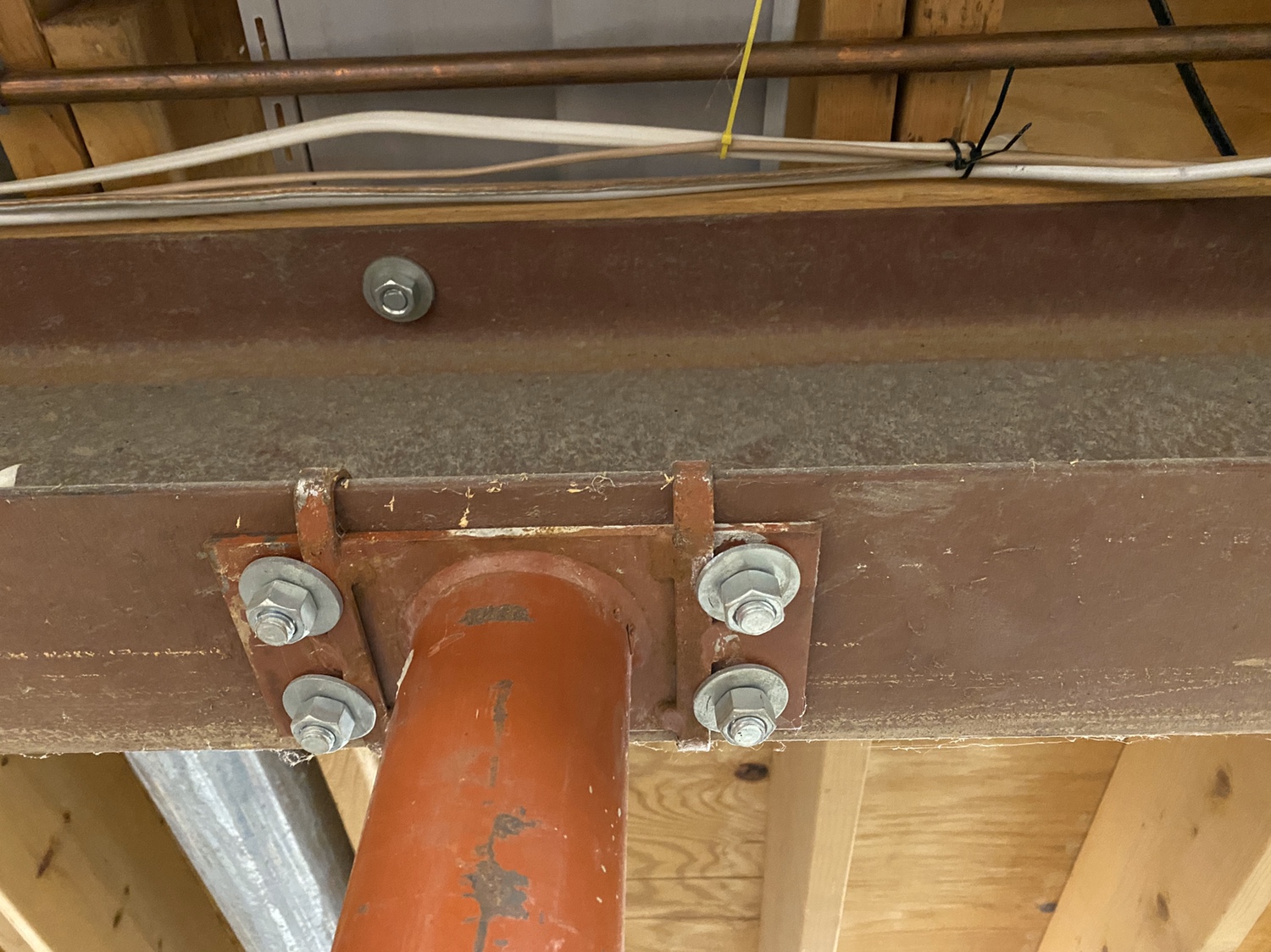

A day ago I pulled the steel beam onto the foundation. The beam has 3” bearing at each end, so we put the beam across the basement opening, with 3” bearing, and carefully pulled it across to the middle of the foundation. I filled the pocket holes with blocks of wood and got the beam on the blocks, them I jacked up each end and removed a block at a time until I got it lowered to the bottom of the pocket.
Once in place I attached the steel columns. When I ordered the beam, they asked if I wanted it punched. I said sure, not knowing exactly what they meant at first. Well, they had holes punched in the right places to bolt on the poles, and holes on top to bolt on the sill.
I later borrowed a transit to adjust the poles to level the beam.
Also once set in the pockets, I added some temporary braces to hold the beam in the center, until I got joists on.
Once I got the sill on the beam, I began installing floor joists.
