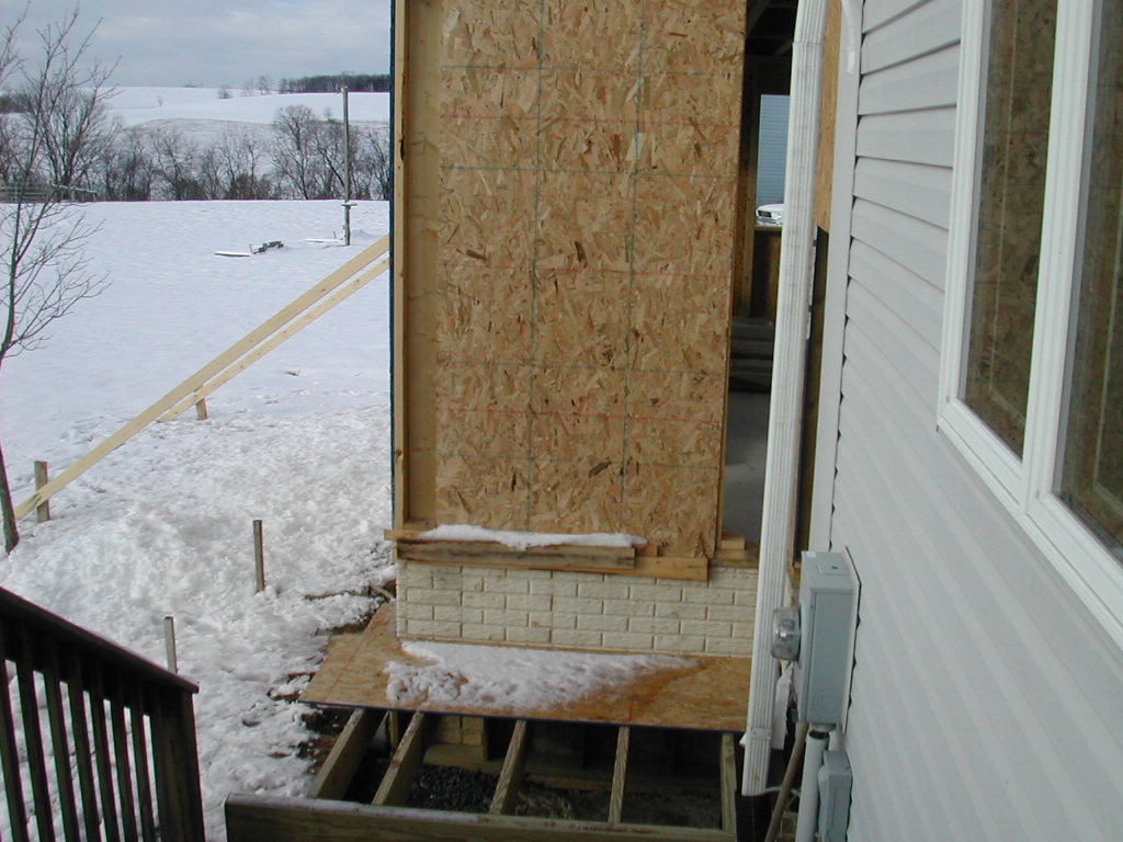

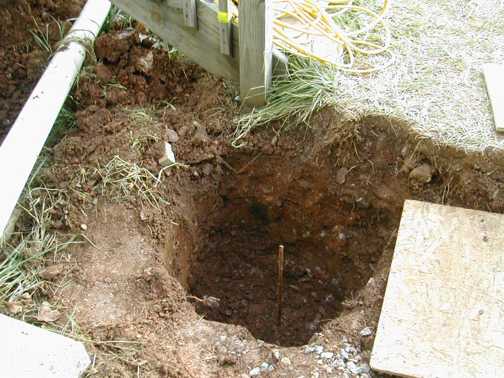

#642
Footer for a pier in the back. My electric lines come in under neigh20021218_MD_Home_012.jpeg so I bridges over with a small enclosed deck, for the entrance to the garage basement.

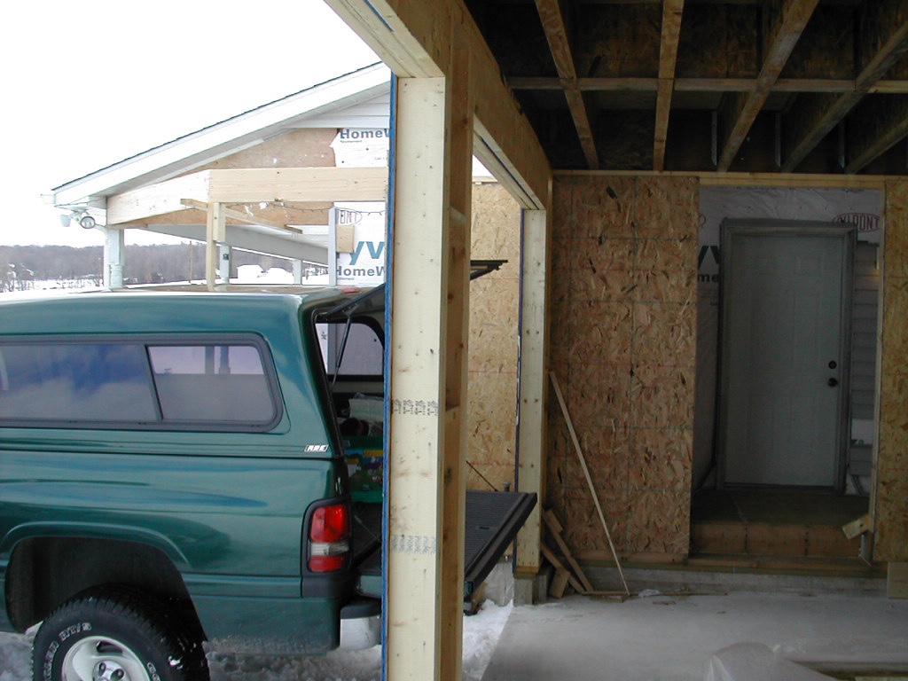

#643
Bottom of picture is deck outside the basement steps. I ended up enclosing this and made the entrance to basement where the osb is standing.
New door to garage got installed in this opening.

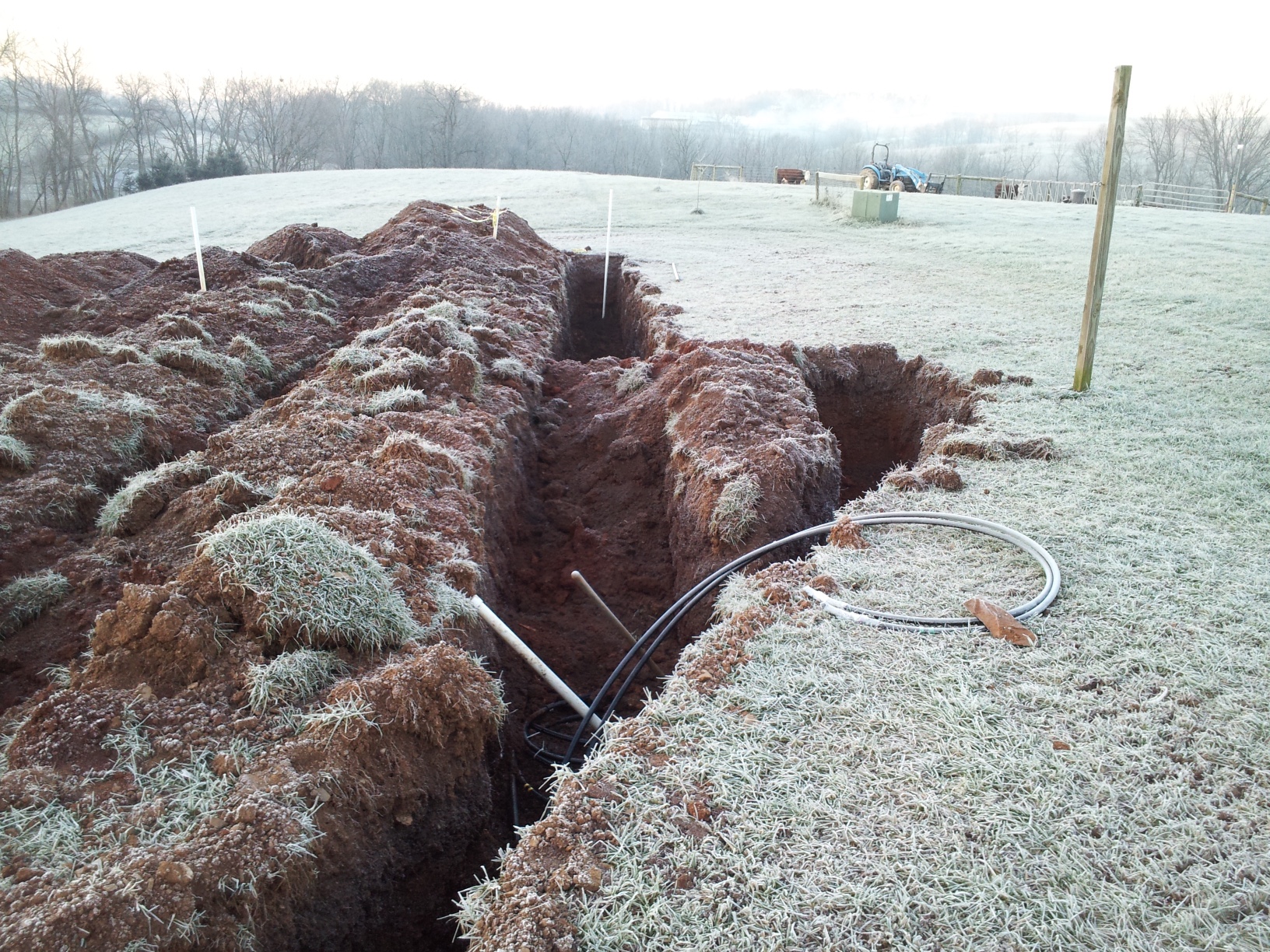

On this day in 2011
20111213
Had 3 geo loops in and digging the 4th trench. As I dug I put layer of good topsoil on previous loop, rest of top soil in between the trenches, and fill went in the previous trench.

I always wanted to put a geo loop on the beach. I figure the saltwater connected to the Pacific Ocean would be a heckava heat sink. Bureaucrats do not think so.

Neighbor is building new house using geothermal wells. 4, 180ft deep. Drilled thru 90ft of bedrock. I didn't ask cost....
Trenches would have been a LOT cheaper...

If you have the area, slinkies are a lot cheaper to install. If you have a pond, sinking the loop in the pond is great. My slinkies are 65ft long, 3 ft wide. 500 ft of pipe, plus 100 Ft in and out for a total of 700 ft per loop. I have 5 loops, 2 for a 2 ton unit, 3 for a 3 ton unit.

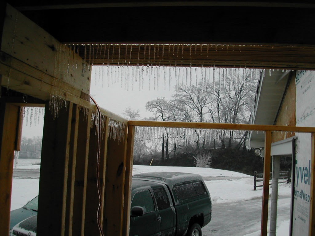

#650
We got 7” snow, now freezing rain in top
