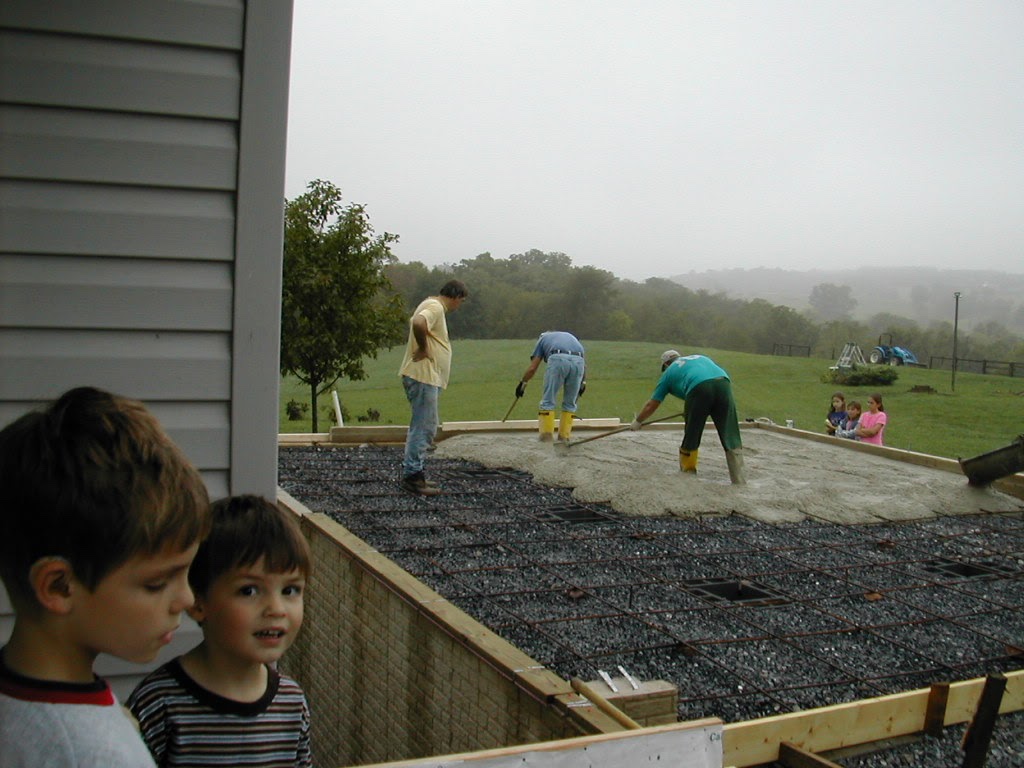

Oct 15, 2020 / This day in 1997, of my house build Thread Starter #622 OP buckeyefarmer Epic Contributor Joined Jun 25, 2005 Messages 26,941 Location MD Tractor Kubota L3940 L5030 MF205-4 BX23 20021012 pour garage slab I put in 6 piers down to bare dirt and filled the rest with gravel. Couple of my neighbors friends did the concrete, one works for a concrete company.
Oct 16, 2020 / This day in 1997, of my house build #623 ovrszd Epic Contributor Joined May 27, 2006 Messages 33,724 Location Missouri Tractor Kubota M9540, Ford 3910FWD, Ford 555A, JD2210 Awesome pic!!!

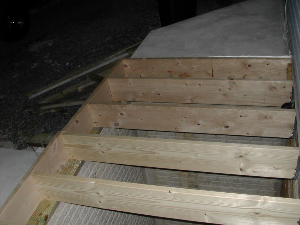

Oct 16, 2020 / This day in 1997, of my house build Thread Starter #624 OP buckeyefarmer Epic Contributor Joined Jun 25, 2005 Messages 26,941 Location MD Tractor Kubota L3940 L5030 MF205-4 BX23 20021015 start framing deck over the basement.

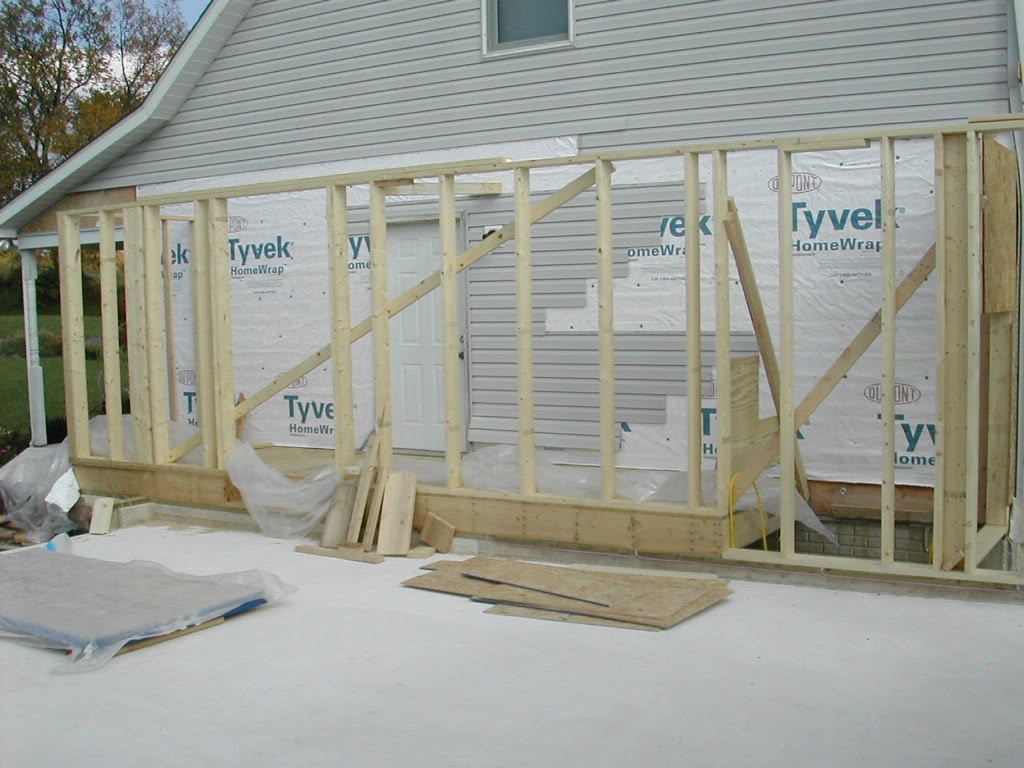

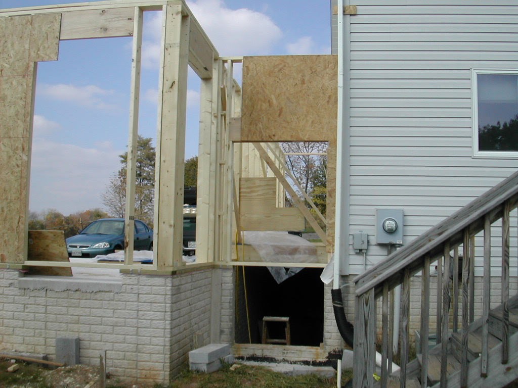

Oct 17, 2020 / This day in 1997, of my house build Thread Starter #625 OP buckeyefarmer Epic Contributor Joined Jun 25, 2005 Messages 26,941 Location MD Tractor Kubota L3940 L5030 MF205-4 BX23 20021027 garage Started framing walls, removing house siding as needed.

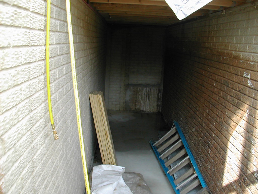

Oct 25, 2020 / This day in 1997, of my house build Thread Starter #626 OP buckeyefarmer Epic Contributor Joined Jun 25, 2005 Messages 26,941 Location MD Tractor Kubota L3940 L5030 MF205-4 BX23 20021027 Basement area Back corner wall
Oct 25, 2020 / This day in 1997, of my house build #627 ovrszd Epic Contributor Joined May 27, 2006 Messages 33,724 Location Missouri Tractor Kubota M9540, Ford 3910FWD, Ford 555A, JD2210 That would be a heck of a safe room if the ingress/egress is up to it. :thumbsup:

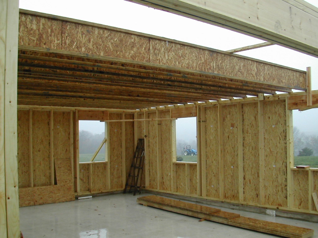

Oct 31, 2020 / This day in 1997, of my house build Thread Starter #628 OP buckeyefarmer Epic Contributor Joined Jun 25, 2005 Messages 26,941 Location MD Tractor Kubota L3940 L5030 MF205-4 BX23 2020116 Spanned 24 ft with trusses.

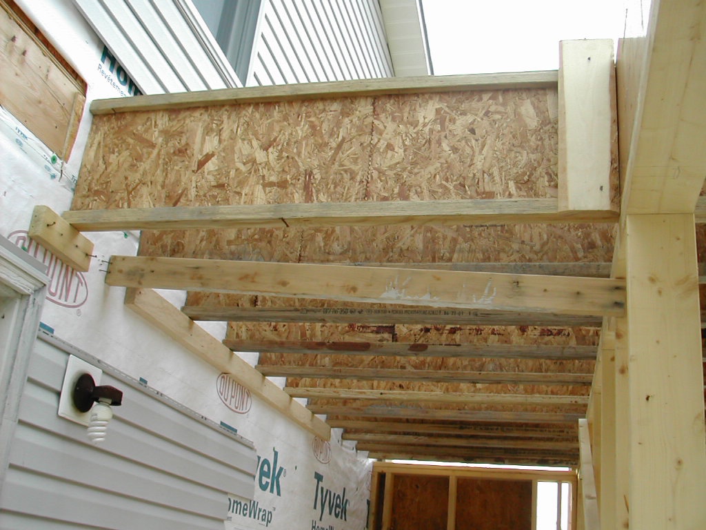

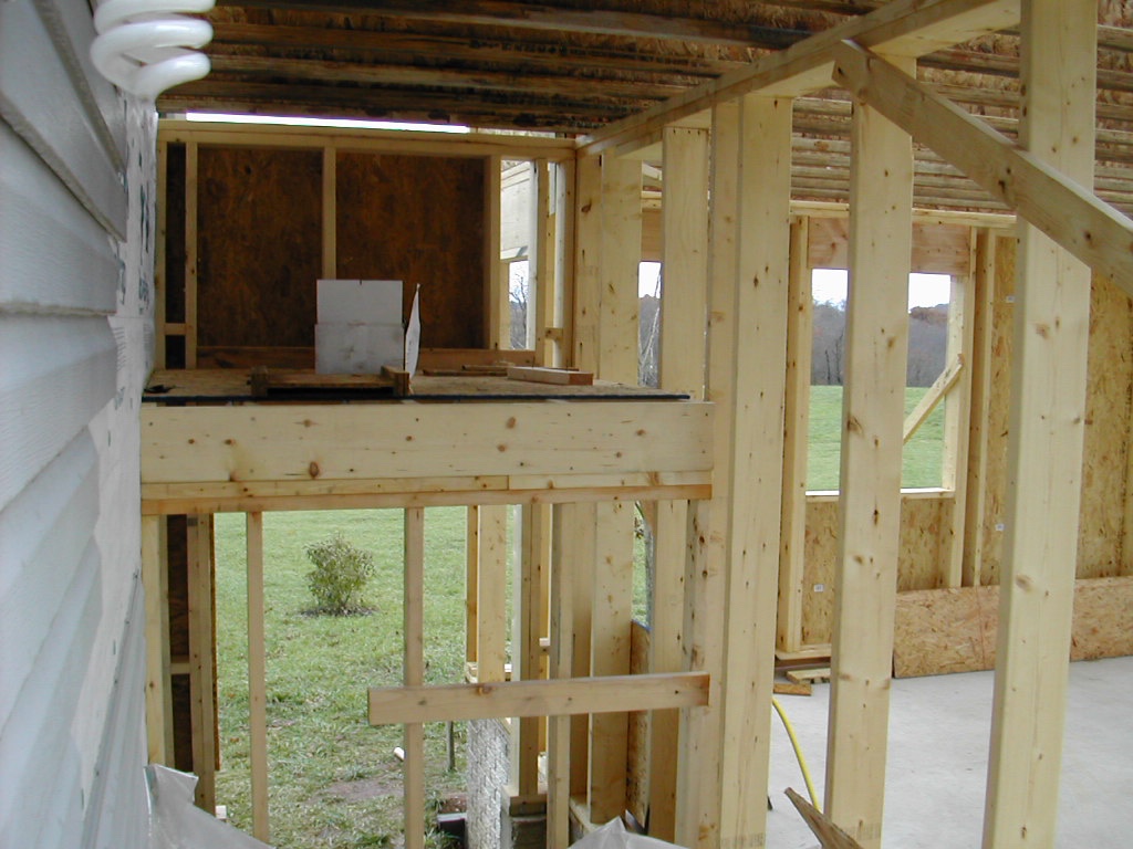

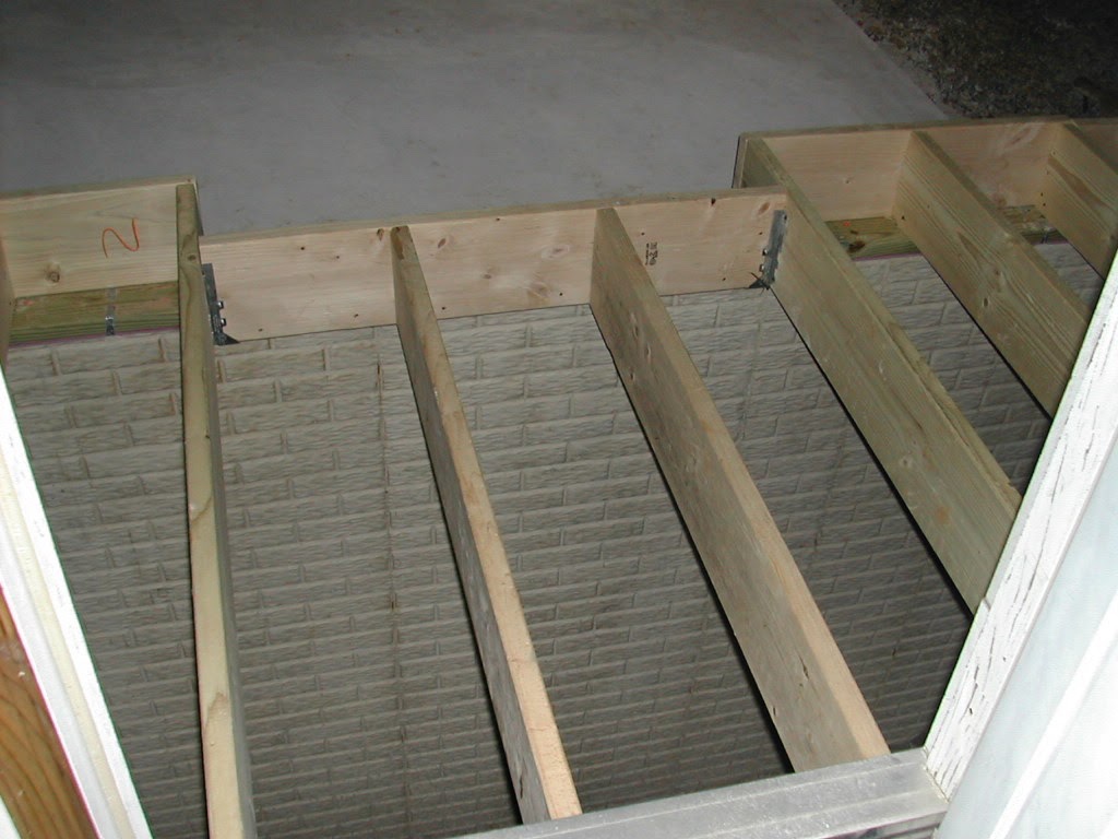

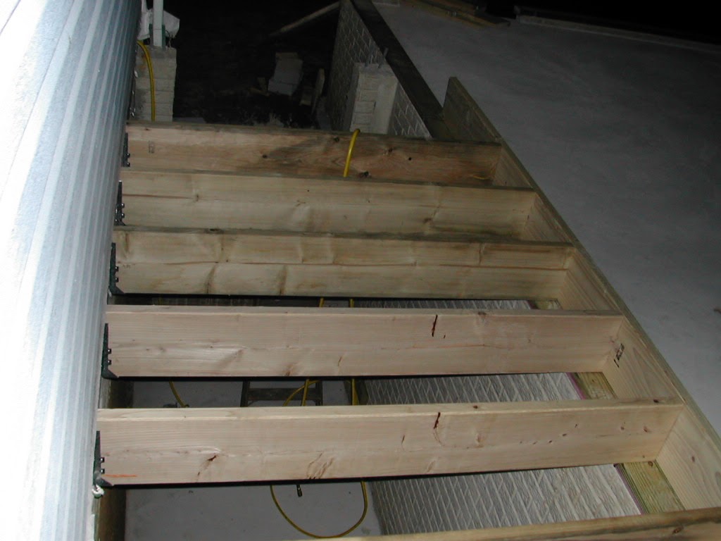

Nov 16, 2020 / This day in 1997, of my house build Thread Starter #629 OP buckeyefarmer Epic Contributor Joined Jun 25, 2005 Messages 26,941 Location MD Tractor Kubota L3940 L5030 MF205-4 BX23 20021117. Garage addition Deck over stairway to garage basement 20021128 Joists done. Rim board on. I bought trusses that span the garage and the “mud room” next to house. I ended up cutting the trusses and framed over the mud room with normal 2x10s I used the extra pieces as blocking.
