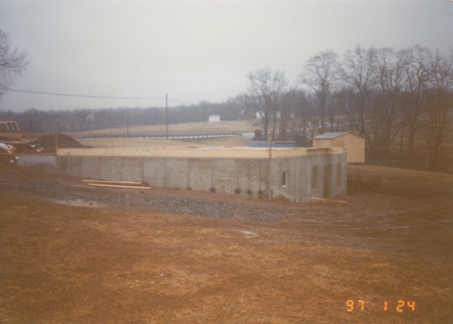

19970124 - more subfloor.
Took another day off work to work. Was up in night with a sick 1 yr old.

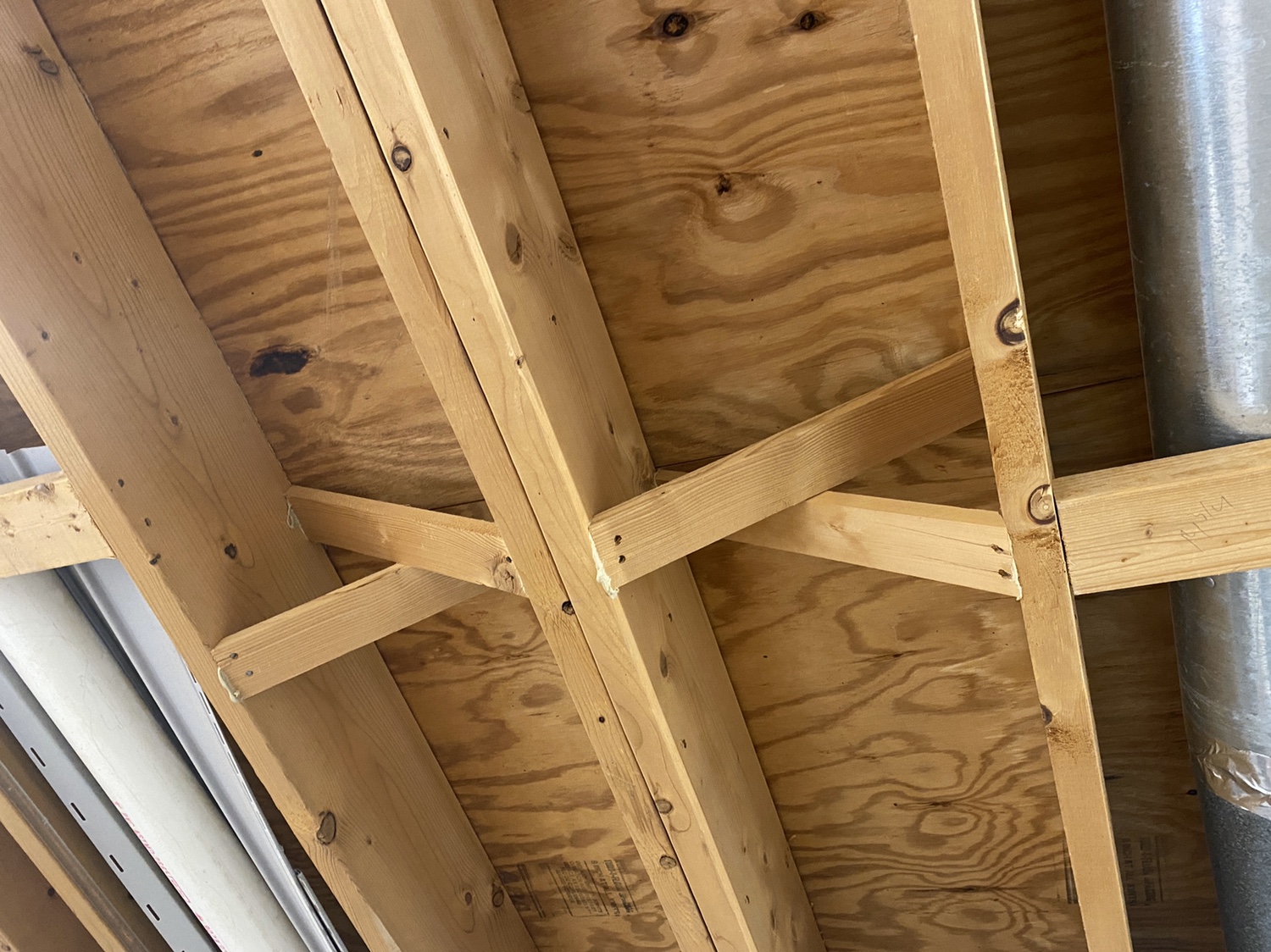

19970125 - joists and subfloor on the far end of FR. the span is longer, so joists are 12” oc on that section. Just need a 6” strip of subfloor on the back to finish the first deck.
Should have put bridging on when I put the subfloor down , but didn’t. Went back later with this.
