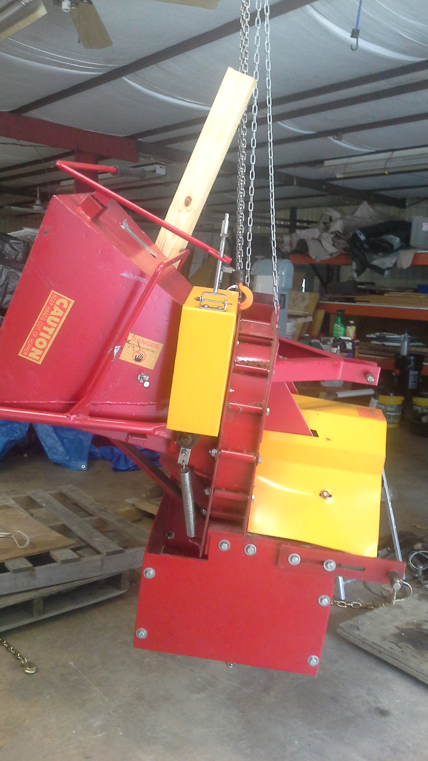

I've been planning on a similar hoist to lift things like my chipper

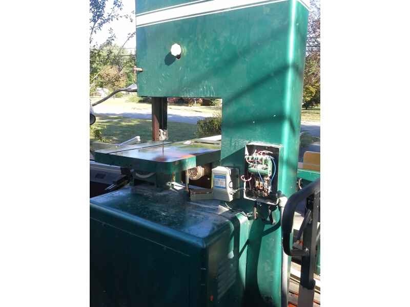

or my bandsaw

What I'll probably do is find a 15 foot I beam of sufficient strength and mount it on a pair of lally columns/jack posts I have. I'll attach the columns to uprights that are supporting the roof and beams in the roof to prevent movement.
