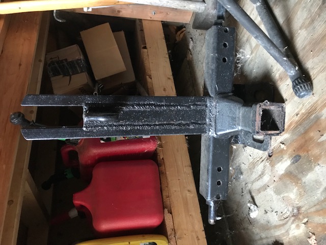

So I bought a PTO mount trailer hitch receiver. It seem that it could also be a good and fairly simple way to add weight by just buying a 2" hitch
and putting weight on it.....for example just build a box around one and fill the box with concrete and a little rebar. Then just put it into the hitch receiver when I want the ballast on the back. Think this would work..???
/ Thoughts on PTO weight attachment #2

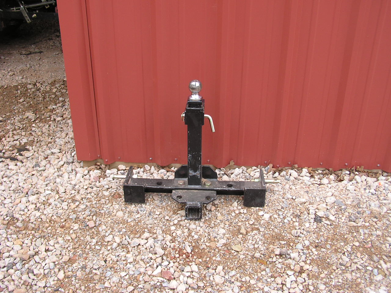

I assume you mean 3 point hitch receiver?
Look something like this? If so then yes it should work fine..

/ Thoughts on PTO weight attachment #4
I see a lot of guys that have a cement block with the male end cemented inside it and they slide it right in to the hitch..

Concrete weighs about 150 pounds per cubic foot... a 2x2x1 ft block would be 4 cu-ft or about 600 pounds....
You can work out from there how much ballast weigh you may need....

/ Thoughts on PTO weight attachment #12
One thing to consider is how much weigh is a "receiver" actually going to handle safely.... I am coming from point of stability (tilt) I think a 3PH would be more stable, as time goes by the receiver (actual box) may become bent and distorted and become sloppy and there for become hazard to tractor/work operation/operator ...
I think even with my small tractor and only anticipation a 600 pound (or so) ballast I will stay with 3PH (quick hitch) concept...
