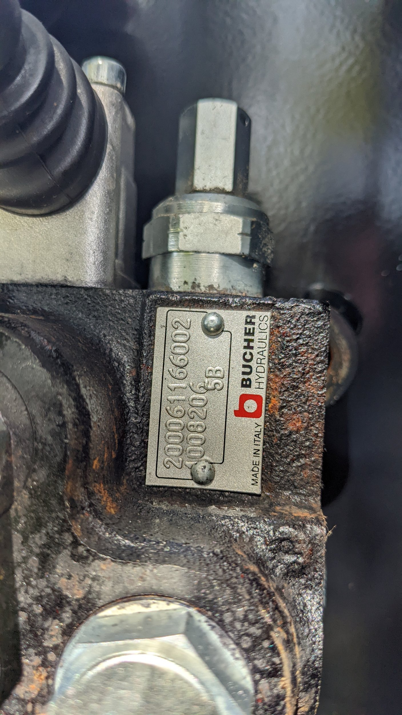

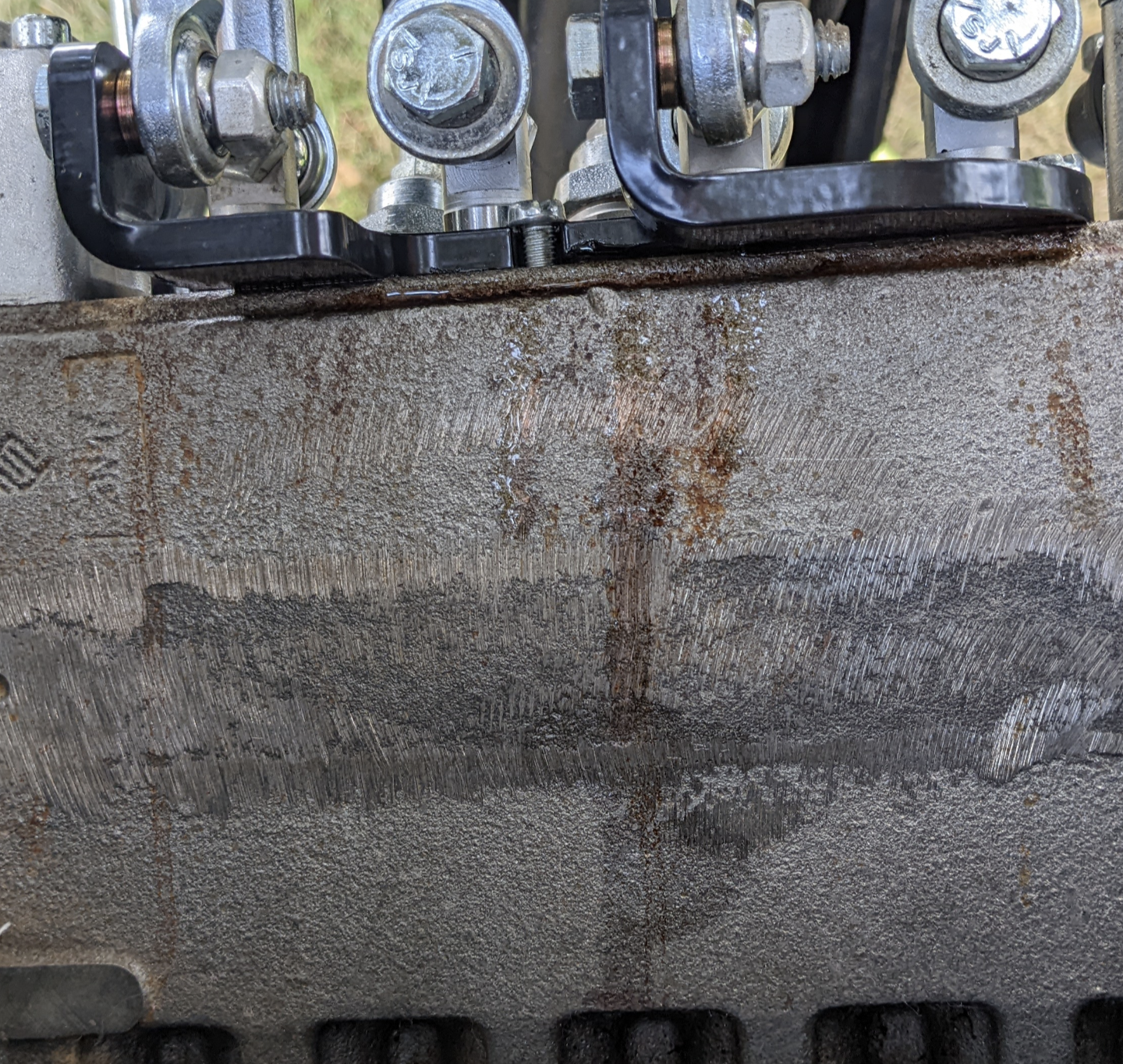

Hi MtnView,
My Bucher hydraulics have an external leak (under the black plate where the control knobs go), mounted on a Woods BH65. Woods will not supply any information. I'd be very happy to hear from you regarding replacement items.

Hi MtnView,
So you have an external leak. You need to remove the controls so that you can see and isolate exactly where the leak is.
I'm assuming that you have a monoblock valve. Go to this link and the supplier can get you a replacement part or new valve if that is what is required.
