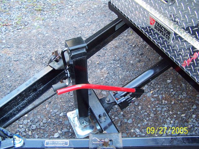

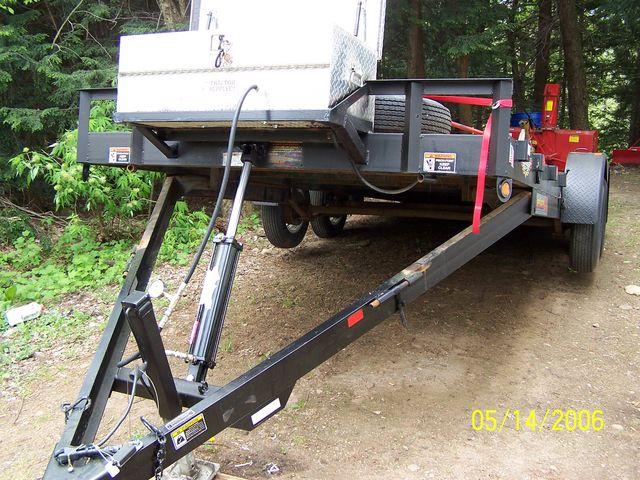

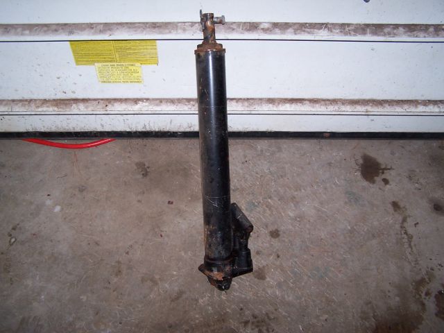

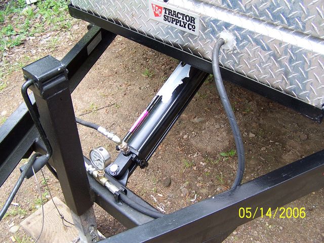

George, do you think you could post a picture of the tilting ram on your trailer. I'd like to install a manual bottle jack to tilt my trailer. I really can't get it to tilt with much less than 5000 lbs.

Joel,
I found a couple pics I posted here in the members section. The first is a pic of the manually pumped jack my trailer originally came with. The rest are the hydraulic cylinder I replaced it with. Last one is the manual cylinder. It is 26" eye to eye and has a 1" cylinder diameter. My hydraulic one is much larger diameter.
