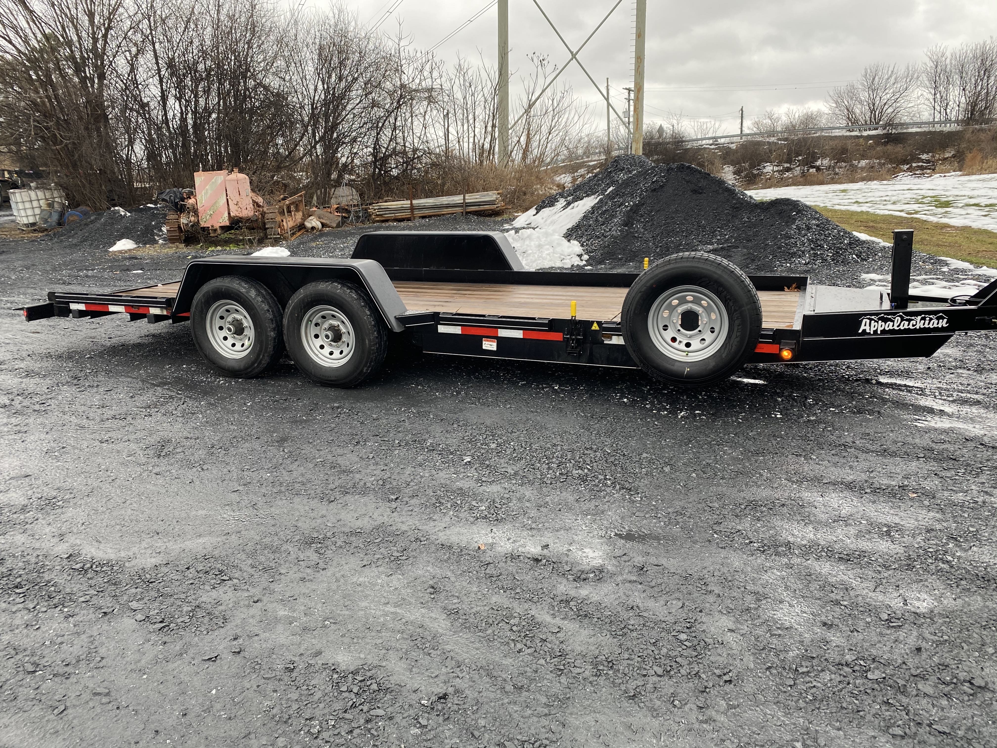

Plot twist, may have found a 1 year old Appalachian, locally. Same specs as the Kauffman for $4600.
Similar quality. My first gooseneck was a 25’ 14k Appalachian. It wasn’t a bad trailer. Neither of them are painted like they should be.

All nestled in with its little? Brother
   / Tilt trailers #24
Looks barely used.
I always look for those kinds of deals, too. Nothing like letting the first owner take the big depreciation hit.

Looks barely used.
Yes sir, only scratches are in the ramp area. He estimated it at about 2k miles of use, ended up knowing the seller too.
Pulls nice empty! I registered it at 10k, as I want to stay out of DOT number, or 17001k anyway. My usual full load, is 11-13k combo weight.
