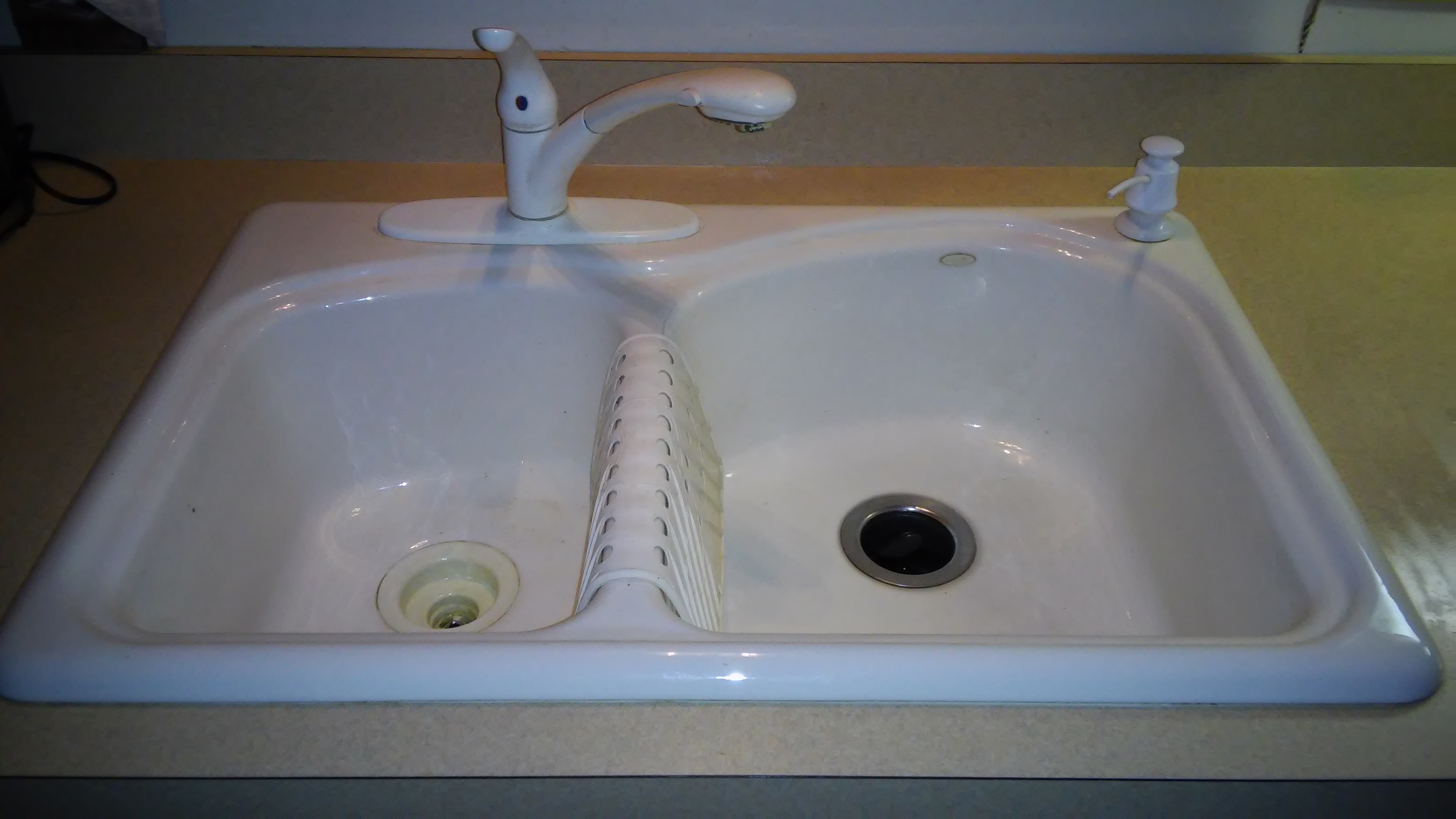

A bit late here but it's hard to go wrong with Delta or Moen if you spend at least $200+. My kitchen has a Delta pullout faucet and I have only had to rebuild it one time in 13 years...I really like the quality, BUT: My sink is one of those with a large right hand bowl and a smaller left hand bowl, and I would prefer the spout would extend further into the larger bowl area...since both the faucet and sink were special ordered I would have had to pay a restocking fee to return either....look at the attachment and you will see what I mean...hopefully it will prevent someone else from making the mistake I did.
