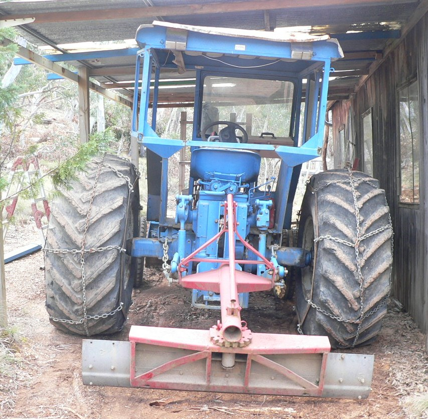

Afraid I do not agree with the Bungee cord option. You do not want a chain to come adrift while working,
Not sure if my solution on a Ford 6000 will work for you on a small garden tractor, but this system overcomes all the problems of securing everything. It consists of a steel "ring" on each side of the tire - nothing fancy, just strips bolted together into an octagon shape. The chains are attached to the rings simply by passing the chain through the bolt that is secured with a Nylock nut.
I have had this arrangement in use for several years now and it has worked perfectly. Look carefully at the picture and you will see the rings on the insides of the tires. They are duplicated by identical rings on the outside faces.

Hadn’t seen that before. Those stay on all year? Mud? Snow? Thanks for sharing.

Like Smokeydog commented above, I've not seen that before. Looks like it is not very aggressive either. One thing to note about reversing the ag tires as shown. I get it that the purpose is to allow clearance. Way back in the day growing up on the farm, we had a Ford 9N that we used for row-crop tillage. In order to properly space the wheels between the rows of crop, my dad would swap the wheels which meant the ag tire were running backwards. There was a significant loss of traction when in that configuration. Depending on how you use your tractor as well as soil/ground conditions, you may not notice that difference. Also, the chains would more than help to make up for it.
Just my 2 cents + tx!;)

you can swap side to side, it does put the valve stem to the inside also but I've never had a problem with that.
   / Tire Chains #19
Yes to all comments - the wheels were reversed mainly to gain clearance between the chains and the tractor body. The chains do provide more traction and have been sufficient to keep me out of trouble. Having the valve stem on the inside has been no big deal.
This year there has been a lot of rain but little snow during the last two winters. The chains stay on all year round because the treads are badly worn and slip on very hard shale/gravel surfaces. The cost of the chains and fabrication of the rings was nothing compared to $1500 each for new tires!
