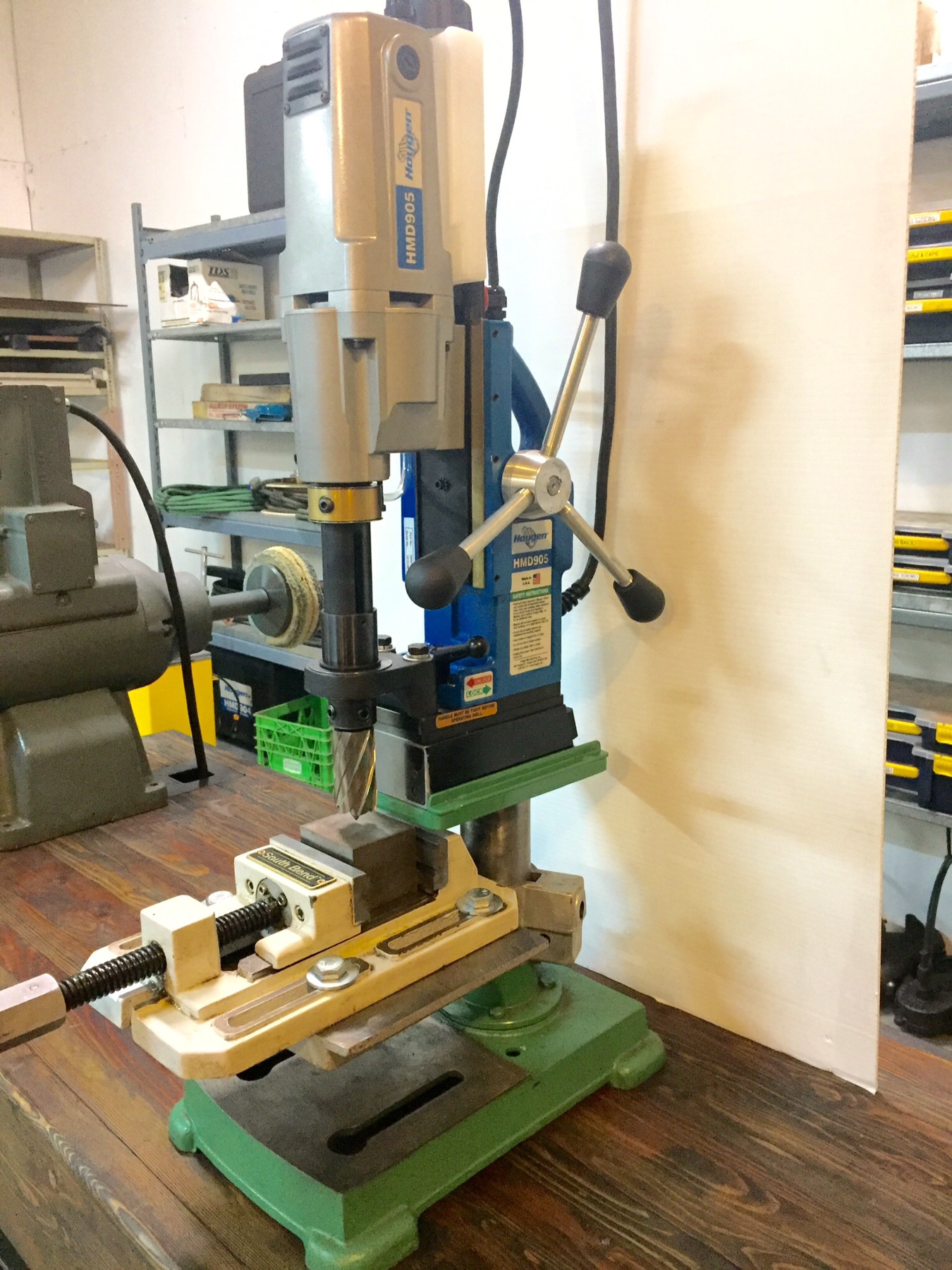

Kind of a discouraging day in the shop. Got my nuts in a vise.....
Terry
Me too.

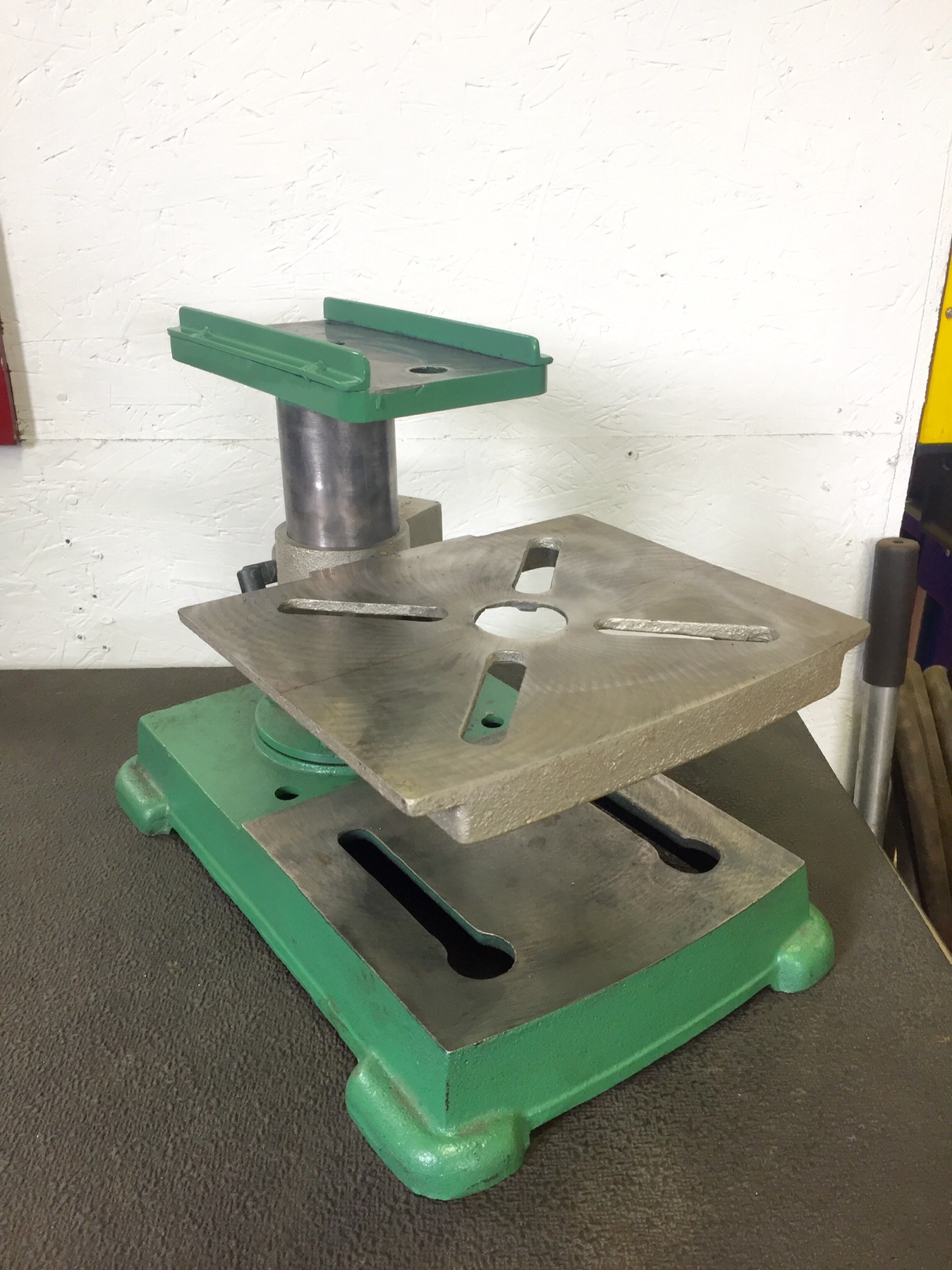

Got inspired reading Jeepnford's welding table thread over on the welding forum.
BuckitCase showed a great way to utilize a mag drill for drilling pieces without enough surface area for secure contact. I decided to use my $20 garage sale cheap import drill press for a base.
Terry
/ Todays shop time. #243
Terry
that's an impressive drill, how does it work? Almost looks like a mortising machine
/ Todays shop time. #244
daugen, in a nutshell from the Hougen website:
"A magnetic drill is a specialized portable power tool used for drilling holes in steel and similar metals. • They are used on the job site or in the shop. • Also referred to as a mag drill, portable base. drills, portable drill press."
Terry
/ Todays shop time. #245
Terry, you sly dog - looks like I'm not the ONLY one that's been busy this summer :thumbsup:
Now you know why I mentioned lookin' for a dead table model DP in that other thread :D
Yer NEXT project (if you haven't already done it) is a receiver mount for yer mag drill mount so you can MAKE the mess where you can clean it up easier (hint - a magnetic pickup of some sort can be your friend, as long as you stick to makin' holes in FERROUS materials)... Steve
/ Todays shop time. #246
That's the plan, Stan.

Can you post a picture of your mag drill/drill press setup please?

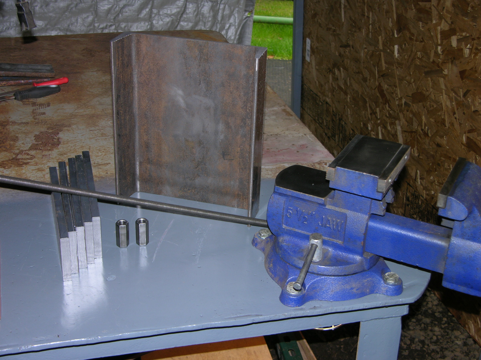

/ Todays shop time. #249
Luke, there's a few here
http://www.tractorbynet.com/forums/welding/386590-welding-table-build-6.html
and a couple on the next page; when I get more time I might start my OWN thread instead of sidetracking another one :rolleyes:
Meantime, here's a few showing the basic parts - 12" piece of 10" channel, added some pieces of FB to get more pull from the mag drill's magnets, then flattened the surface on the mill.
The vise is a Wilton reversible
Amazon.com: Wilton 145 45, Reversible Mechanics Vise-Swivel Base, 5-1/2-Inch Jaw Width, 6-Inch Jaw Opening, 3-3/4-Inch Throat Depth: Home Improvement
But any normal one would work for this - my table bolts on in place of the fixed jaw. If you want accuracy it helps if you weld the jaw piece on as perpendicular to the top surface as possible, and the 1/2" thick face lets you counter bore so those screws don't interfere.
Making the table that wide lets me use vise grips and angle scraps for "stops" when I'm making multiple pieces I want all the same (pics in JeepnFord's thread)
Any other questions I'll be glad to answer, this thing just kinda "evolved" so I probably forgot to mention a few dozen OTHER things :D ... Steve

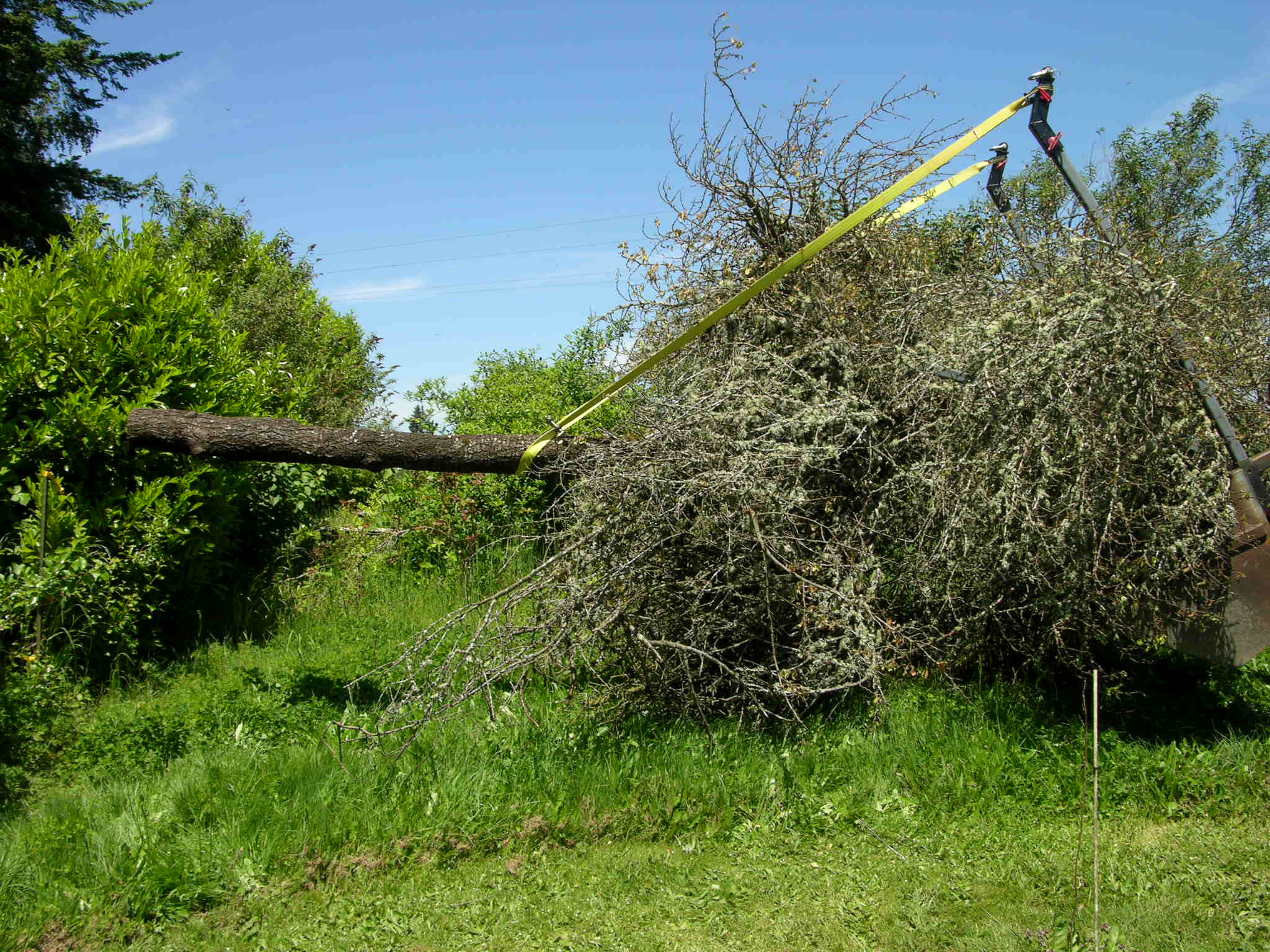

Here's some of the stuff I do with the "MDVT", I call 'em my "tinker toys" - all 2" receiver material, 1/4" wall - I buy the 2.53" tubing for females and standard 1/4" wall 2" tube for inserts. I probably have a few more than the pics show, whenever I can't come up with a combo of pieces that'll do what I need, out comes the saw/drill/welder :licking:
They all fit any/several of the 7 receivers I added to the FEL bucket on the old 580B, as well as any normal vehicle receiver if necessary - the receiver tube in the vise with a cutter in the hole doesn't show the OTHER end of that tube, which has a piece of scrap 1/2" FB clamped in it as a depth stop - so I can make any number of males at a time, and have ALL of them drilled in exactly the same distance from the end. This guarantees that ALL the pieces will fit ANY of the others, even if you flip one over.
The last couple pics are moving a downed tree (everything but the roots) - 2 of the 4' tubes (with 45* adapters) inboard act as "bale spears" to help lock the crown of the tree into the bucket, then the 2 6' tubes get a tow strap wrapped around the tree, which gives a "triangulation" for lift and stability. I moved that tree out of my neighbor's yard and about 100 yards down to my burn pile in one trip...
"A magnetic drill is a specialized portable power tool used for drilling holes in steel and similar metals. They are used on the job site or in the shop. Also referred to as a mag drill, portable base. drills, portable drill press."
Terry
I'm definitely learning something here, thanks. Never worked in a machine shop, which I regret,
so this is an electric drill designed for drilling metal only?
Could you explain what does the magnetic part have to do with drilling metal? Drive motor different? Non-sparking?
Appears to be a production (vs construction) metal drill, but why a better drill than my drill press? Am guessing this is just for bigger diameter holes on the go.
I'm sure you can pick up a Kobalt variety for 39 bucks at Lowes, right? ;)

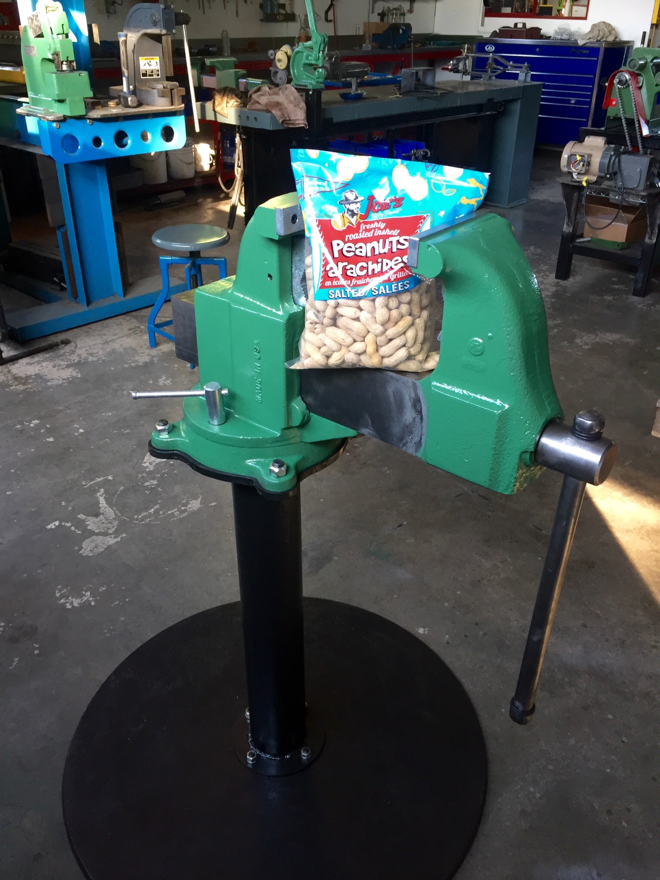

Now that I just learned how to weld, and I had to drill through some thick steel on a recent project, thankfully on a piece that I could first drill on the drill press,
slowly with cutting fluid, and weld second.
This definitely caught my eye, though it looks like something you bring home from work...
Drew

Drew, here is a relatively short "course" in mag drills, from one of the better manufacturers of them - it explains most of your questions in the first few pages.
http://www.hougen.com/downloads/Hougen_Mag_Drill_&_Annular_Cutter_Guide.pdf
They aren't cheap, starting around $5-600 for BASIC models, up to more than $2000 for some. The downside is the "price of admission", also the cutters aren't cheap - they run from maybe $25 each for smaller ones (1/2" is about the smallest) up to over $100 in the 1-1/2" to 2" range, and even more for bigger sizes. Cutters come in depth of cut from 1" up to 2" in all sizes, up to as much as 6" depth of cut in a few sizes; all you need is $$$...
I do a lot of trailer hitch tubing, so most of my cutters are 2" depth of cut. My drill has a 3" stroke, and I can "nest" a piece of 2.53" receiver tube AND a piece of 2" inside tube and drill all 4 surfaces with one setup, giving me PERFECT alignment.
The UP side - if you're drilling a LOT of holes bigger than 1/2", they make a drill press (using twist drills) look like a HAND CRANKED drill. Mine can drill a 5/8" hole in 1/4" steel in about 11 SECONDS, with NO PILOT HOLE needed. Same hole in 1/2" steel, about 16 seconds. 1 inch hole in half inch steel takes about 35-40 seconds; again, no pilot hole required, just a center punch where you want the hole.
In one of the pics I posted in JeepnFord's weld table thread, I drilled 26 1/2" holes (13 per side) 1 inch apart, in a TOTAL TIME of about 1/2 hour. Plus, those holes look like they were done on a precision milling machine.
You can also use regular twist drills in a mag drill with an adapter chuck (the standard chuck is a 3/4" Weldon chuck - it's like a 3/4" collet for a mill, but with two flats for set screws instead of one.
For thinner metal, the "price of admission" is LOT lower - you can get sets of cutters that will work fine with a hand-held drill (the bigger deeper ones tend to SNAP if you side-load them while drilling, so they need a VERY rigid support - even a basic drill press may have problems with cutter breakage.
The "sheet metal" type of cutters are good up to 1/4" or 1/2" thick depending on the set - I've used this set a few times, has most of the advantage of annular cutters WITHOUT the need for the mag drill -
Blair 119 Rotobroach Cutter Kit Hole Saw Kit - Hole Saw Sets - Amazon.com
Blair (and others) offer other sets that go bigger in size, but generally NOT thicker than 1/2", some are only 1/4".
HTH... Steve

Since this is shop talk, I'm going to give myself a safety lecture before one of you give it to me, rightfully. No, there was no C clamp holding that
little vice down. I realized when I was done if it had caught it could have whipped around and been very dangerous. It never moved a bit, surface had some grip, but
overall it was a really stupid thing to do. Secure your workplace before it visits you in the eyes...:ashamed:
At least I had good safety goggles on. But my head isn't that hard.
/ Todays shop time. #256
Thanks for that, Drew. Although it only takes a few seconds to secure with a clamp I am often guilty of neglect.
I use your setup as pictured frequently. It's probably the safest no clamping setup for small diameter holes. Since the drill turns CLOCKWISE you can hold the "leveraged" end of the vise with your left hand and operate quill downfeed with your right.
And that's my "holier than thou" advise for today.....
Terry
/ Todays shop time. #257
which is exactly what I did. The vice is pretty heavy for its size but I know how my wrist feels when a bit catches in heavy metal and tries to twist the drill
out of your hands. Which is why a drill press is nice.
After reading all the info I now understand this is a very high quality drill whose only magnetic qualities is in the base to stick to the metal being drilled.
I get it. And boy are those cutters cool looking. Plus I learned you can make drilling in stainless worse if you don't go fast enough.
