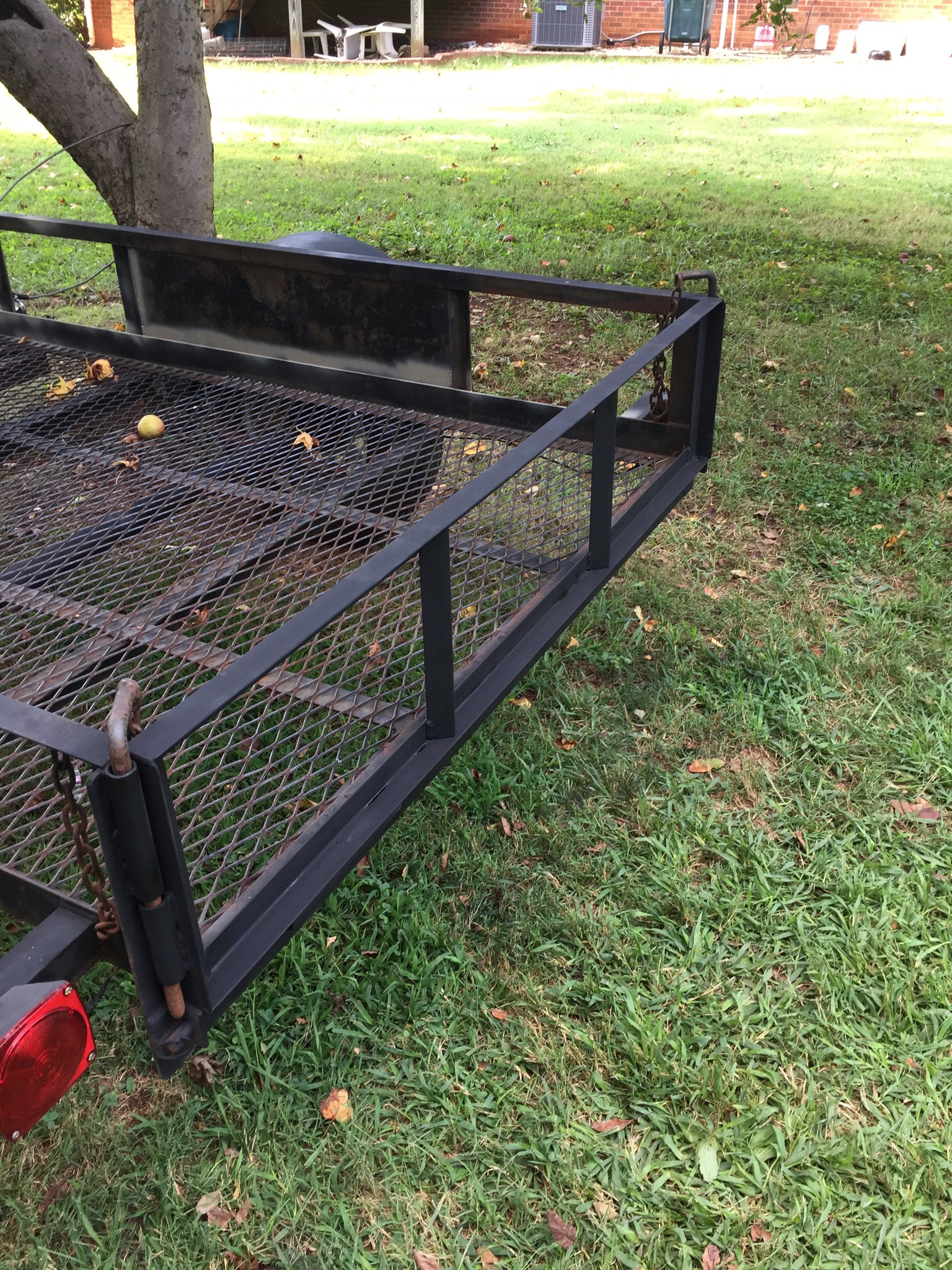

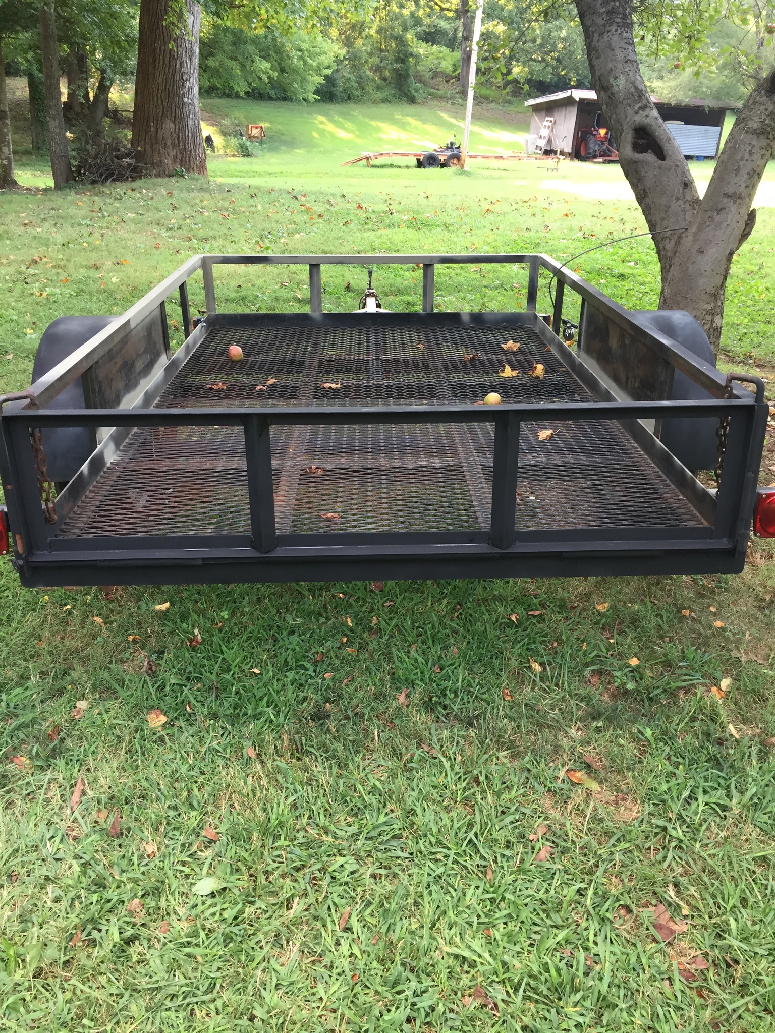

I've been wanting to do some maintenance on my 5x8 trailer so today I started by building a short tailgate and took off the 4 foot ramp. I still plan to paint the whole trailer, add about 10 light duty d-rings in various locations and wire a new plug.
The shorter tailgate should make the trailer a little more handy when pulling it with the 4-wheeler, loading or unloading lumber, brush and other stuff.
I hated working around that tall ramp when trying to haul things other than my Grasshopper.

   / Today's Welding time! #44
I don't know how easy it would be to modify that tailgate but the one on my little 4x8 is the best design I've seen: The tailgate has two pins that go down at 45 degrees to drop into similar openings on the back of the chassis. So the tailgate can be installed vertical, or turned over and installed horizontal to extend the deck length.
