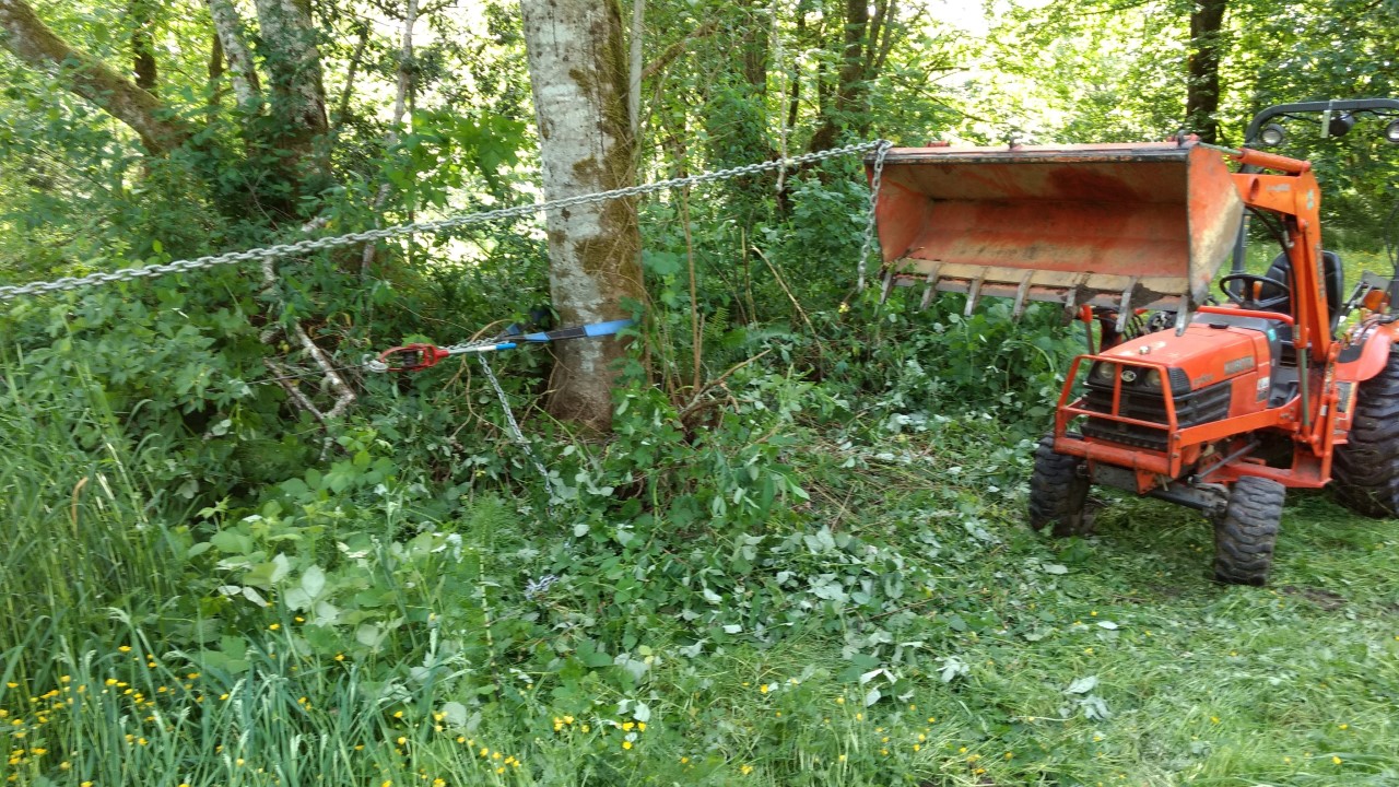

I got a tooth bar from my Kubota dealer for my B7800.
I've torn through some nasty stuff with that. LOTS of back-dragging: literally raising the front end up in the air! (yes, NOT recommended, but the B7800 is indestructible- not kidding) Only popped it off once and that was spinning a massive tree trunk by one of the end teeth: I bent the bar, had to beat the snot out of it with a big sledge to straighten it back out (been a long time since then). I highly doubt that anything else could have begun to handle the abuse that I've put this bar through.
Oh yeah, the picture is a rescue of my trapped Kioti, which was pinned in a dead end by a dump trailer that was sliding off into the abyss. Payback from the Kubota for the Kioti having rescued it from a deep stuck.
