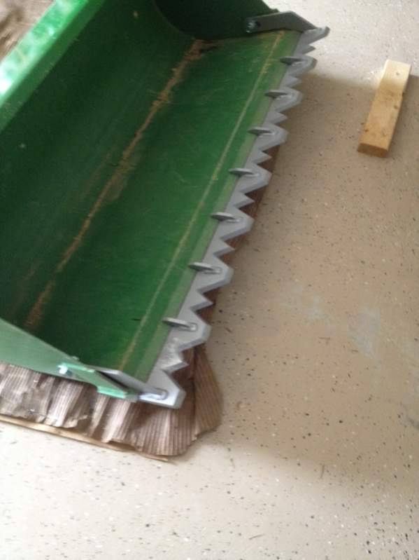

image-2733911584.jpg They're pretty good at digging
But better clearing brush & saplings. Either cuts them right off, or pulls out by the roots

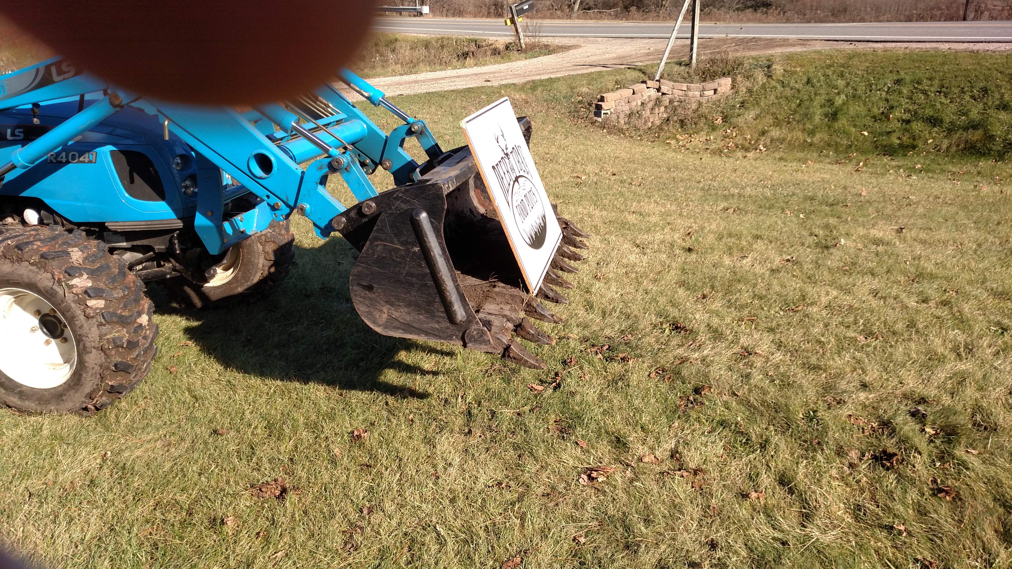

titan tooth bar has been shipped should be hear thurs fri have updates this weekend, im pushing with 41hp LS at72'' wide

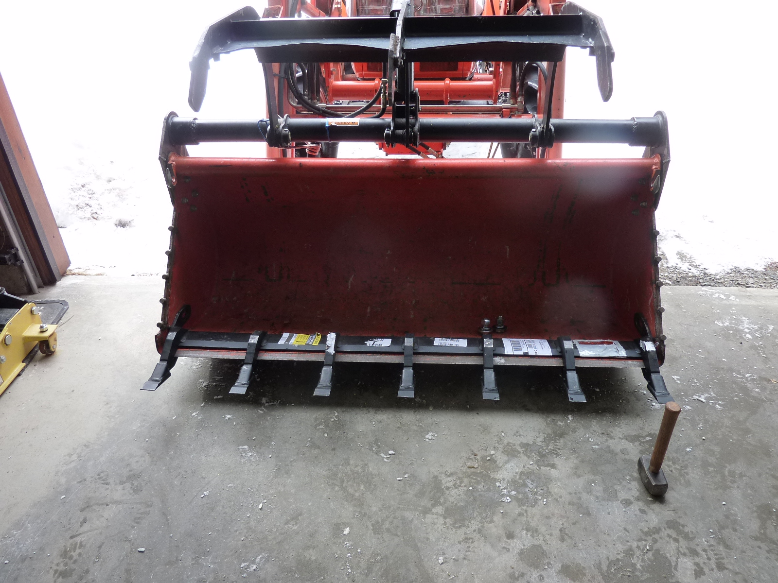

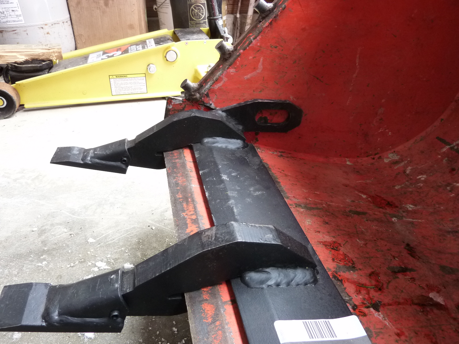

titan toothbar shipping was fast 3days was a tight fit as in sledg hammer tight but my bucket has a slite bow in it
tried digging a ditch not a back hoe but much better digging and cleared some brush worked great picking out small
stumps happy so far glad I bought the titan bar was must economicaly priced of all bars looked at and could easly spend
a hundered bucks more and had the same thing GOOD WORK TITAN

The Titian looks much better than BxPanded at digging hard clay/ dirt. I guess there's a trade off though. The piranha is excellent at clearing brush and small trees.
