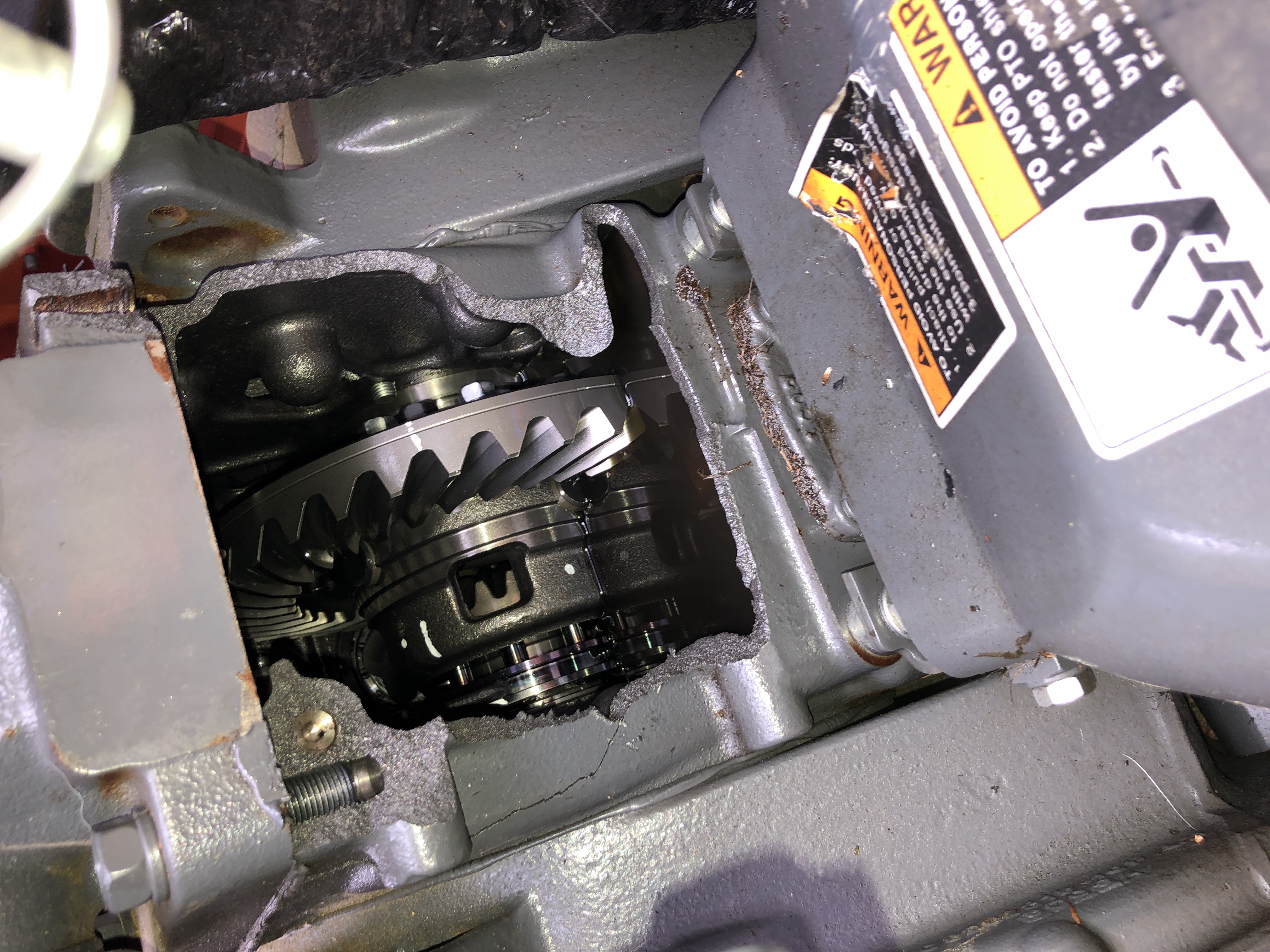

Here it is. In this diagram it's shown better and offers the part # TC620-99013, cost for that casting is $1257.56.

This is what the gaping hole looks like: IMG_4586.JPG
   / Top link mount tore off back of differential case #13
Oh wow..... Forget everything I posted. You also need the rear axle housing along with the top case........ Double Bummer......
This is going to turn into a $5,000 repair minimum. Will require many shop hours. I'll see if I can find the cost of the axle housing.

This parts diagram shows the trans/rear axle case. Item # 150. Part #TC620-50420, cost $919.51.
This requires disassembly of the entire rear axle assembly. Adding many more hours of shop time. Bummer.
