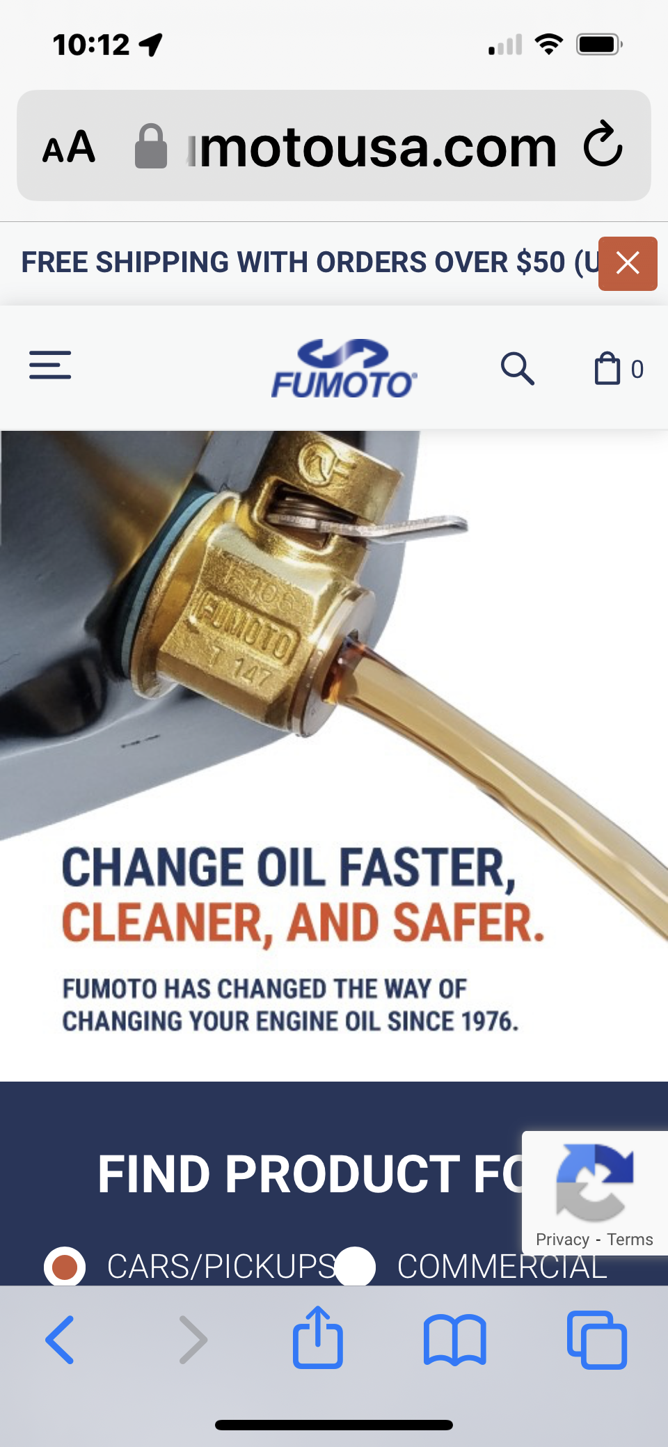

Why not put on a drain valve , only once do you need to remove the drain plug then install the new valve. I have these on all my vehicles, quick oil changes with no tools.

As far as having to replace a big part if you strip the threads, is there not enough metal there to put a heli-coil in if needed? Would seem to be a fairly simple solution. The drain valve is a great idea, if they NEVER leak.. but I wonder if they get hit by flying gravel or a tree branch, whatever, might happen..

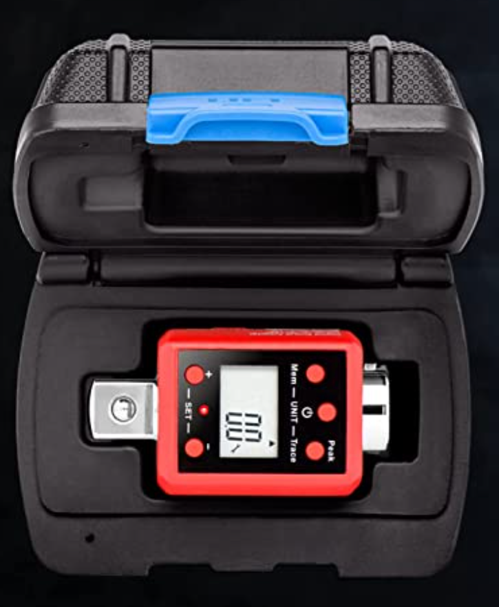

This is what I use. It allows me to use a breaker bar of whatever length I need and doesn't take up much room. It's around $80 on Bezo'sMart.
