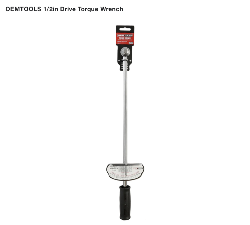

I rarely use a torque wrench. All they do is measure resistance to turning, and that is too often affected by things like thread wear, different materials - steel bolt into an aluminum pan, type of washer - or not, type of lube or not, dirt, and wrench angle.
There comes a time for old mechanics when they have tightened enough bolts to prefer to trust their own feel. Sometimes I check it with a torque wrench if doing something where it needs to be very even. Head bolts. rod nuts. clutch plates. Not single bolts.
It would be different in laboratory controlled conditions, or for someone just learning. For those times or for mine above, I use & recommend a simple inexpensive beam & pointer torque wrench. It never needs adjustment because it can't be wrong, it reads ft and inch pounds or metric all on the same scale, and can be bought in the 20 dollar range..
rScotty

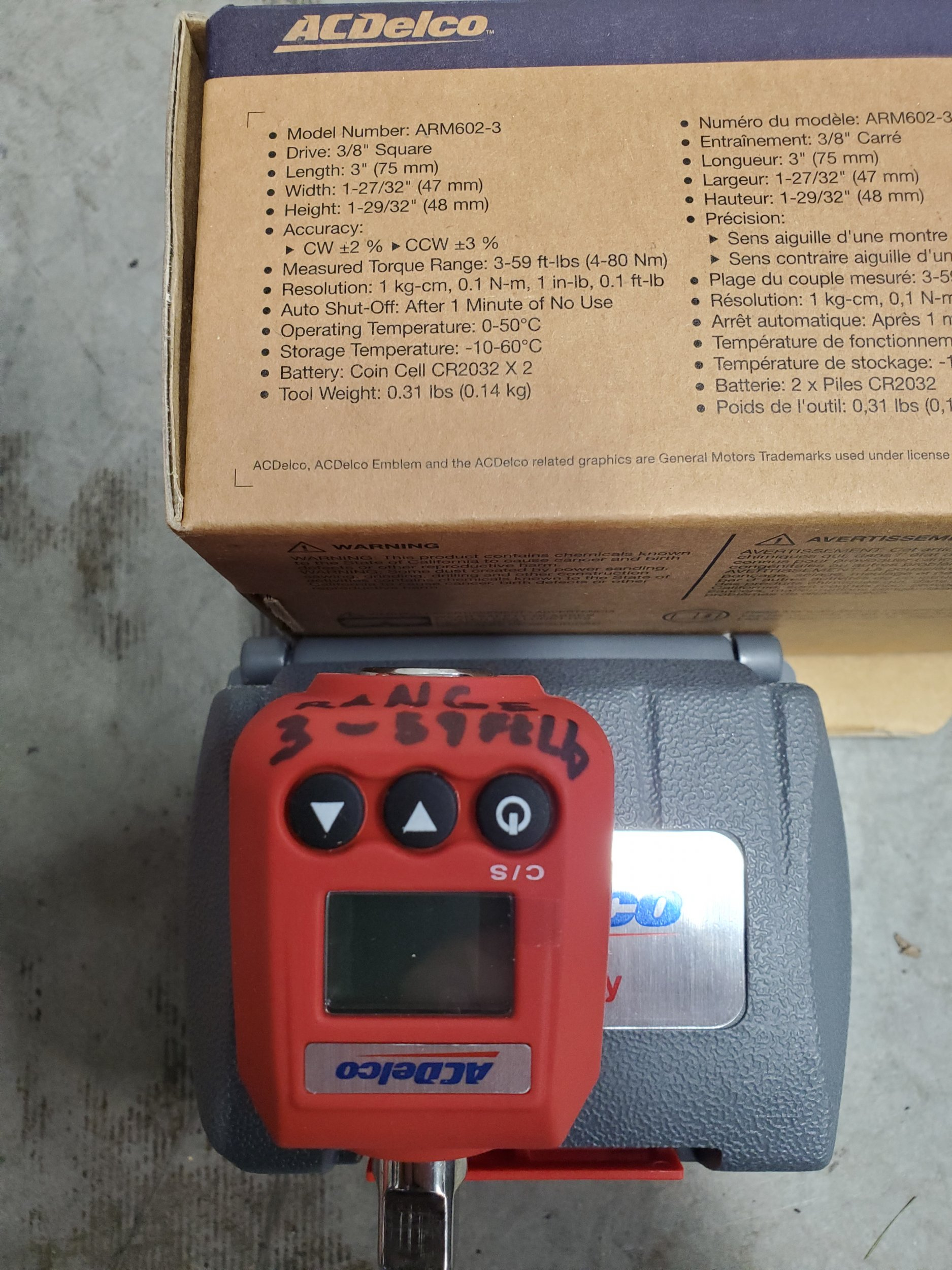

Perhaps the below is of interest. These come in 1/2" and 3/8" drive and turn anything into a torque wrench. I have one of each and use them when standard "long arm"/ beam torque wrench won't fit into space such as wheel well when torquing brake caliper holder and for verifying whether or not standard torque wrench is still in spec. Comes with NIST calibration. I remove batteries when not in use. Beeps when torque reached and displays highest torque after torque finished. The 3/8" has min torque of 3 foot pounds or 36 inch pounds which is way lower than your oil plug spec.

Beam wrenches are great if they are useable in your application and great quality ones can be found on ebay. I would use and own nothing but if I could do without ratcheting function and length issues. Never having to pay to have serviced or calibrated or do without while they are out for repair is a big plus.
