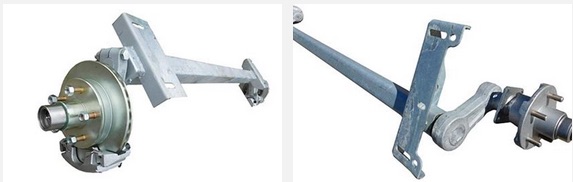

All I've examined (not a lot) have had the trailing arm welded to the part that rotates in the rubber. But adjustable angle axles are out there.
Here is an example of a clamped and welded arm.
Adjustable:
3,500 Lb. Adjustable Trailer Torsion Axles | Northern Tool + Equipment
