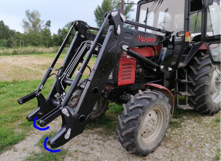

Good picture of the self leveling linkage on the loader arms :thumbsup::
   / Tractor backhoe - homemade
#1,282
Well, I will not build my own tractor, I'm happy with this one.
Yup, here you can see the whole geometry. FL is almost done, I hope to paint it in a few days...
   / Tractor backhoe - homemade #1,283
Almost seems like your FEL is closer to the front tires then most tractors with FEL, good for digging but will loose in reach.
#1,284
You're right it's 25 cm closer then the previous one and also 12 cm lower main pivot point. This way I get lower center of gravity and better control of the bucket

Finally I found the time to clean up the loader and paint it...so here it is in primer.
   / Tractor backhoe - homemade #1,287
Good to see you have it nearly done. Looks heavy duty.
How have you been doing? Has the virus been horrible over there?
#1,288
Arm profiles are high but not very thick, only 6 mm so it's not really heavy but has to withstand all the loads with no sweat.

Painting is done, now I have to wait 2 days till it's dry enough for assembly

Final assembly...
   / Tractor backhoe - homemade #1,296
Looking good, that quick attachment mount seems to look different than most I've seen.
#1,297
When it's done there will be videos. Which mount? You mean tractor console?
