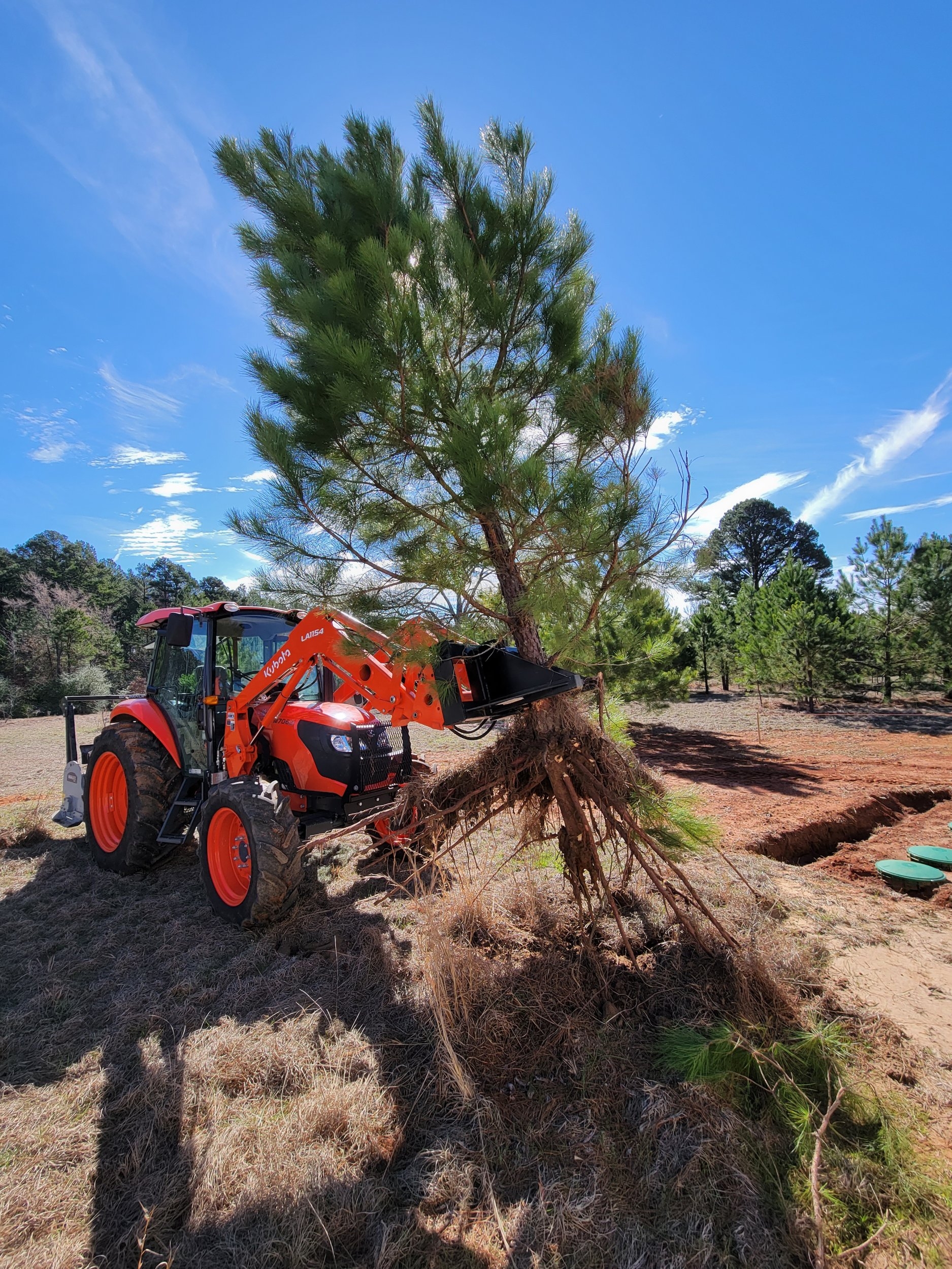

I bought a post puller from titan. It is hydraulic and on my little kubota— 1-2 inch trees pop out easily.
I pulled all this stuff out and dropped near by the pulled location then used a grapple to stack.. some I pushed over and a couple I had to cut.
