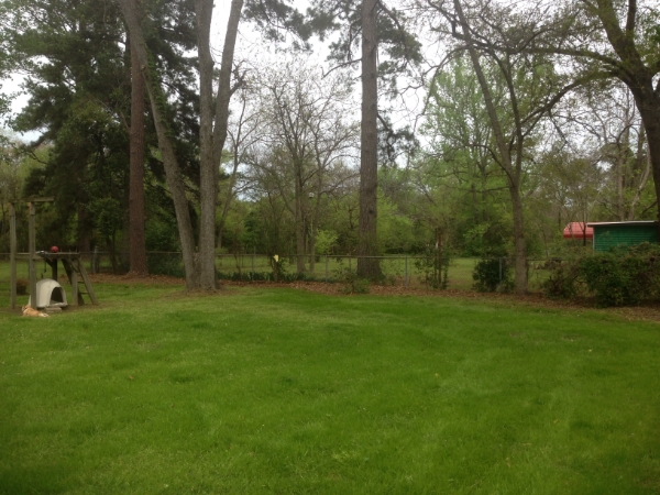

I remeasured carport and it's actually 86". Tractor with fold down rops would work but L39 is 96". So I measured the side yard and iv'e got 100" of width but would have to remove brick planter, a few small trees, change out gate, and drive through front yard :eek:. The best solution might be to use my neighbors driveway, through their backyard, and straight to my back lot. My backlot wraps behind their backyard.
Or go with a regular tractor....
Buy a new carpot that L39 L45 will go under.

New carport is on my list. Will be using tractor to help build enclosed shop in backyard to store equipment behind lock and key, so if can find way around carport in the meantime would rather spend money now on shop. Carport later
Man i shouldn't have ever posted on this site. I originally was going with 3000 series tractor with BH attachment that would easily fit under carport. Now am considering spending 10k more on tractor and tearing down carport to get bigger tractor in backyard :)
