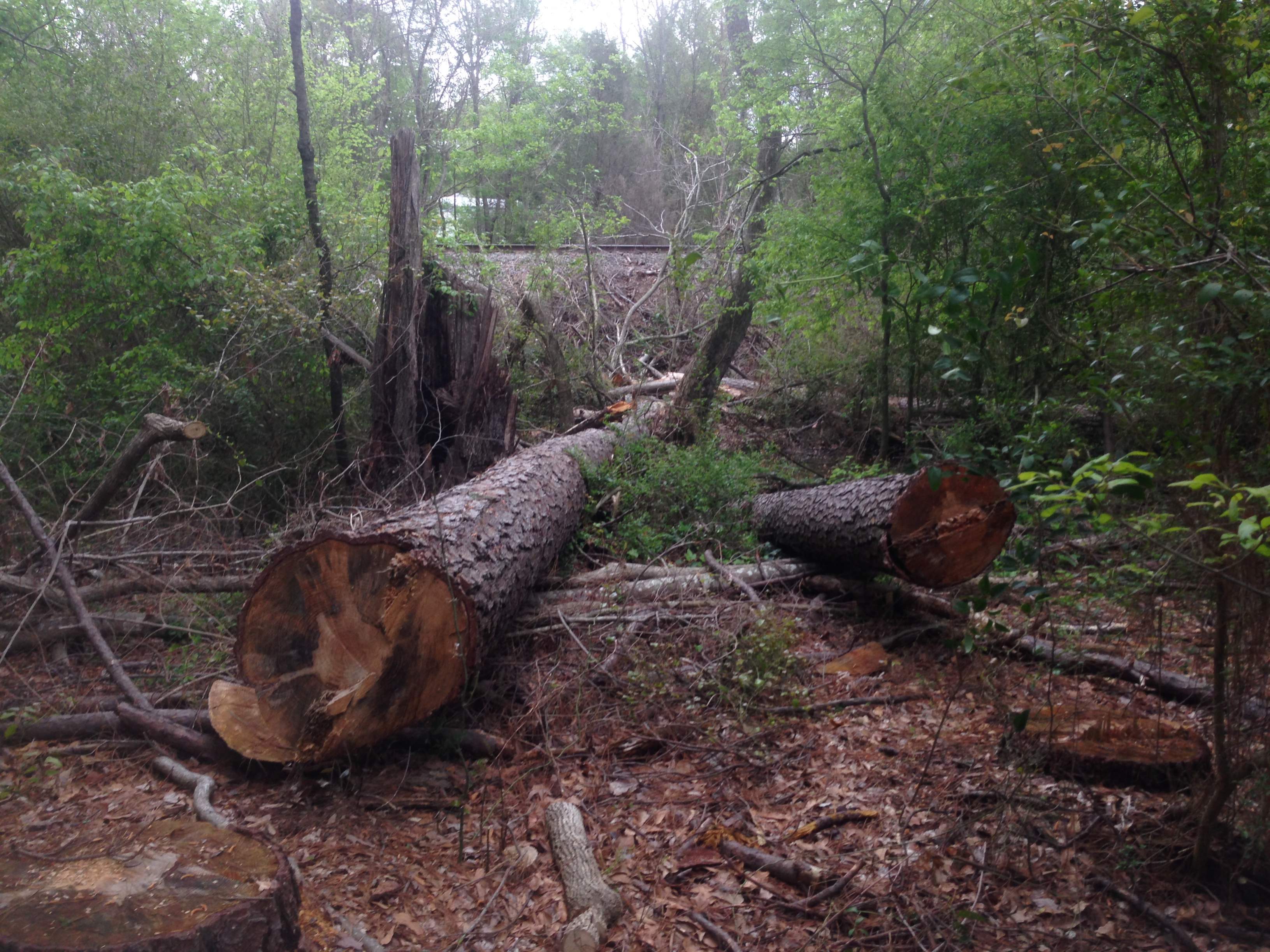

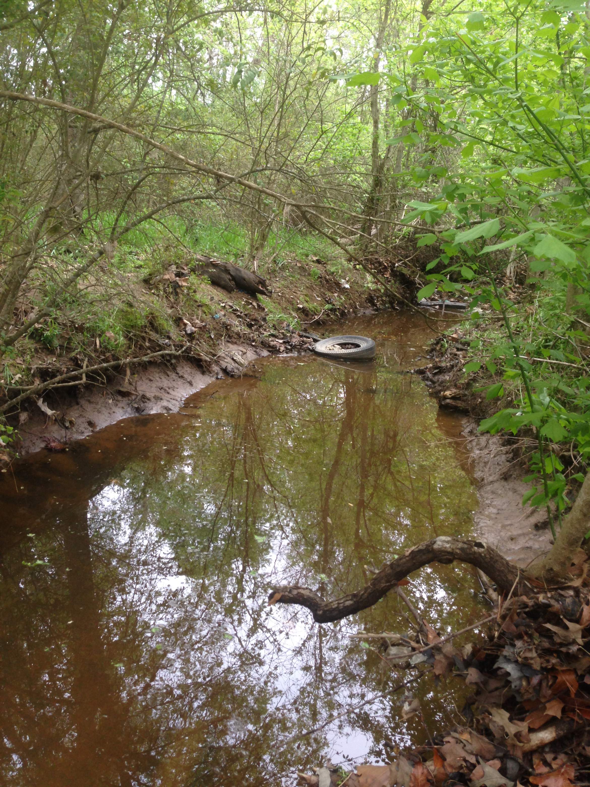

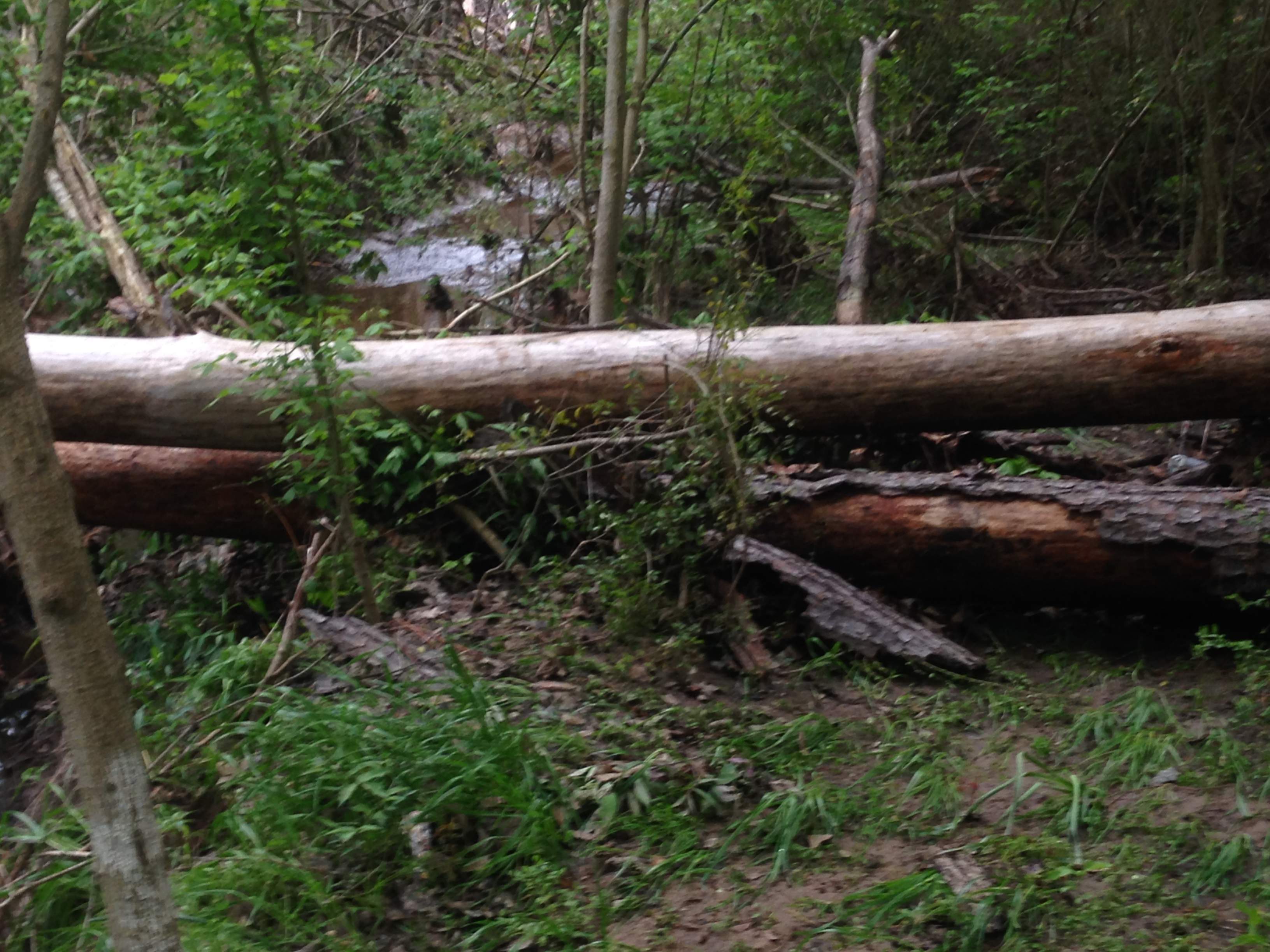

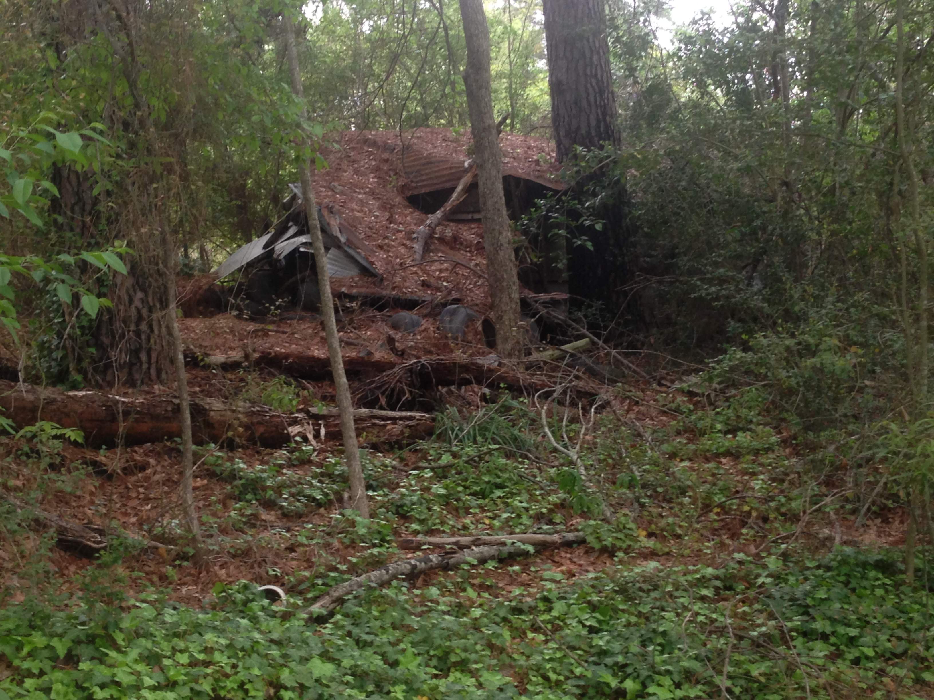

Test drove a new M59 today. It was nice. It was basically stock and around $52k. They are getting an L45 in in a week or two. Stock was $44k. Asked, salesman if I bought m59 today what would he take off. Said $1000. I said i would wait and look at L45. A couple of other dealers are getting quotes for me also. There's a rental yard not far with an m59 i could rent for one day for $140. If dealer won't let me demo i might rent the one i think i'll get to make sure it will work for me.
I thought I would have to hire out this cleanup to a dozer which i'm sure would be the best route, but could the M59 handle this with a grapple bucket and thumb? 6 acres with downed trees, metal, and trash. Was bush hogged 4 years ago.

Once you figure out what tractor you want get prices at 3-4 dealers to see who has the best deal. The bucket on that M59 is huge!
I would clean that up with my L4240.

You can do that clean up but it will take some time to do. Glad you had the chance to see an M59 too, but don't buy one without the extras mentioned above.
