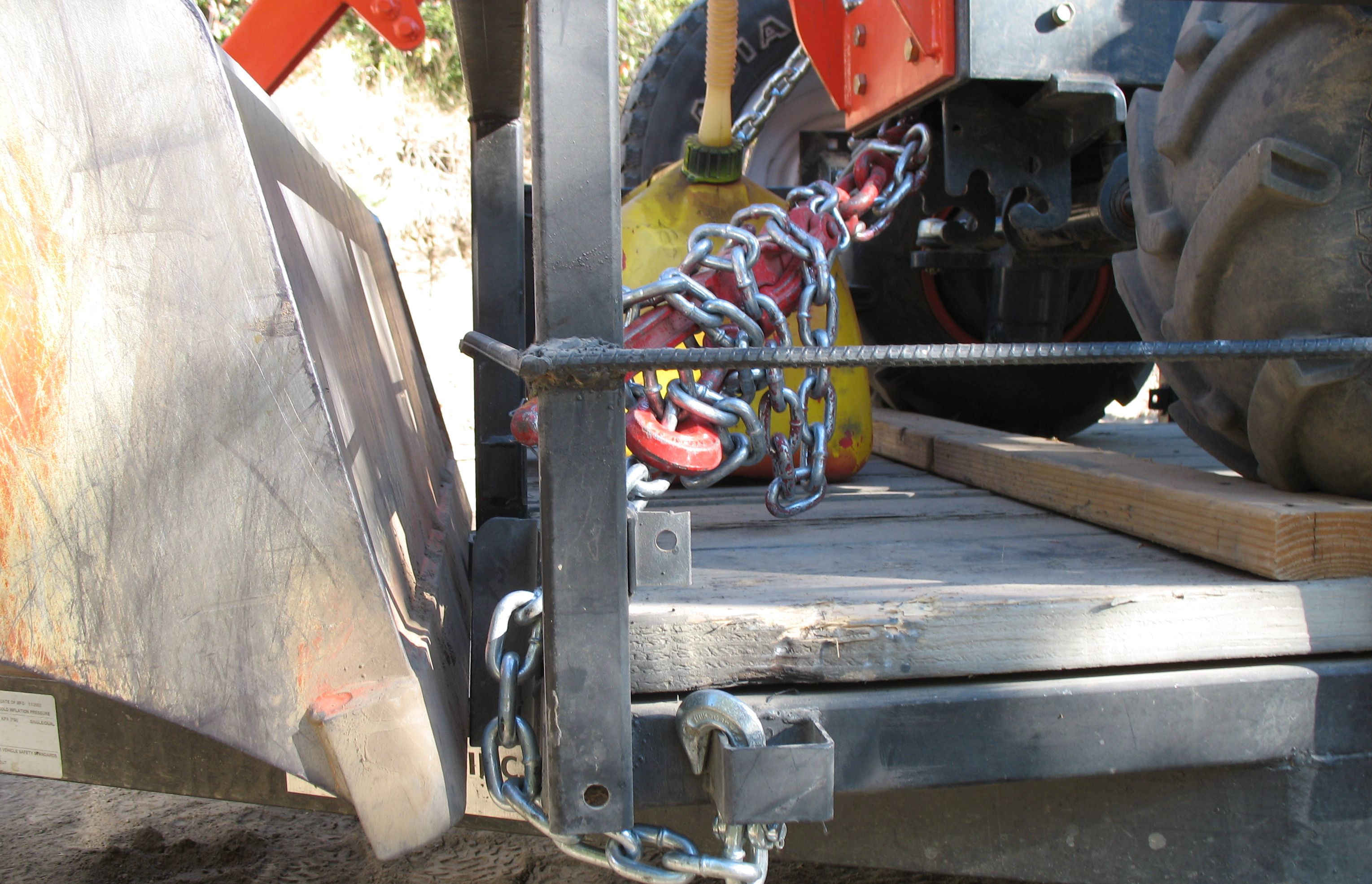

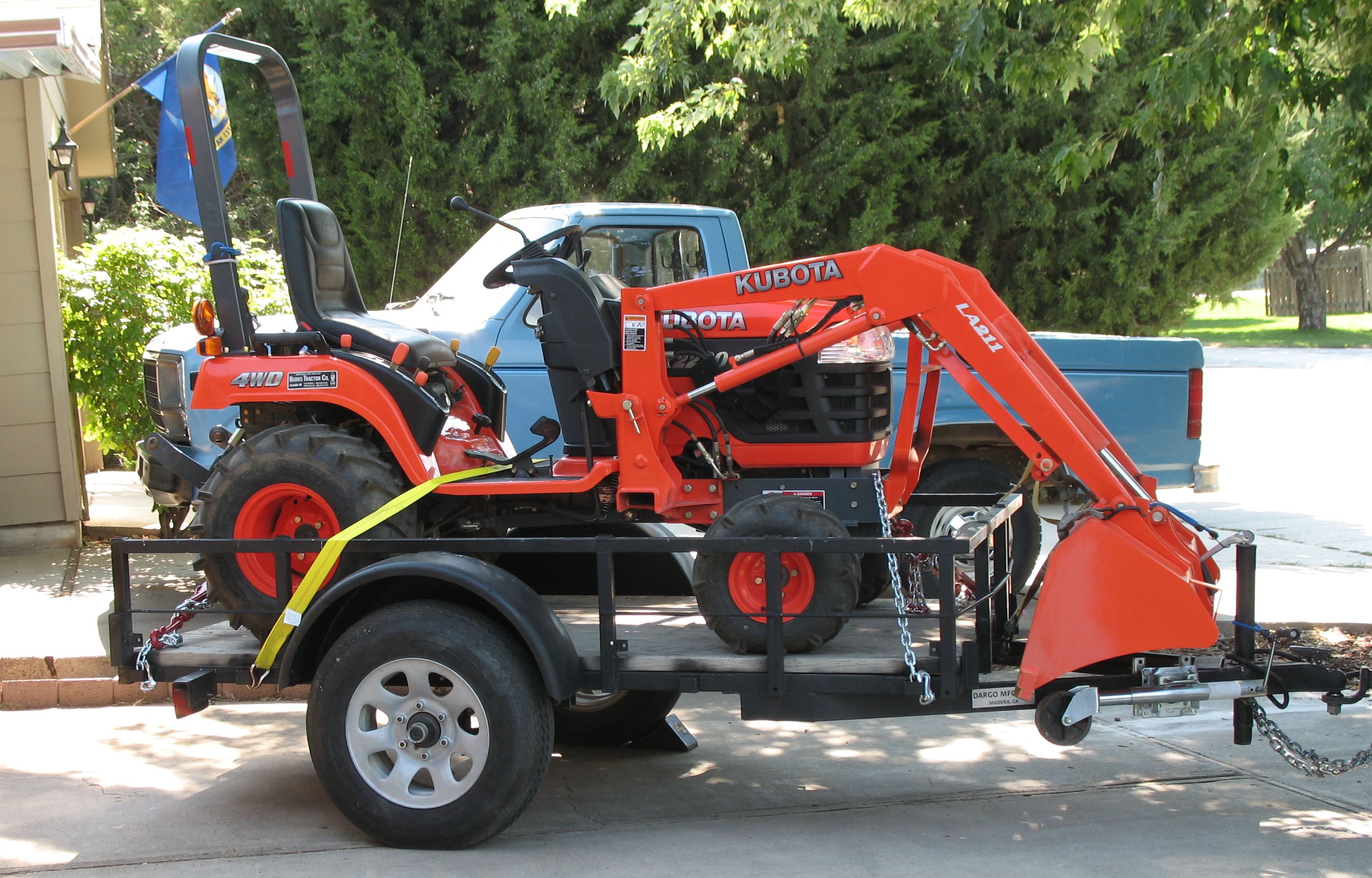

I think it's important to distinguish exactly the type of equipment is being towed and the circumstances under which it needs to be towed. I would agree that a BX23 with BH and FEL is too much for the small trailer, but a 2230 without those implements is most likely fine -- given the correct tongue weight and driving characteristics. For me, I'll be towing my BX2350 on a similar trailer (Car-mate 5x8, rated for 2990lbs) without a BH and perhaps only occasionally with the FEL -- and only on an infrequent basis. In that case, it will be just fine. It's just not practical for many people to own a tandem axle 16' trailer. For much longer distances, or if I was transporting the machine on a daily basis, I would certainly rent or buy a larger trailer.
The important thing is to not exceed the rated capacities for the trailer or the tow vehicle and to recognize when it's better or more practical to utilize more substantial tow equipment.
Just my $.02.

I actually took my trailer by a trailer manufacturer and had them look at it while I was there to get some ramps. From a weight standpoint, they said it would easily do it since I was at about 1/2 the rated weight. He said people haul 2 or 3 heavy ATVs on his single axle trailers all the time without incident. Then he looked at how the trailer was made and said that the square beam construction also added to its strength. Yes of course he agreed that a bigger trailer would be "better" but that is relative.
I consider myself a rather safe person who does not like to take risks. But that does not keep me from driving my Jeep Wrangler at 75mph on the freeway from time to time. If one front tire were to blow out, it could flip me over. I realize this is similar for single axle trailers.
If I were hauling this tractor all over Houston or Seattle etc, I would not be using the smallest trailer possible. I'll have to snap a picture the next time I am driving up at my remote cabin and fording that creek with the steep banks so you can see the reasoning for my decision.
If anyone has a better idea if how I can get my tractor back there, I would be all ears. Leaving it home is not an option. I have too much road work and maintenance to do up there.

I thought I would share how I transport my Kubota BX2230. I have a 3500# axle trailer and it is rated to carry 2990#. I figure the tractor and loader weight in at about 1700# so I have some extra capacity on it. It does not cause problems turning rather sharp corners with the loader on the trailer tongue and the whole package pulls real easy at 55mph.

It would also be better if fabrej had an 18 wheeler with a flatbed trailer?!?!?
As long as he is within weight limits it looks fine to me. Fabrej seems well aware of his circumstances and capabilities.
