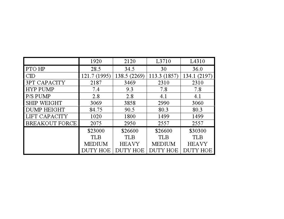

Mike this is what I did 2 cuople of years a ago. Not very fancy but I could "see it" better.

Comparing apples to apples is the issue. For example, it is rumored that Kubota lists their weights as the crated shipping weight---no tires or fluids---and JD lists theirs as field ready with tires and fluids. That could make a substantial difference.
Muhammad, have you ever been able to verify if that is how Kubota weights are reported? I know we have had a number of discussions about it in the past.

Mark,
I was able to get an answer from someone at Kubota on this issue, again...
The weights published in the literature are basically shipping weights... no tires, ROPS, fluids, fuel, or ballast. In some cases, I guess the ROPS is added... B2710 specs mention "weight with ROPS."
I was also told that Kubota's product guides provide dealers with a field ready figure, which includes front bumper weights, one set of rear wheel weights, wheels/tires, ROPS, and tire fluid.
For our specifications, I can't say whether or not we'll have field ready figures for Kubotas... maybe just a lot of asterisks. /w3tcompact/icons/wink.gif
