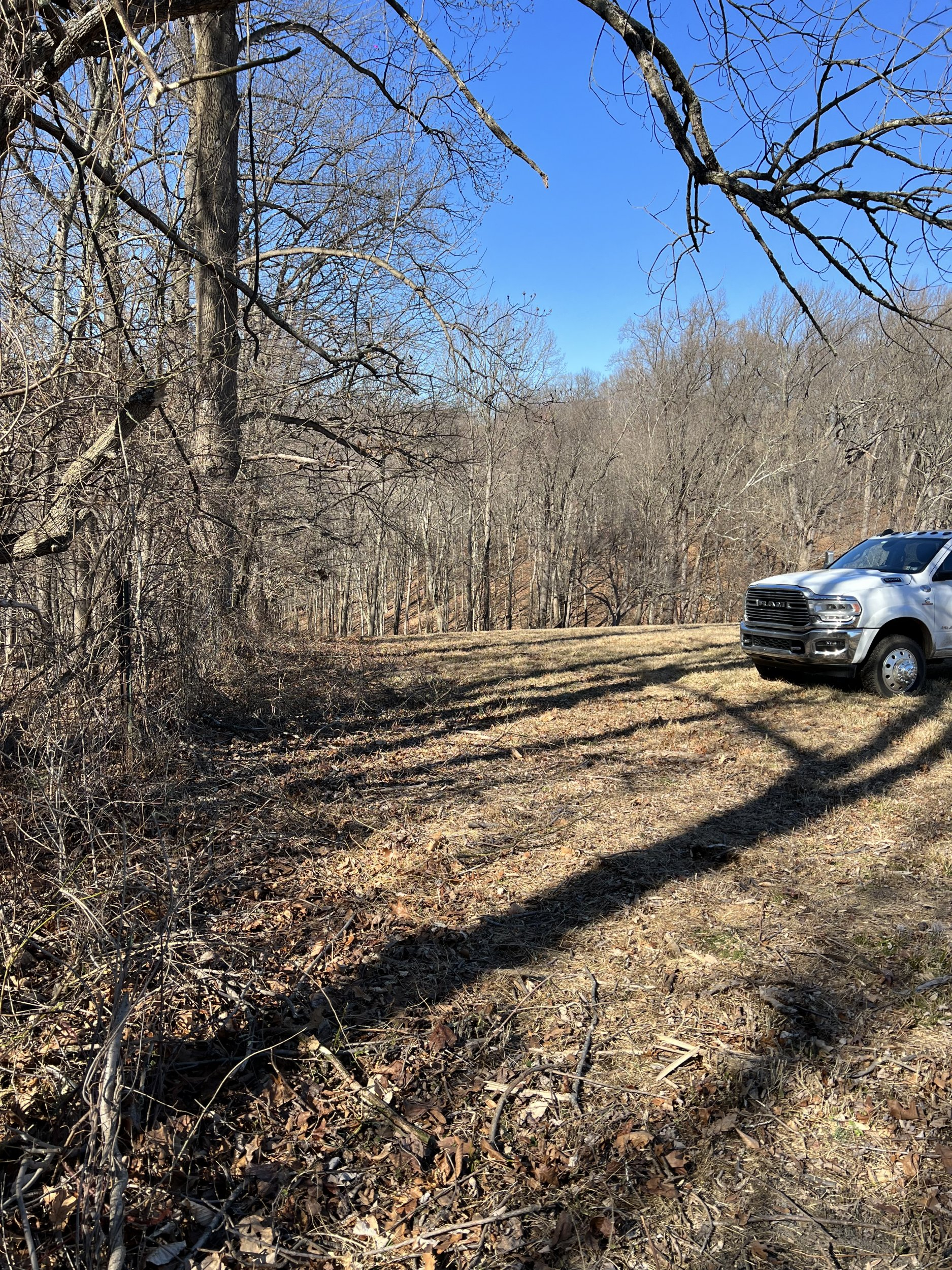

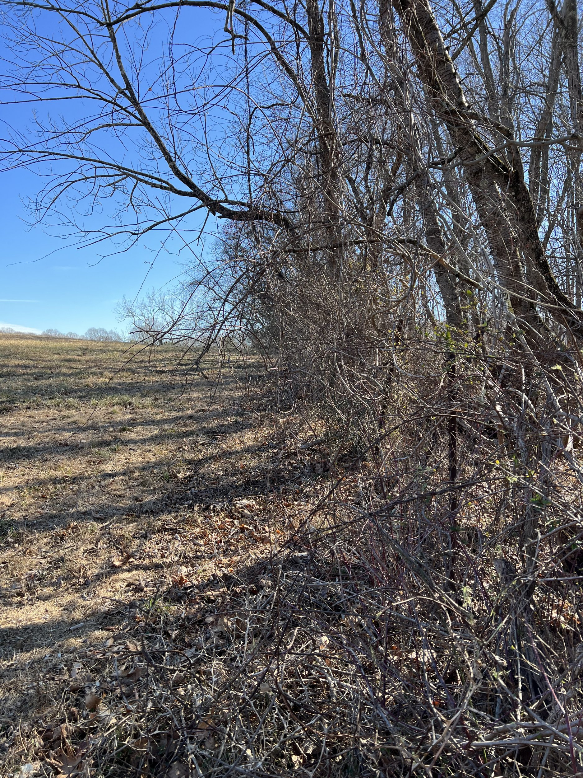

Back to the topic of clearing (I think thats the topic). We cleared brush Monday & Tuesday along fence lines. The techniques we used were mostly our Stihl 131 with pole saw for cutting brush along the fences and tree limbs that were difficult to reach. Only key word missing here is trail, although the customer does like to walk the fence line somewhat like a trail. We do clearing work all winter, so this is just a typical day for us.
Here’s a few pictures.
I will get some pictures after work is completed.
