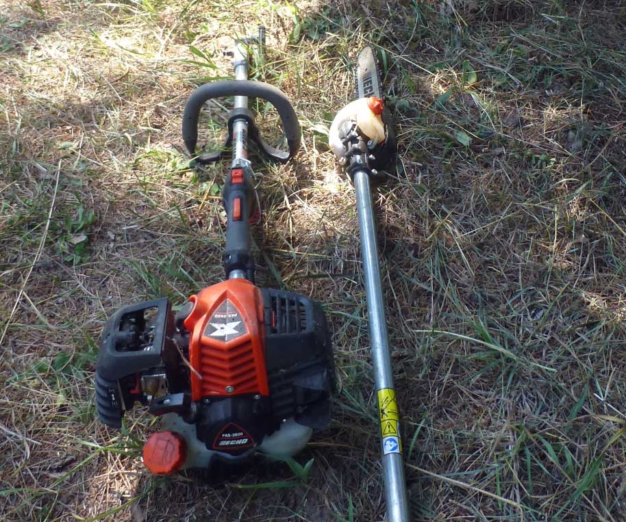

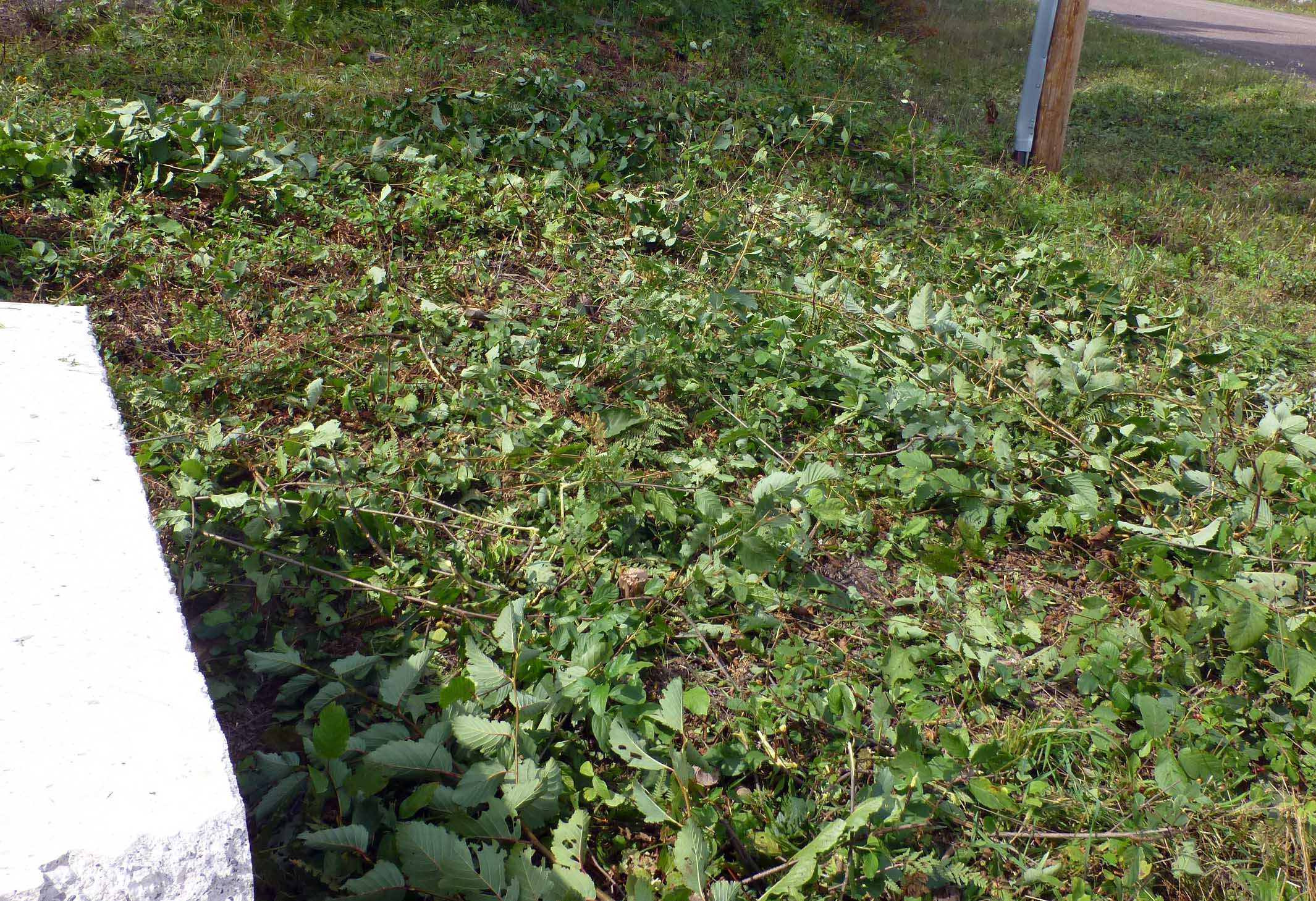

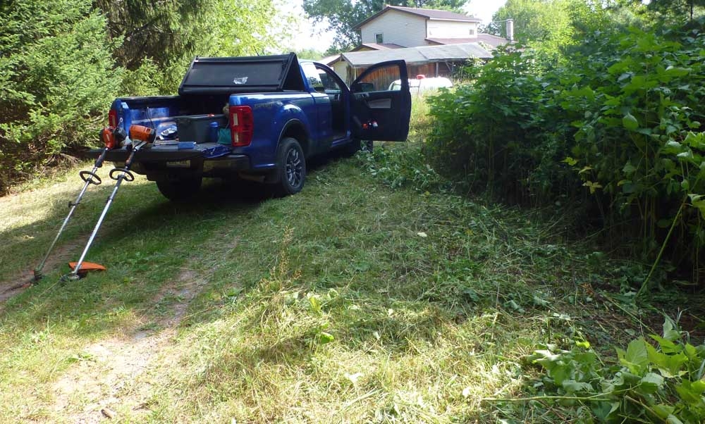

Worked at our elderly friends house over the weekend. This gal lost her husband about 2 years ago who had just purchased a Echo power head system (its actual name?). She can't use it and offered it to us so we'll brush back her driveway in trade. This is the gal with the Yanamar tractor.
The above photos are blackberries. I cut down the young ones with .155 string and revert to the steel blade for the thicker, older ones. I am using water infused string these days.
Below is the unit.

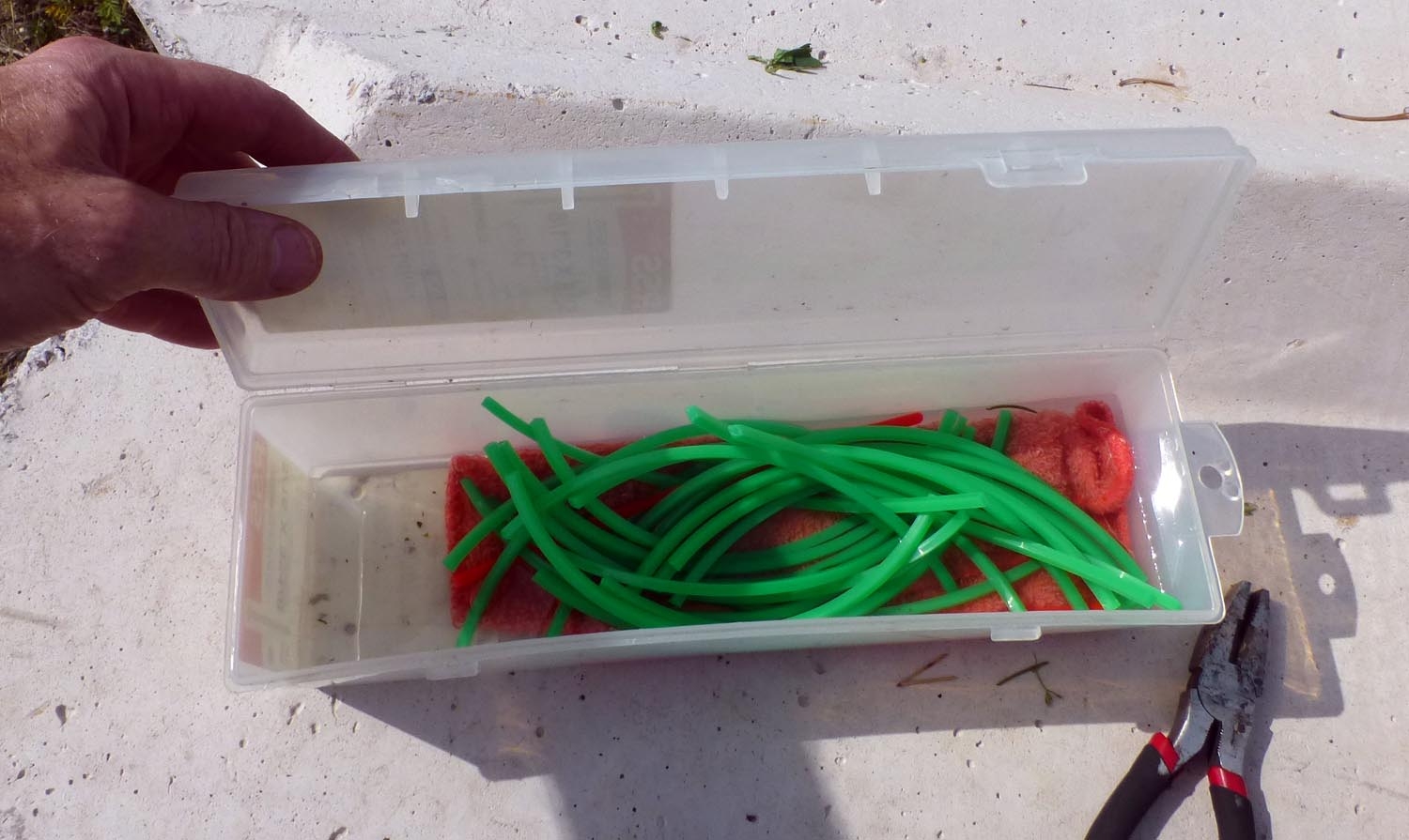

are you finding it more durable?

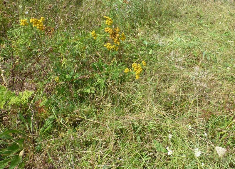

I'm not sure, but it might. Today I was going through string left and right but this semi dried weeds is as tough as cable. What is it this crap?
Here is my wet storage box.

Put a wet one in one side and a dry one in the other. See what happens.

All ours are three and four string heads and the only way to tell the difference is to mark them via sharpie. Nonthless I ran out of dry ones but will continue to test more in the future. As of now the soaked ones are no better.

OK, I've tested a bunch of wet string against dry ones while in the same head and they don't hold up any better.. In fact, the wet ones are breaking off about twice as fast as the dry one. That means I'd replace the wet stored ones twice, while the dry one was still in use. By wet, they've been under water for days before use. Oh well.

Thanks for doing the test. (y)

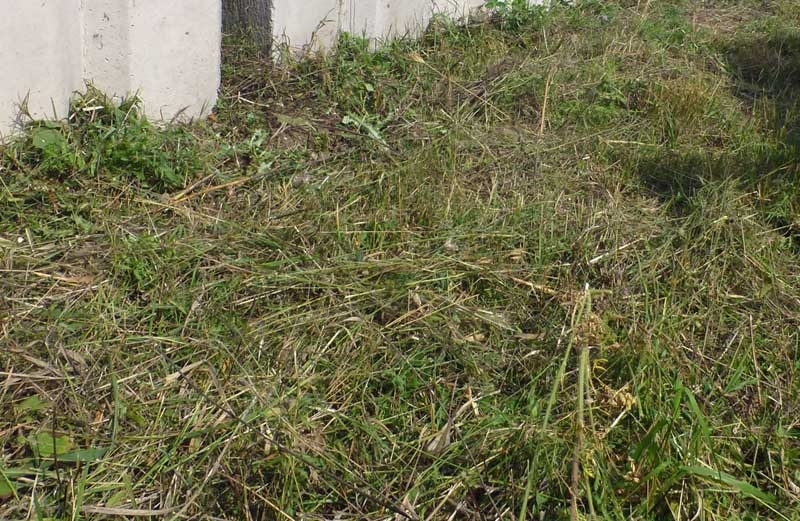

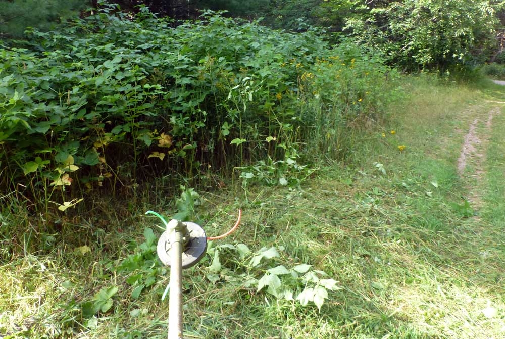

Here is the brush/grass I was cutting for the string test. In the top photo is the string head by Echo we use which comes with adapters for different shaft sizes and should fit whatever machine you have. Yes there are tree shots coming up in it that .155 string will take out to a certain point anyway. This is what we are normally cutting here..
