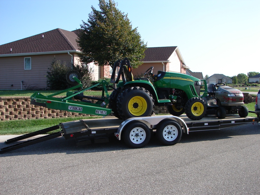

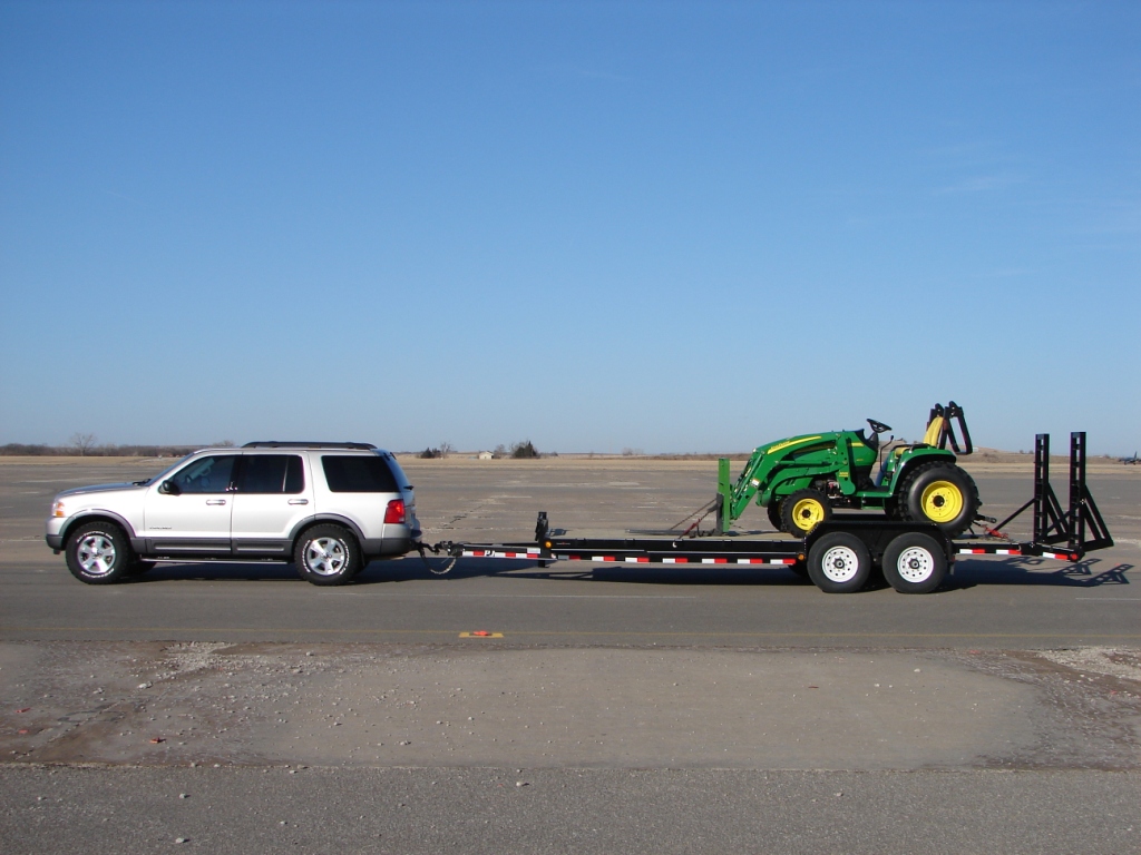

My thoughts: I would strongly recommend a 20' or 22'trailer rated at 10,000 or 14,000 lbs. It may seem like overkill, but I speak from experience. Sept. 07' I purchased a CUT with FEL and different rear attachments. I purchased a PJ, 18' trailer with two 3,500lb axles. I felt that the trailer was maxed, even though I never exceeded the max rating. The length seems fine until you actually start loading stuff on it and try to move the tractor forward or backwards to get the weight correct. After a few months of feeling very uncomfortable, I stepped up to a 22' PJ with twin 7,000lb axles and think that was the absolute best choice I could have made. You can always grow into a trailer, but if you buy too small, you will never be happy.
