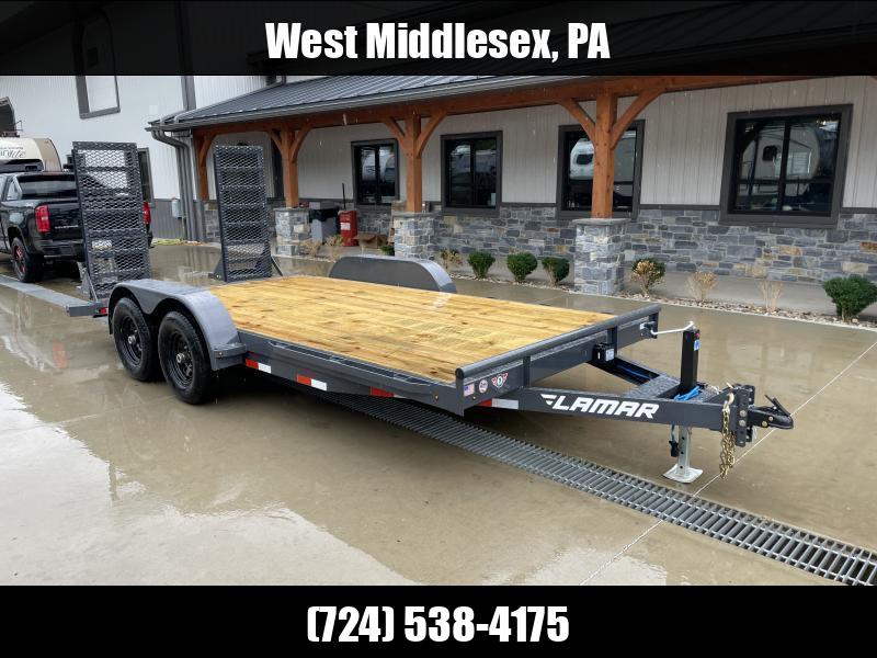

Something like this Lamar is pretty flexible. Ramps will handle anything the trailer will carry and removable fenders are nice to get it close to deck over clearance. Trailer weight, build quality and price are mid pack.

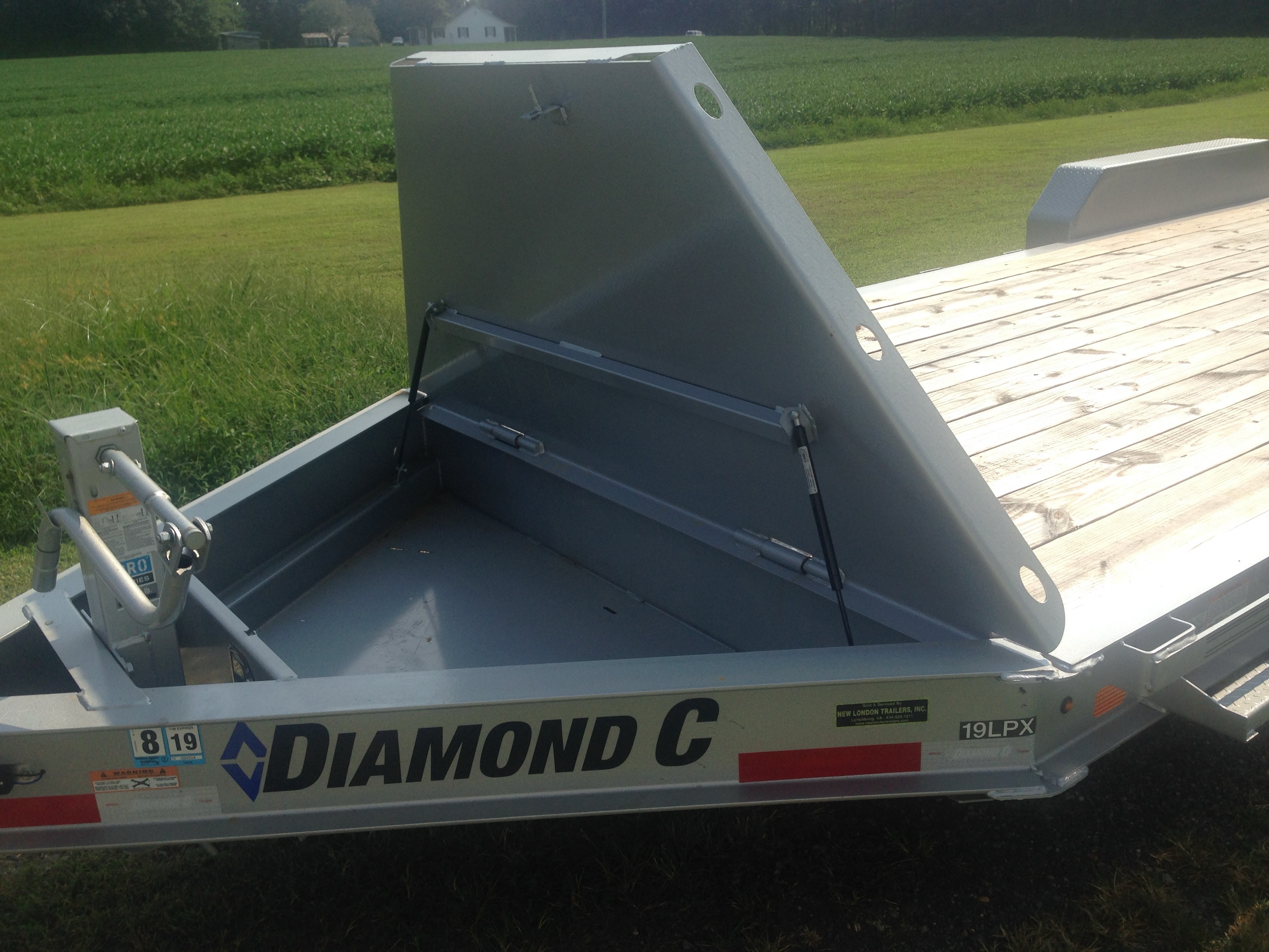

I would be looking at the 22ft. That extra 2ft is nice. Also would be looking at one with a nice toolbox on it for storage. I have been really happy with my Diamond C.

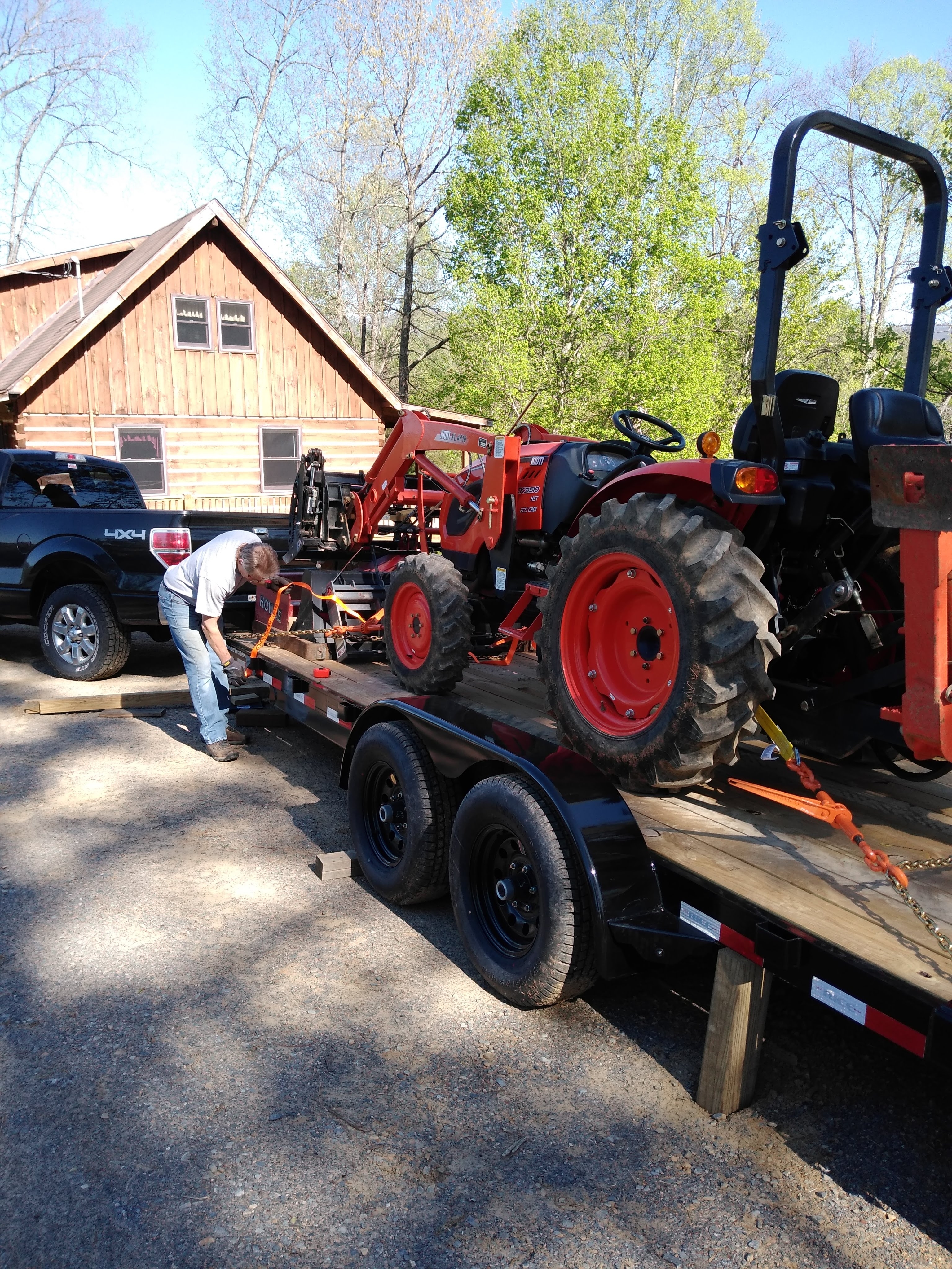

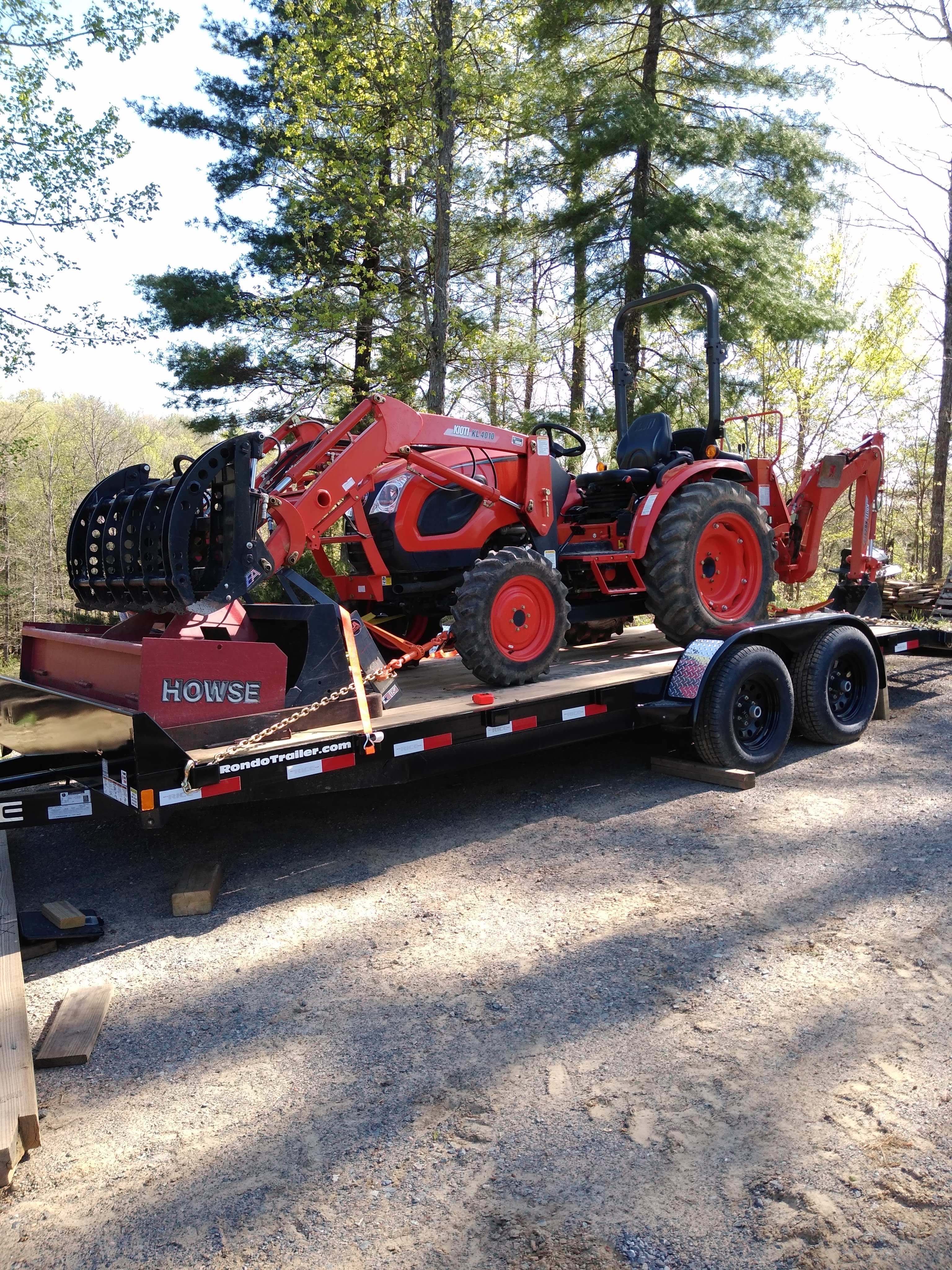

I've been very happy with the Rice 20' 10K trailer purchased for $4600 in 2021 towed with a f150. Picture shows a practice run of loading my tractor and all attachments for a move from Tennessee to Wisconsin.
