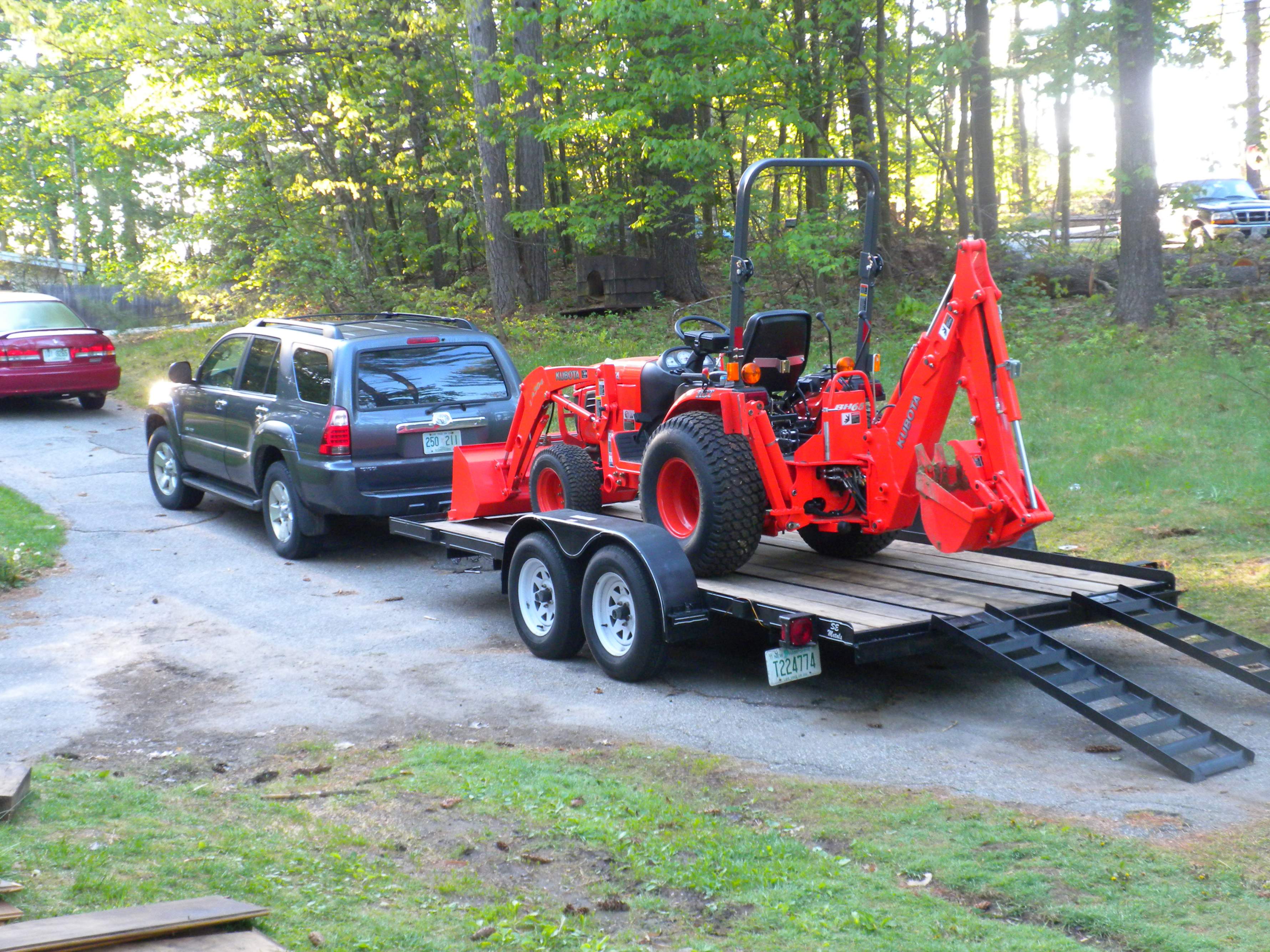

My 2007 Toyota 4 Runner was prewired for a brake controller, did your wifes SUV come with the factory pigtail ??..Easy Add-on.....My trailer is 16' and it works great with my tractor/SUV setup.....

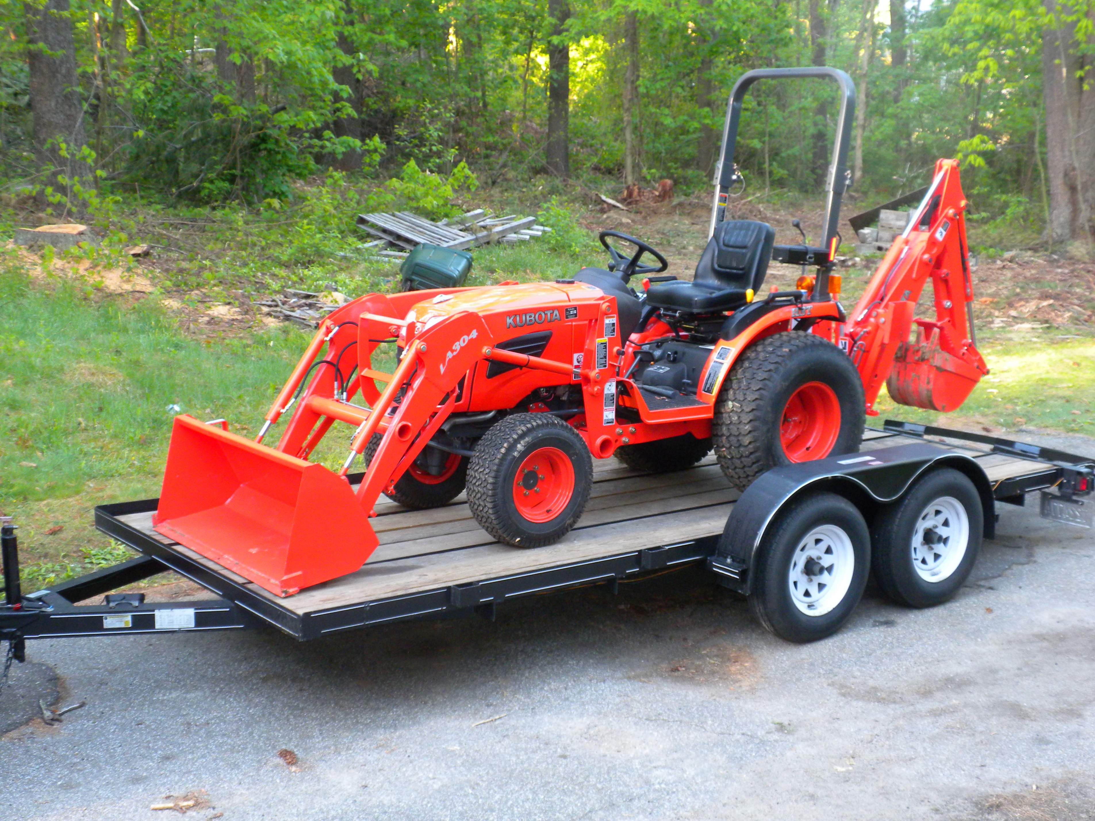

Does that B fit on the 16' trailer? It sure does look like it fits. maybe the hoe sticks out but I am pretty sure mine is longer than 16'.
   / trailer for B2920 #14
Yep, Fits good......Bucket right to the front rail and BH tucks in....just right....
