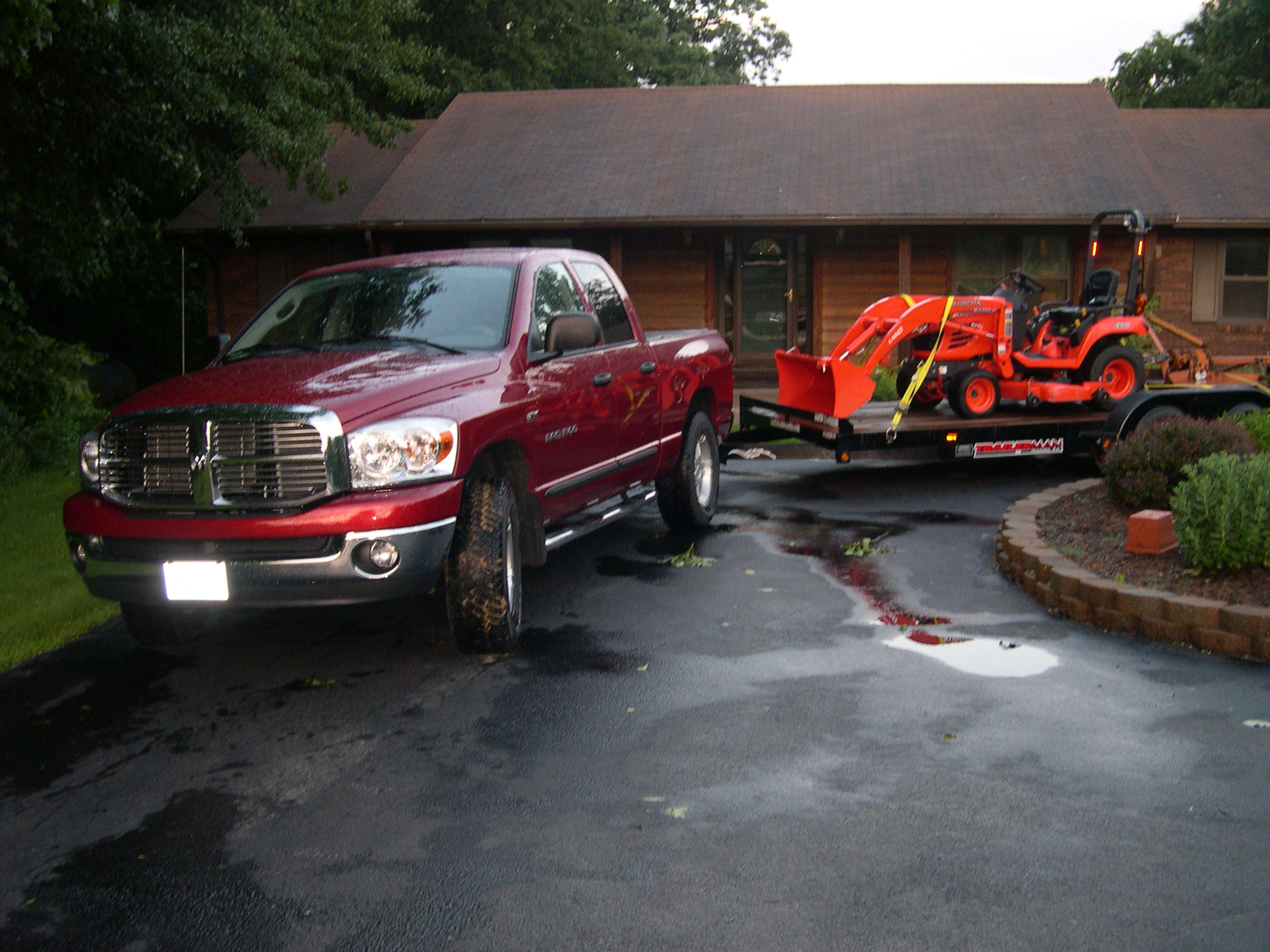

I wish this picture showed the trailer a little better, but this is my BX2350 with FEL and 4' brush hog on it. It is on a 16+2 trailer, a 16' flat deck, with a 2 foot dove tail. You can't see the back, but the brush hog is even with the back of the trailer, and there is maybe 6 to 12 inches between the fel bucket and the front rail. With your tractor, I wouldn't want to go smaller than 18', but I bet a 16' would work, but not as well. My trailer has the slide in ramps. You can see by the pictures that there isn't a lot of room left over to ballance the load, and your tractor is bigger than mine.
I looked at a 16' landscape trailer, with no dove tail. Its the style with side rails, and the entire trailer is lower than mine. Even though mine has a dovetail, I'm not sure the back end is any lower than a lot of trailers that don't have a dove tail.

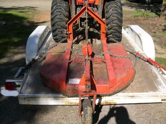

Here is the back of my old B8200 with 4' rotary mower on my 16' 7000lb 2 axle trailer. Pictures on the web show the B2620 is the same size as the older B8200/B9200. As you can see, the tailwheel used to hang over(I don't have that tractor any more). You're not seeing the loader on the front of the tractor... The front edge of the bucket was at the front edge of the trailer deck.
With just a scraper, it fit easily.
The B8200 was light enough, the balance did not seem and issue. The trailer seemed to set pretty even, and it towed like a dream. I towed it 200 mile round trip a couple times to a duck refuge cleanup day; rode nice.
Now I need a bigger trailer; my NH TC40D is much longer. It is within the weight rating of the trailer, but too long to balance...

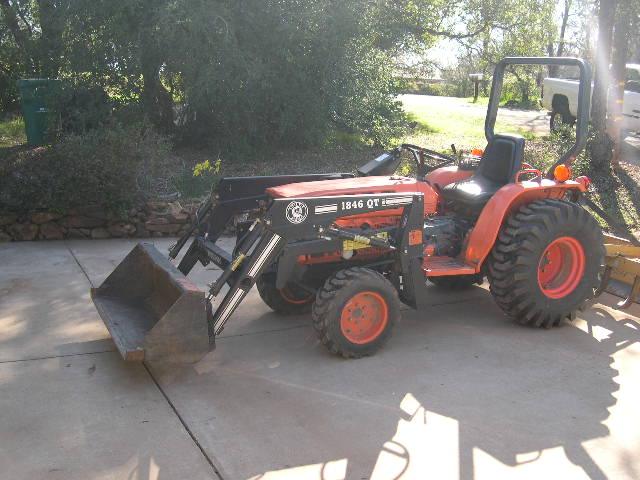

I have the same problem and have given it a lot of thought and for hauling it the distance you are planning I would say go with an 18footer. I am looking now for an 18footer about 77in wide. Due to lack of space this is what I need have not been very lucky yet in finding just what I want but a 16 with a bushhog is too short in my opinion. Here is mine on an 18foot trailer with a fel and box blade.
