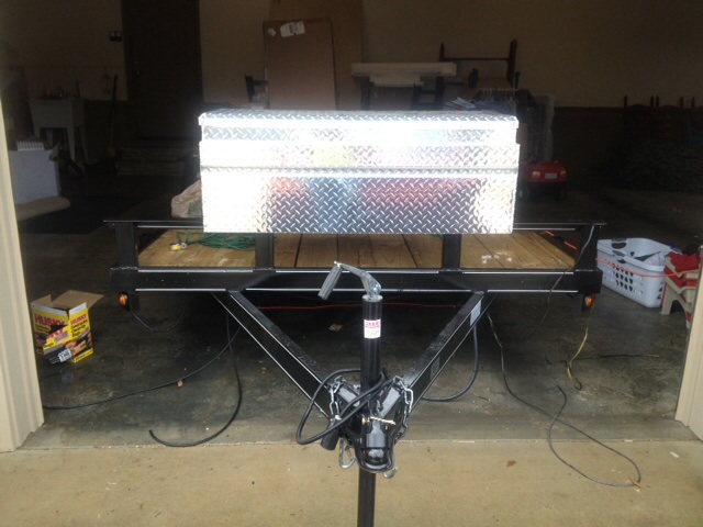

2) I am adding a storage box onto the front of the trailer because I am really tired of having to throw chains, tie downs, etc into the back of the jeep. Yes, I know first world woes :). Anyways the tongue on the trailer is pretty short so I do not think I will be able to mount the box in front of the deck for fear of bashing up the jeep. I could be wrong on this and need to test things. As well I don't want to lose deck space so...... Does anyone see any issues with mounting the box on the front rail of the trailer and building a small angle iron frame to support it?

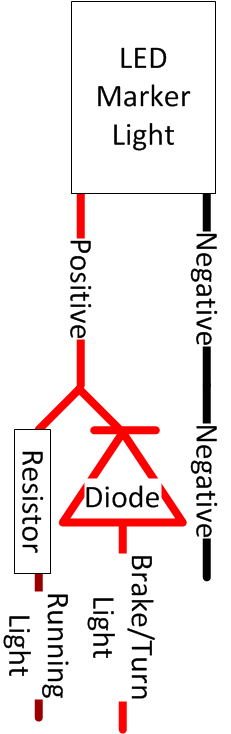

I would like to have the side marker lights function as turn indicator lights however I am not sure I completely understand how to do this. They trailer will be connected to a jeep commander with 7 way plug. Can I just simply run the left and right middle markers off of the left and right turn wires? If so will they also come on with the brake lights? I am okay with this if it happens for simplicity sakes - I know there is a relay based solution for that issue, but I don't want to attempt it at the moment unless necessary.
If you do that,the side markers wont come on unless the turn or brake lights are on.
Will your rear lights be LEDs, or incandascents? If you have incandescents, you can wire the markers to turn off when the brake or turn lights come on
Not unless you have incandescent brake lights somewhere in the system (see Volvo 740/940 Side Marker Lamp Wiring for how to wire them in that case ) OR you run wires for BOTH marker and turn signal lights, then put a resistor on the marker lights (just for the fenders) so that they run as seen below:
Adjusting the resistor to be (for example) 9 volts when the running lights are on will give you 9 volts for the running lights and 11-12 volts for the brake/turn lights.

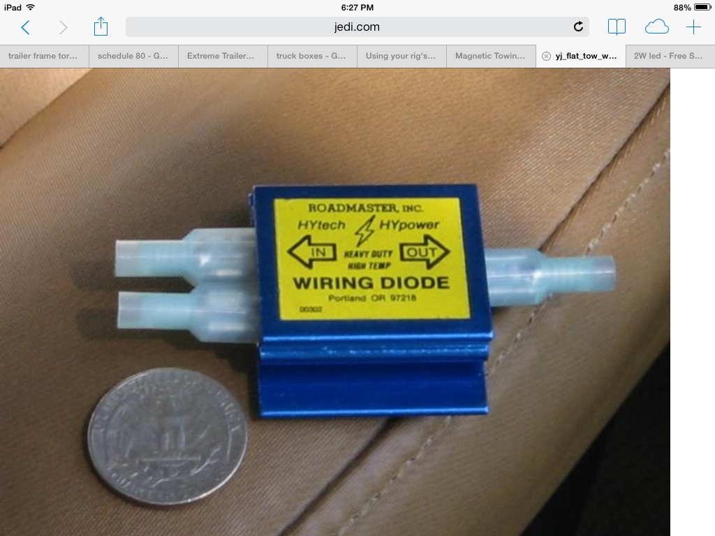

3) Lurking around Pirate4x4 I saw where someone had run wiring so that when they had a vehicle on their trailer they could plug the towed vehicle into the trailer wiring harness and the run the brake and turn lights via the vehicle doing the towing. I would love to do this with my tractor. I believe the individual who did this used diodes (purchased from and RV) to prevent issues with current going the wrong direction. It seem like a pretty simple mod - is there anything I am missing?
I am not sure that you would need diodes as long as the towed vehicle (and its lights) are off, but I could be wrong on that.

MSB1776 - I looked at a aluminum version of what you have and while it does eliminate the issue of jack knifing the jeep into the storage box I wanted something a little larger, both for storage and so that I can accommodate running my primary wiring junction box inside the storage box for a cleaner look. Thank you for the suggestion tho.

-------------------OR you run wires for BOTH marker and turn signal lights, then put a resistor on the marker lights (just for the fenders) so that they run as seen below:

Aaron, have you tried this with a LED marker light? I know it will work with incandescent lights, not sure about LEDs.
The LED in my rechargeable flashlight doesn't dim when the battery gets low, it just goes off.
The best way would be to use a LED side marker/ turn lamp.
It has separate wires for the two functions.

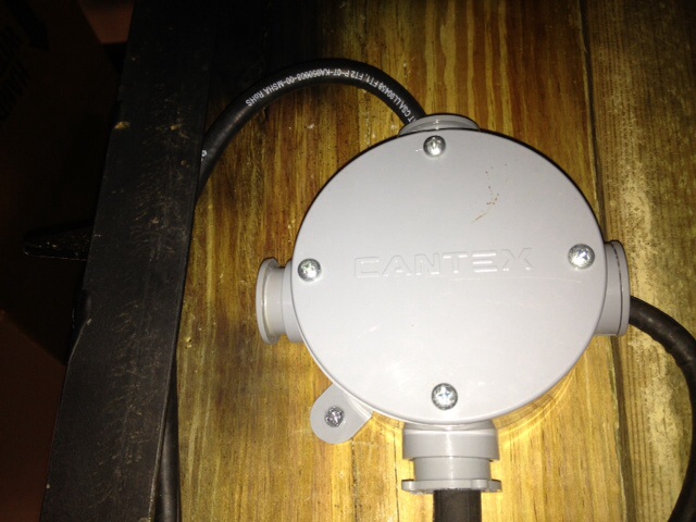

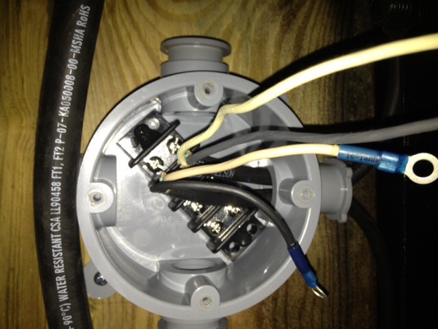

Regardless it should be relatively easy to experiment. The junction boxes I used have terminal strips in them so it should be easy to change wiring configurations:

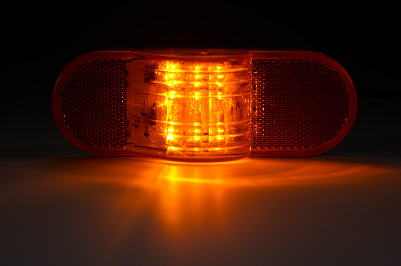

I have done it with this lamp: Clear LED Red Light 1x2 5" Oval Surface 2 Diode Trailer Truck Marker CLEARANCE | eBay and it worked well for the ~10 mins I tried it.
If you could get a small dual function marker that would be great.

Roger the box I ended up buying was a tractor supply chest:
I'm planning on mounting it on the front rail of the trailer with most of the area projecting out over the tongue of the trailer - that way I don't have to sacrifice deck area or deal with jack knifing the jeep into it if it was mounted directly to the tongue. While I don't have the ability or tools for welding I am going to have a local guy fabricate a frame and struts so that it is fully supported.

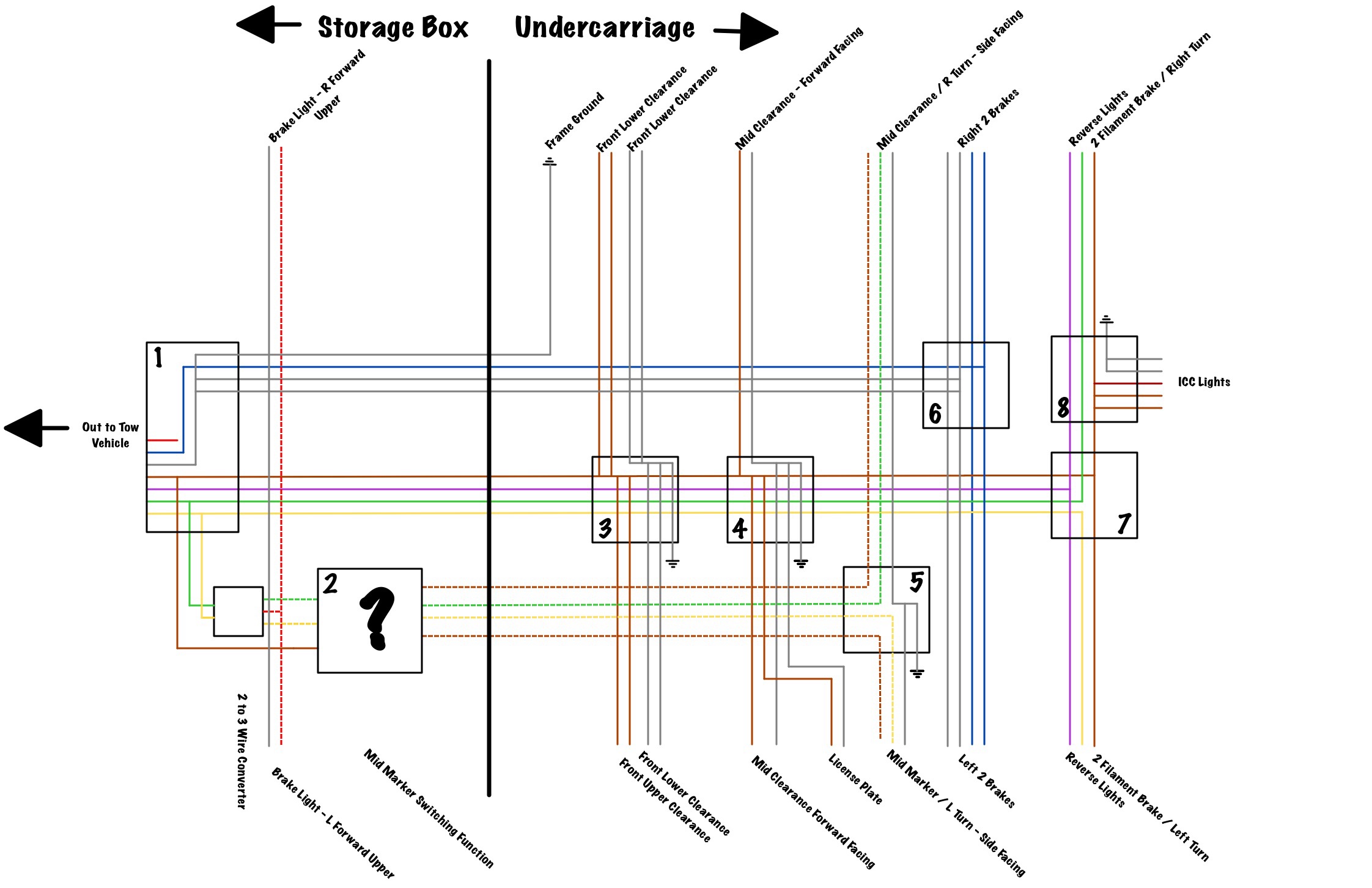

I did take the time and map out the wiring so that laying under the trailer assembling everything I would have guide to keep me from running off into a different direction than I had originally intended: (numbered boxes correspond to junction boxes. Please excuse any nonstandard notations, I can't even claim to play an electrician or engineer on TV :))

If you are doing that much work, I would also run a ground from front to back vs multiple grounds...
I would also see about merging boxes whenever possible. Can you run the front marker lights directly from the toolbox? Can boxes 6, 7 and 8 be merged?

the tail light converter goes in the tow vehicle before the plug. If you wire up your 7 wire plug to industry standard pin locations (which by all means you should) you wont be able to pass thru 3 wires for turn and brake only the 2 combined brake /turns.
you have front facing brakelights in your schematic?

Thank you Aaron for clarifying the point about the 3 to 2 wire converter versus the 2 to 3 wire converter. My jeep is wired for two wire brake and turn indicator. My plan was to use a converter to go to three wires so that I don't have to deal with the issue of the mid- side markers coming on when I pressed the brake pedal.
Very valid point about combining junction boxes. I may be able to in some cases and may be able to run a ground from the front all the way to the back instead of doing frame grounds. The problem I am running into in that regard is wholly due to the materials I have on hand and the physical constraints of their size.
Because I am using SJOOW as well as six position terminal blocks, which is what I have on hand, there are only so many connections that I am able to make inside of a junction box. But as I said at the beginning you have a very valid point. For better or worse in regards to this project I am going on vacation for about a week so I will have plenty of time to think it over and refine the design.

I suggest you do what ever you have to do, to run ground wires.
Even if you have to run a separate wire for the grounds, and have to run it outside the conduit.
This eliminates one of the most common failure points.
I always run grounds, and solder all connections on a trailer. And, then cover them with shrink tubing. That lasts me the entire life of the lights, and the paint job. Usually > 10 years.
