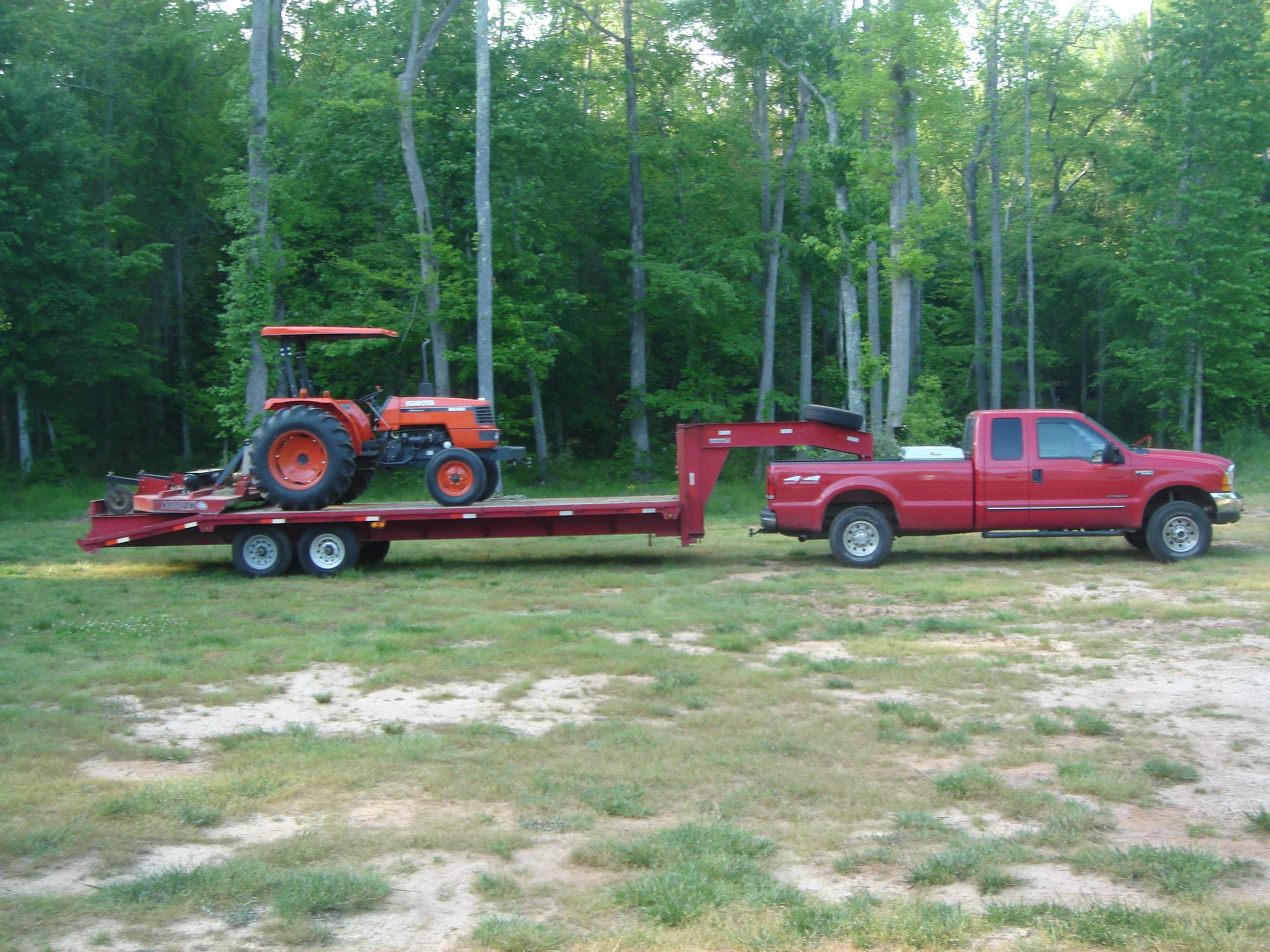

Not enough trailer. Kubota's website lists that tractor at 3,620 lbs. dry weight The front end loader on my TC-45 weights 900 lbs without the bucket, so we can assume somewhere in that ballpark. Let's assume 300 lbs for the FEL bucket and 300 lbs for the box blade. Grand total is 5120 lbs. Trailer capacity 7,000 lbs minus trailer weight 1,500 equals payload of 5,500 lbs. Only 380 lbs of margin. We haven't added fuel, chains and binders yet. Also factor in not enough room to move tractor fore or aft to balance the load.
I have been thinking the same thing, and actually have the trailer for sale on craigslist. I had a guy offer to trade a RV trailer that has been converted into a flatbed. Let me know what you guys think about that trade.

My hitch says 1000 lbs tongue weight, 10,000 lb trailer...either load carrying or WD. (You do realize you can buy different hitches, even some with heavier ratings?) I could even drag my welder out and weld a big honkin' plate on the back that'd hold a whole lot more. The sticker on the hitch is NOT a reflection of the vehicle's capabilities, it's the limitations of the itty bitty hitch.
My point is this: heavier trucks don't need WD hitches. My long wheelbase diesel, with 8800 lbs GVWR and stiff springs, does just fine towing a 6800 lb trailer without a WD hitch. It's already front-end heavy, a few pounds off the front end is not a bad thing!
A WD hitch limits the suspension of both the trailer and tow vehicle. Buy a tow vehicle rated for the load, and let the suspension work as designed.
PS: PLEASE resize that picture so the thread isn't half a mile wide!!

I appologize for posting that picture...I didn't know it was going to be so HUGE...:(
