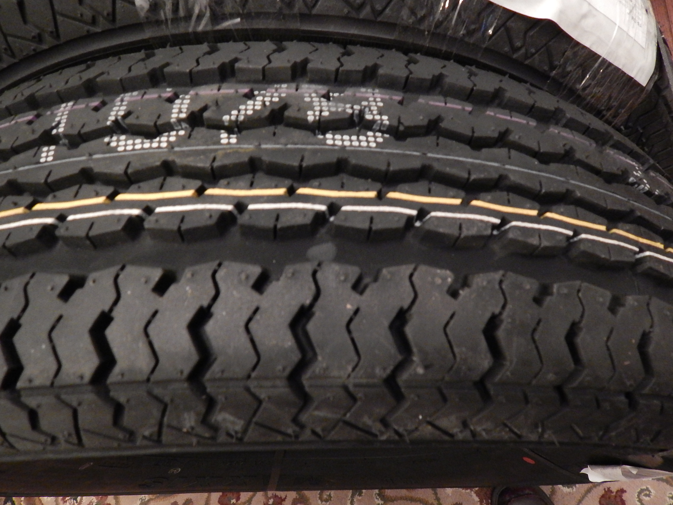

new trailer tires came in today, to replace the oem Chinese bias plies.
Like the Kumho radial trailer tires I've also ordered, these were nicely made, finished, and the tread depth
seemed generous. With shipping, 120 apiece. No bargain, just hopefully quality tires.
