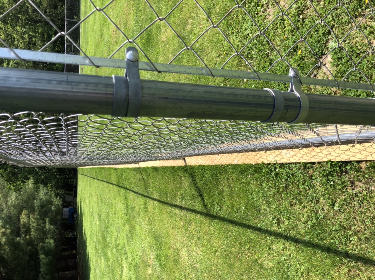

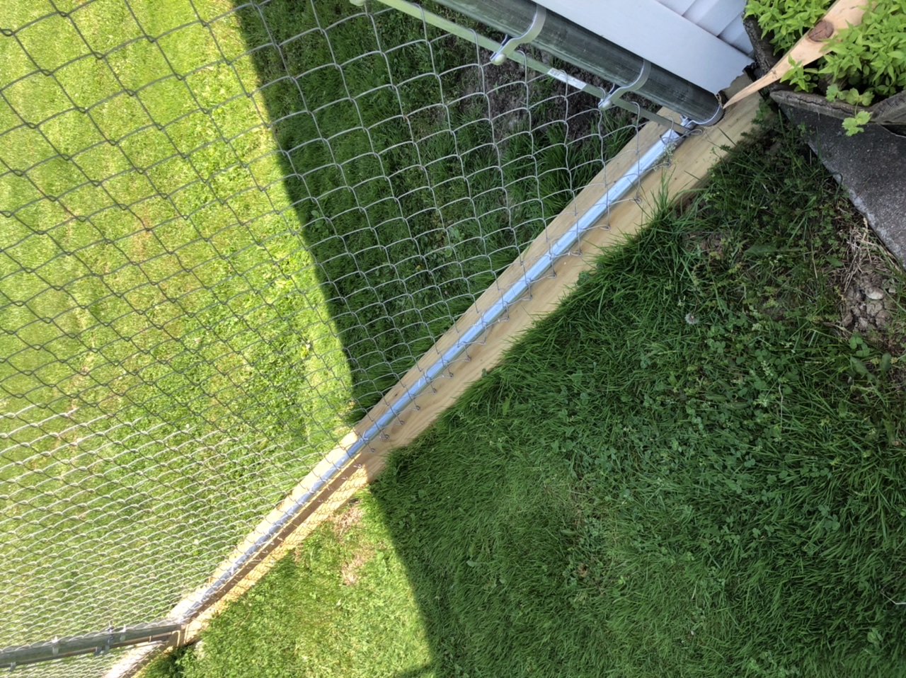

Here’s my solution, I have 3/4 acres in the dog run, I have 4 of my own and foster others. I run a 2 X 8 long the bottom of the fence with holes drilled for the posts. Then all it takes is to set the deck on the top of the wood, and mow. No trimming needed except in the very corner of the inside corners, and then it’s against wood not metal. E5FF2F51-A12B-4837-AF1C-52582B224FCB.jpeg41980A28-F667-42B5-8213-3E3CD52EB955.jpeg

That's a pretty slick solution. Do the boards stay flat and not warp?
The oldest section is now 14 years old, and I had 1 board that I replaced that warped. The weight of the fence seems to keep them from warping up, and to keep them in line where they butt against each other I cut a 12 to 15 inch piece, dig a little dirt out and deck screw both ends to it. Keeps them lined up real well.
