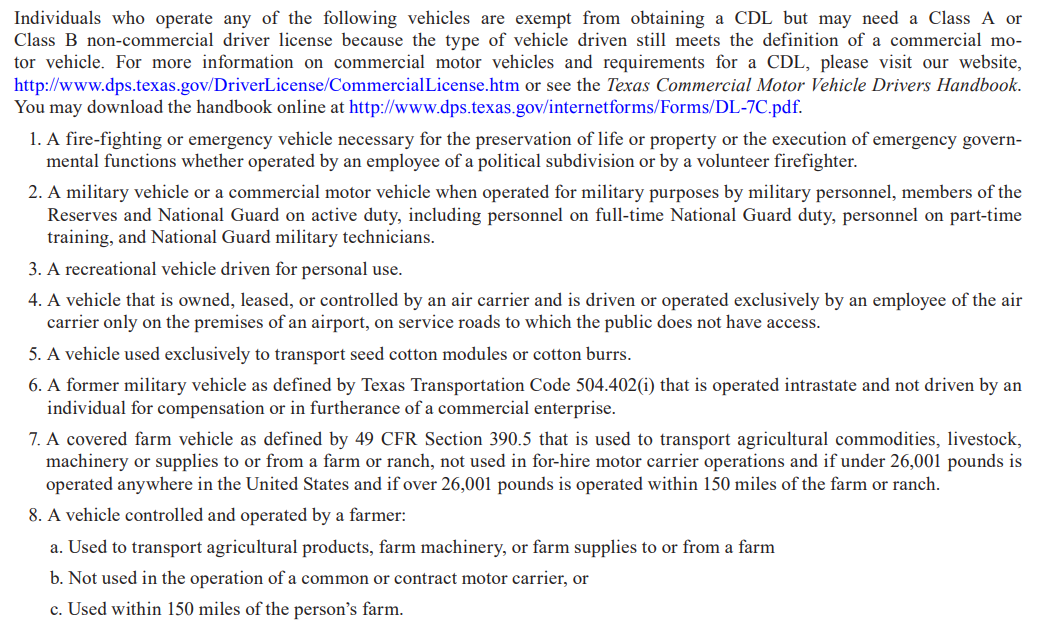

This is only for Texas, I can't speak to other states, and sorry for the length. I am a retired Texas peace officer that dealt with this issue for our Fire Department drivers. Texas law allows for a Class A or Class B non-CDL to operate certain vehicles, including certain farmers. You take the commercial written and road test in a 26,001# or greater GVWR vehicle for the Class B, add a trailer over 10,000# if going for the Class A. You are exempt from all other CDL rules such as medical exams, hours of operation, logbooks, etc. Our ambulance was on a Freightliner FL70 chassis that required a Class B non-CDL, as well as most of our fire apparatus. The tillered ladder trucks require a Class A non-CDL.
A farm vehicle driver driving a vehicle over 26,001# and staying within 150 miles needs the Class A or B non-CDL. Take a 26,001# vehicle or combination over 150 miles from the farm and you need the appropriate CDL. One business that has taken off is horse owners with CDLs taking horses to horse shows for other owners that don't want to bother getting a CDL. We stayed under the limits with our truck and trailer using the Class C exemption for hauling a 20,000# or less trailer behind our 2500HD pickup, no mileage restrictions. The folks that got into trouble were driving a Freightliner M2 or International 4900 hauling a 4 horse 3-axle trailer with living quarters with a Class C license.
From the Texas Driver Handbook:

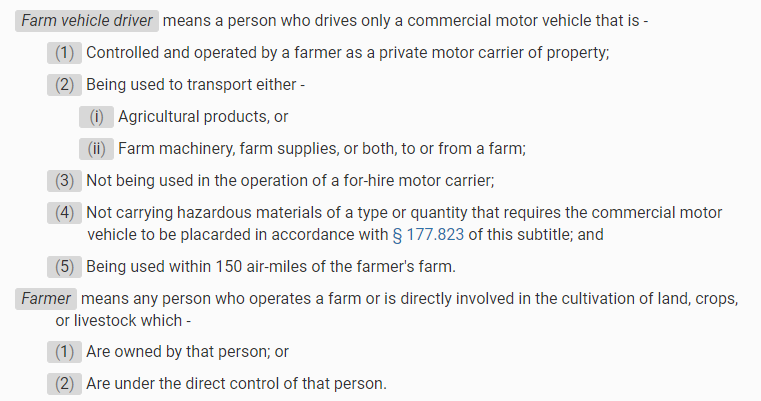

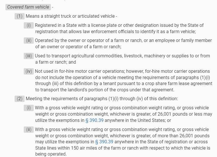

49 CFR 390.5 gives the federal definition of a covered farm vehicle, farmer and farm vehicle driver.

"What is a Covered Farm Vehicle? (FMCSR 390.5)
(a) Means a straight truck or articulated vehicle:
(1) Registered in a State with a license plate or other designation issued by the State of registration that allows law enforcement officials to identify it as a farm vehicle; Note: The Texas Department of Public Safety has designated form CVE-30 as that identification. http://www.dps.texas.gov/internetforms/Forms/CVE-30.pdf
(2) Operated by the owner or operator of a farm or ranch, or an employee of family member of an owner or operator of a farm or ranch;
(3) Used to transport agricultural commodities, livestock, machinery or supplies to or from a farm or ranch; and
(4) Not used in for-hire motor carrier operations; however, for-hire motor carrier operations do not include the operation of a vehicle meeting the requirements of paragraphs (a)(1) through (3) of this definition by a tenant pursuant to a crop share farm lease agreement to transport the landlord’s portion of the crops under that agreement.
(b) Meeting the requirements of paragraphs (a)(1) through (4) of this definition:
(1) With a gross vehicle weight or gross vehicle weight rating, whichever is greater, of 26,001 pounds or less may utilize the exemptions in 390.39 anywhere in the United States; or
(2) With a gross vehicle weight or gross vehicle weight rating, whichever is greater, of more than 26,001 pounds may utilize the exemptions in 390.39 anywhere in the State of registration or across State lines within 150 air miles of the farm or ranch with respect to which the vehicle is being operated."
Then on page 6 there's this
"**CDL Exceptions
(a) Farm vehicle drivers are exempt from CDL requirements if:
(1) Used to transport their own agricultural products, farm machinery, or farm supplies to or from their farm;
(2) Used within 150 miles of the person’s farm."
Am I reading this correctly? If the truck and trailer are both registered as "Farm" vehicles, and I'm not using them for hire, but I am using them to transport farm equipment or feed, like round bales of hay, then the weight limit of 26,000 pounds doesn't apply?
