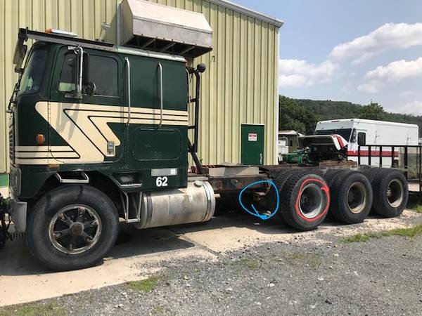

/ TRUE tri-axle? #35
Did you look at the other pictures? Looks like a driveshaft was removed. Wondered why
There are a few true tri’s out there. Military has them, too. Always wondered how the front-most axle survives the stress of full lock turns!
Lot of truck for the money
I keep wondering too, when i see North American dumptrucks with 7 rigid axles and one steer. Here in Holland most dumptrucks have only one rigid axle and up to four steer axles, all of them driven.
The older trucks in this video are 10x8 with a steered lift axle in the middle, lifted when going offroad to keep all weight on driven tires. The newer has its 3rd axle fixed, and 1,2 and 4 and 5 steered. Its on supersingle tires to save weight and to have less resistance in soft terrain because all tires run in the same track.
/ TRUE tri-axle? #36
Hello Haydude,The tri axle tractor unit is a tandem drive lazy pusher axle setup. On that short wheelbase you should expect plenty of understeer on road and off road in slippery conditions will be very difficult to turn when loaded.
Also the lazy axle can tear a lot of stone out of bitumen roads on tight corners, espesially on hot days. A true tri drive tri axle however, did a lot less pavement damage acording to the drivers. On log trucks on wet skid sites a tri drive can get out without the bulldozer assist a tandem drive unit at the same weight would need.
