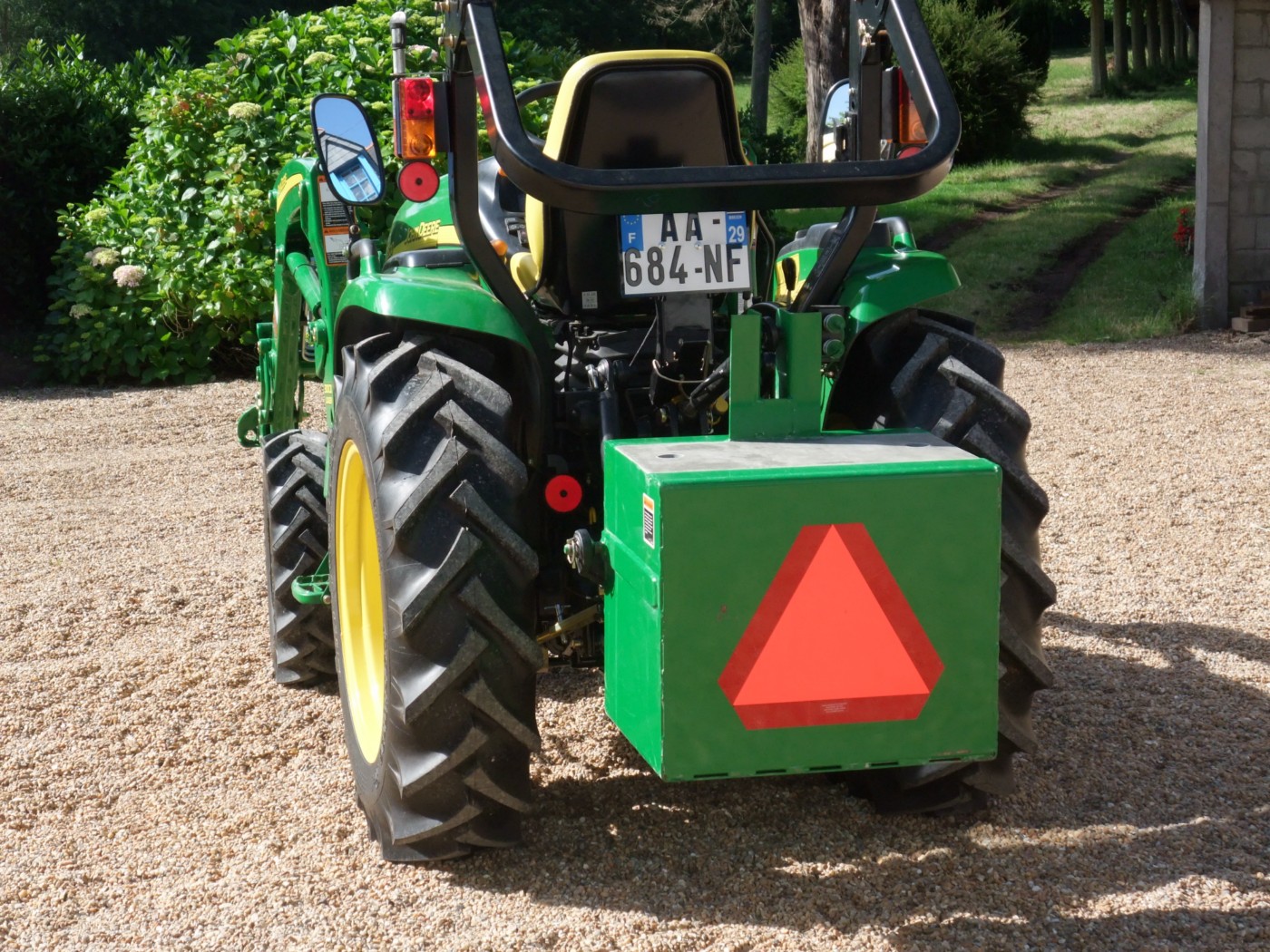

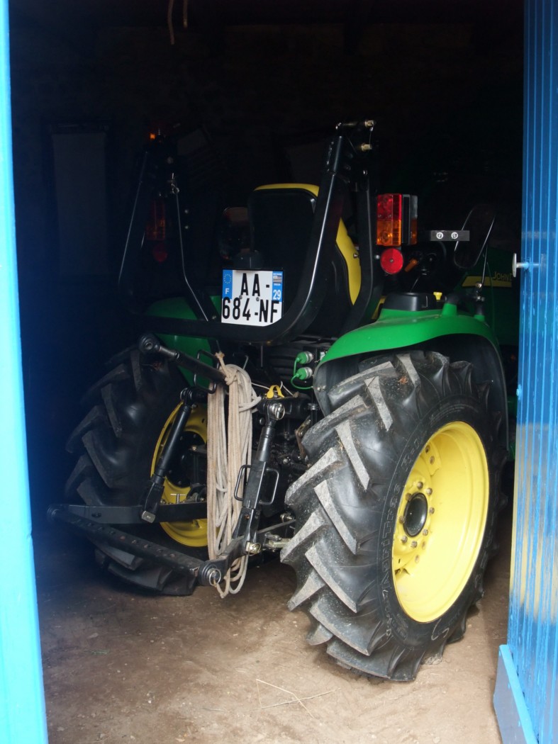

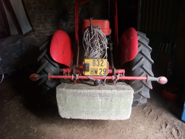

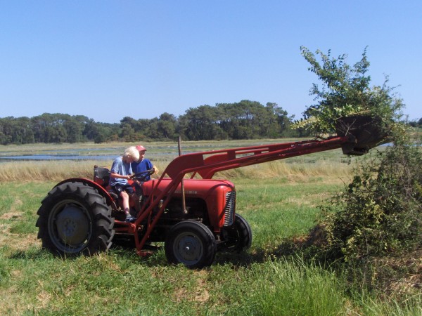

I work on grass 95 % of the time but I have R1s for the better traction (we do not load our tires). The Ags do dammage the grass a bit, especially when in 4wd, but I never dreamt of having an English style lawn. The marks can hardly be seen in the natural grass.
