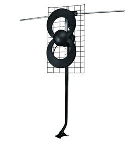

My antenna is upstairs in a metal building about 40 miles from the towers, and works!
It has VHF elements added to a UHF antenna.
Got it here: Antennas Direct C2-V-CJM ClearStream2 Outdoor Digital HD TV Antenna With Dipole And CJ Mount (C2-V-CJM ) from Solid Signal

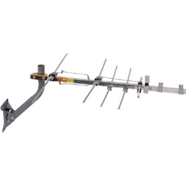

Here is another one that has VHF and UHF elements and works inside my house, behind the TV in a corner.
It is a RCA ANT751.
