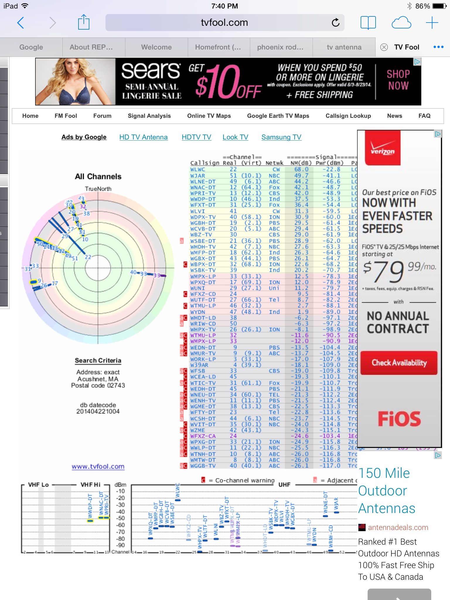

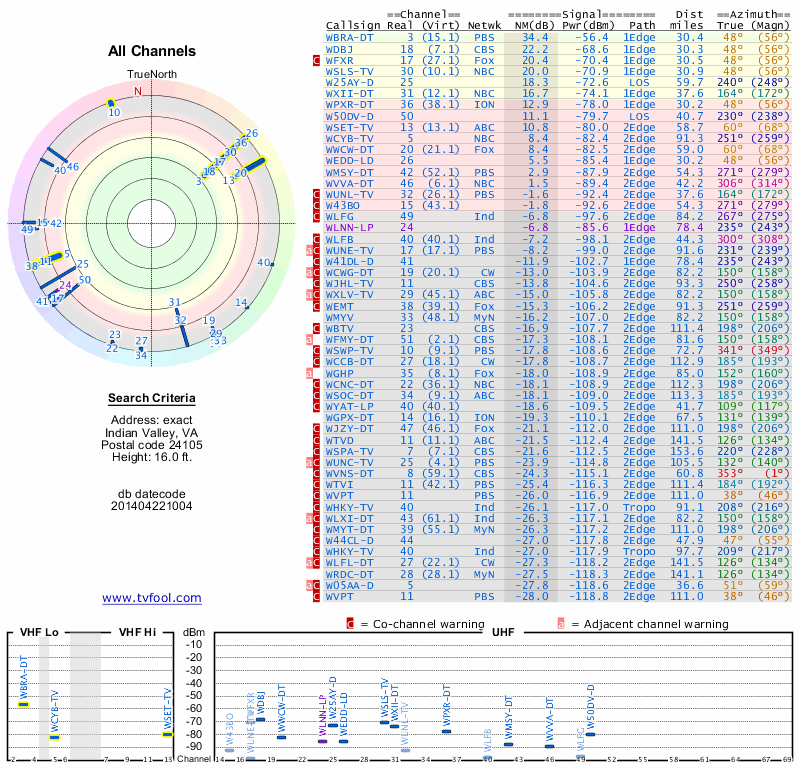

You have over 20dbm better signals than at my location.. that -22dbm one might light an LED if you put an antenna on it:D Just kidding, but that is a pretty strong signal. That is almost 1/100 of a milliwatt into a reference antenna.
James, out of that list, I get the top three in green and three others for a total of six. I'm wondering if a better antenna would do much. I was looking at the Antennas Direct - ClearStream 2V Long-Range HDTV Antenna at Best Buy for $100.

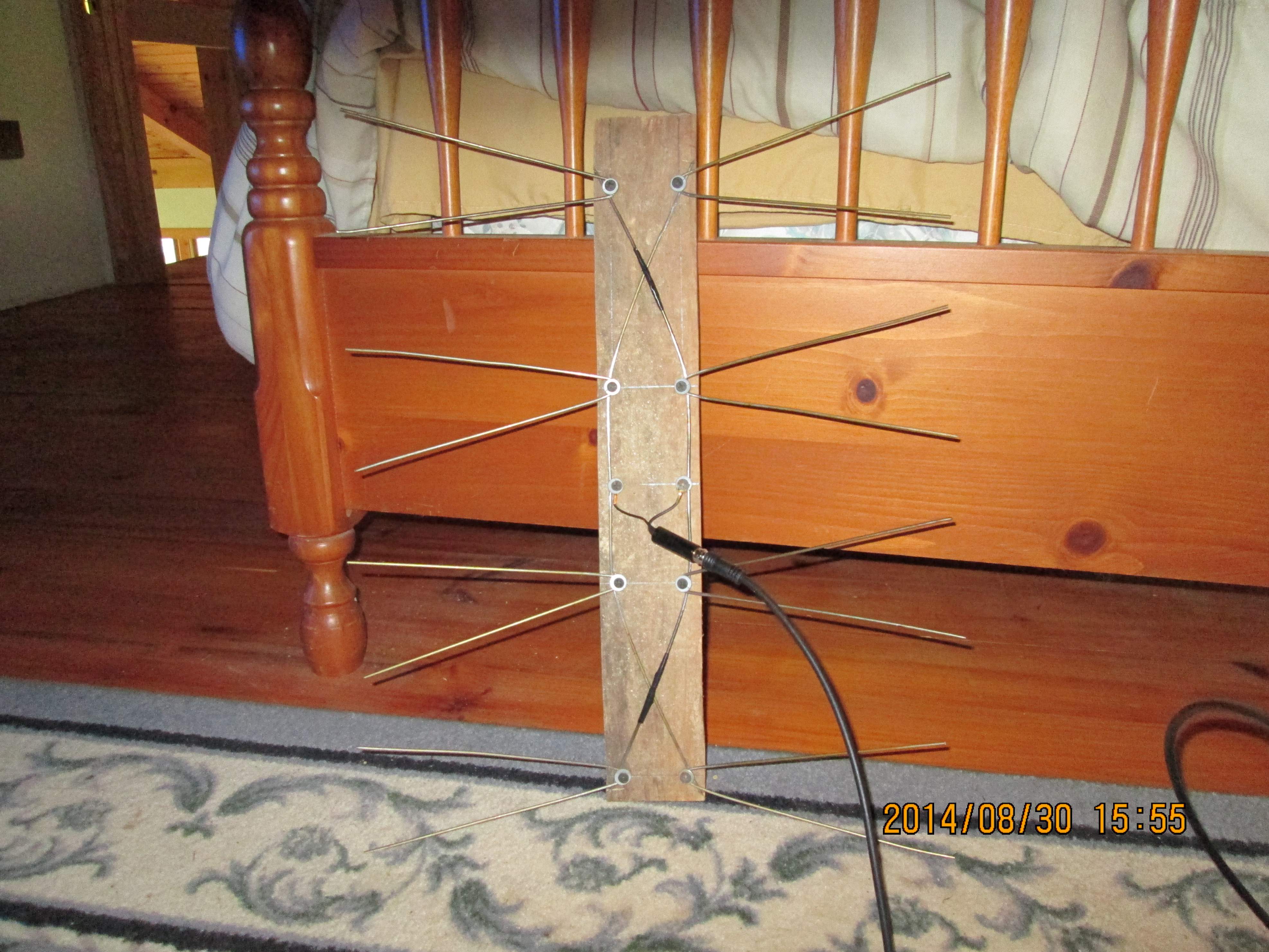

i went ahead and built the wire hanger antenna. it works very well for 2 channels, nbc and cbs. no reception of fox. i think placing it outside and higher will help.
/ tv antenna #32
try and do a "full re-scan" of all channels after hooking up a new antenna. it might tune itself, in better. rg6 is cable i am using between antenna and tv.

this is my antenna.
