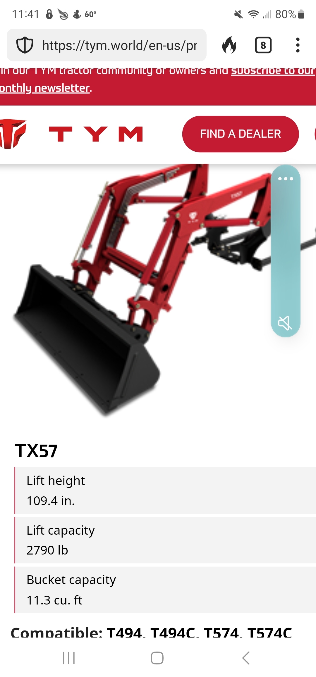

Many other brands advertise heavy lift capacity, but the tractor weight isn’t commensurate with the advertised lift capacity. What the loader hydraulics can lift seems to be unsafe for the light weight of the machine. My MX will lift just under 2400 pounds, but one ton feels pretty heavy for the machine weight. I wouldn’t want to lift more on that size/weight machine. Yet I see other brands of comparable machine weight advertising a lift capacity of 2700 pounds. There’s hydraulic lift capacity and safe handling capacity. I wouldn’t want to lift more than my MX capacity unless the tractor weighed significantly more. And yes I have filled rear tires and at least 1000 pounds of 3ph ballast when I’m lifting anything heavy with the loader.
That's the thing. Your MX is lighter than my 574 that lifts 2700 pounds. Part of the reason I can lift more is the heavier base tractor and bigger cylinders. No matter what you add for ballast, other brands can add them, too. Just breathe deep and accept that Kubota isn't the best at everything. They have positives, but they are straight up weak at lift.
Your TYM574 has a bare tractor weight of 3887, my MX6000 has a bare tractor weight of 3734. Both weights without loader or ballast. A difference of 153 pounds? The lift capacity of the TYM574 loader is 2478 pounds, and the MX loader about 2400 pounds. Not a significant difference. I invite you to lift 2478 pounds. The hydraulics can no doubt do this, but the butt pucker would be extreme, especially as you move this weight any distance. 2000 pounds on this weight class machine is all that I feel safe lifting and moving, even though the loader specs say 2400 pounds. Unless you have an iron butt, I don’t think you’ll be lifting and moving 2400 pounds with your 574. I would want a larger frame heavier machine for any lift approaching 2500 pounds. The specs are a marketing ploy more than a practical use measure. The TYM does have a price advantage over a comparable Kubota, no doubt, but capabilities are a wash.

I have a rear blade that weighs 1025 pounds plus filled tires. Filled tires are about 1000 pounds.
   / TYM T474HC at the top of my list to buy #58
That is less than half of your rated 3 pt hitch capacity. And it's probably fairly close to the back of your 3 pt, as compared to say a 3 pt brush hog that sticks out 8-10' off the hitch arms.
The reason your butt is "puckering" is because that's not enough counter balance weight for a "max lift" on your specific tractor. Your 3 pt is rated for 2310 lbs. If you're going to max out your FEL lift, for one that is a big lift you need to prepare for, you need 2000 pounds on the back to max out your rear ballast and have true "balance" during that lift.
That rear blade is probably fine most of the time, for any number of random FEL lifts. But when you go for a "max" lift, you need to set up your lift in advance with a max rear weight, not half the rear weight. And yes, that's even with filled rear tires (filled rear tires is a good thing too, but doesn't do as good a job of counterweight, as the rear tires are much closer to the lifting fulcrum, which is the front axle). If you try that, you will see a profound difference in what your "butt" does while you lift it.
This points to exactly what I'm talking about. It is up to the operator to determine these things. Owner's manuals and legal disclaimers can only go so far (remember, they're busy warning you not to drink the contents of the battery). The Korean brands you are disparaging as using "advertising draw"s and "exceeding safety limits" as some kind of stunt, are taking it for granted that the seat operator takes all these things into account before they start performing operations like "max lifts", etc.

That makes for even more butt pucker. 2800 pounds on a bare weight 3887 tractor? Try that and see how stable your tractor feels, even with filled tires and 1000 pounds on 3ph. I’m skeptical that this is a real world practical use. Seems like the hydraulic pressure is turned up to achieve this, but is it safe?
