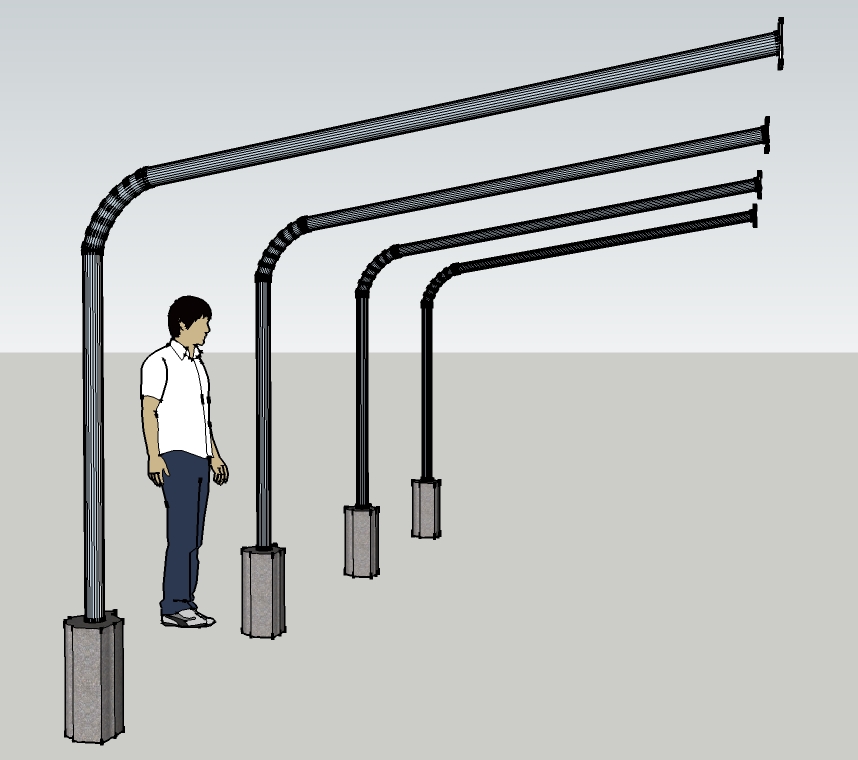

Here's a quick and very rough sketch I made of what I want to make:
The sidewalls are 6' high, the roof angle I just guessed, 14' wide x 24' long. The "hoops" are spaced 4' apart so that one 12' sheet of steel could cover three of them. Everything else would pretty much be 1 3/8" pipe except the purlins would be 2x4. What do you guys think?
If I bent the pipe like this, I would only need 3 peices per hoop, (at 10' long) vs 4 peices plus extra parts to use fittings. The 10' length leaves a bunch of waste. I just wonder if the HF bender could handle that? Obviously the angles wouldn't be as sharp as they are in the sketch.
I can't really make trusses because I need the peak height to be somewhat low and then I wouldn't be able to fit a vehicle in there.

Don't forget the benders shoes are sized for pipe size
Tube size you are looking at is 1.375 od
between 1" and 1 1/4 pipe sizes
it wont fit the shoe properly and will most likely kink it.

That's the major thing I've been wondering about. What if I used the 1.5" pipe die? Maybe with a peice of 1.5" steel pipe sliced in half on it? Or can I buy a die or different bender that might work better? I like the idea of these 1 3/8" fence rails, ten feet is cheaper than 1" EMT and about half the price of 1" schedule 40. But what is the "proper" way to bend them?
Obviously I'm not building an exhaust system so it doesn't have to be a perfect bend, but not totally kinked....
