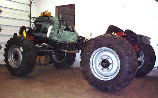

Time for another update! I now have a rolling chassis! Still need to do some brake work and hook up the air lines, but at least I can move it out of the way if need be. My cab from England is being held up by US customs. I guess they think that Unimogs are a real threat to national security! /forums/images/graemlins/mad.gif They charged me $155 to Xray the crate and still have held it up for over two weeks now! The broker I am using said I should have it by Wed. I sure hope so. Here are some photos that I took today. Von

And another photo of the rear axle and some of the new brake lines.

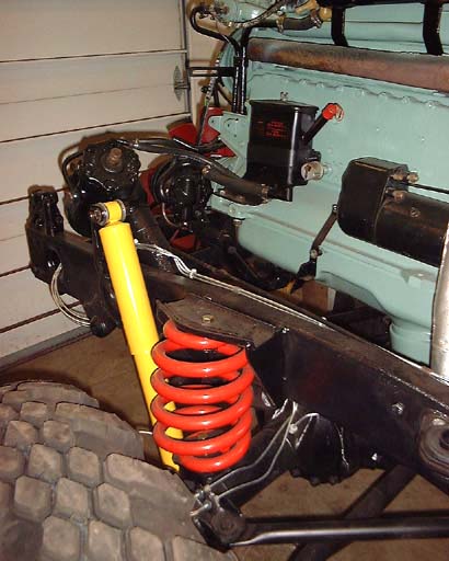

here is the tranny and more of the new brake lines and flex lines. I have used almost 70 ft of brake line on the chassis alone!

here is one of the front end and coil and shock setup.

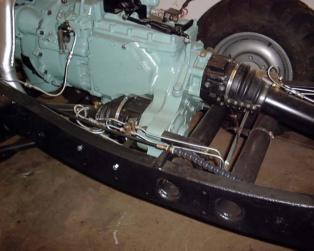

Very nice work, Von. Say, how is the shaft coming out of the rear of the tranny? Looks like it is inside a boot.
   / UNIMOG RESTORATION UPDATE + PHOTOS
#170
Thanks for the kind words guys! To answer a few questions:
Mossroad, The driveshafts are inclosed and sealed in torque tubes. They are water and air tight. You can just make out the breather fitting at the top of the tube before the boot.
