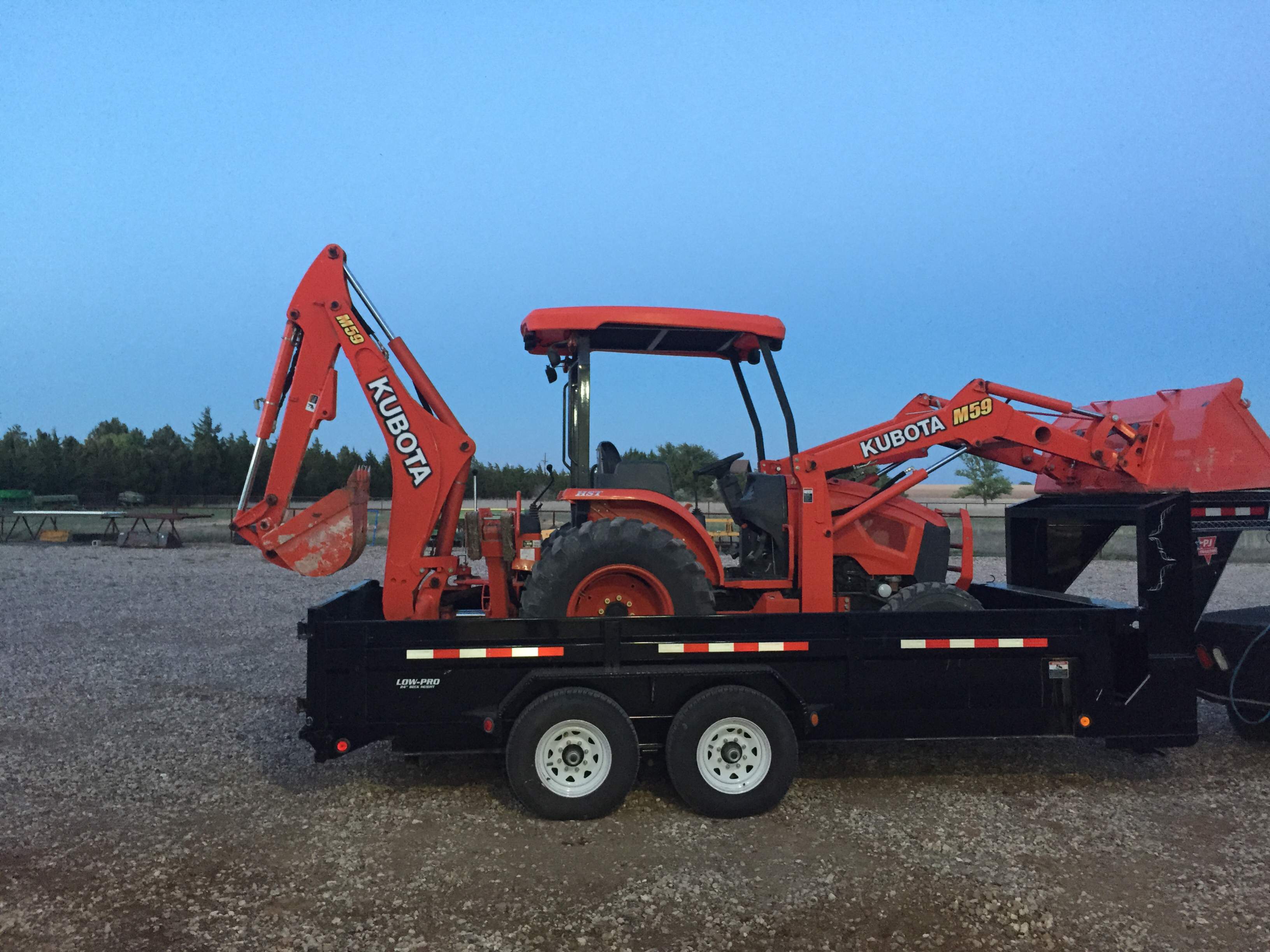

I haul my M59 TLB in a 16' low profile dump trailer. It is easy to load, I can easily reach over the sides to chain it down, and overall I really like it. I have a couple gooseneck equipment trailers as well but I see no need to use them as the dump trailer works just fine and is not any kind of hassle.
   / Using a dump tandem axle trailer for hauling tractor? #20
Bdog that looks like a nice setup. I should have looked for something with lower sides like that. The sides on my trailer are taller and make reaching over the side impossible.
