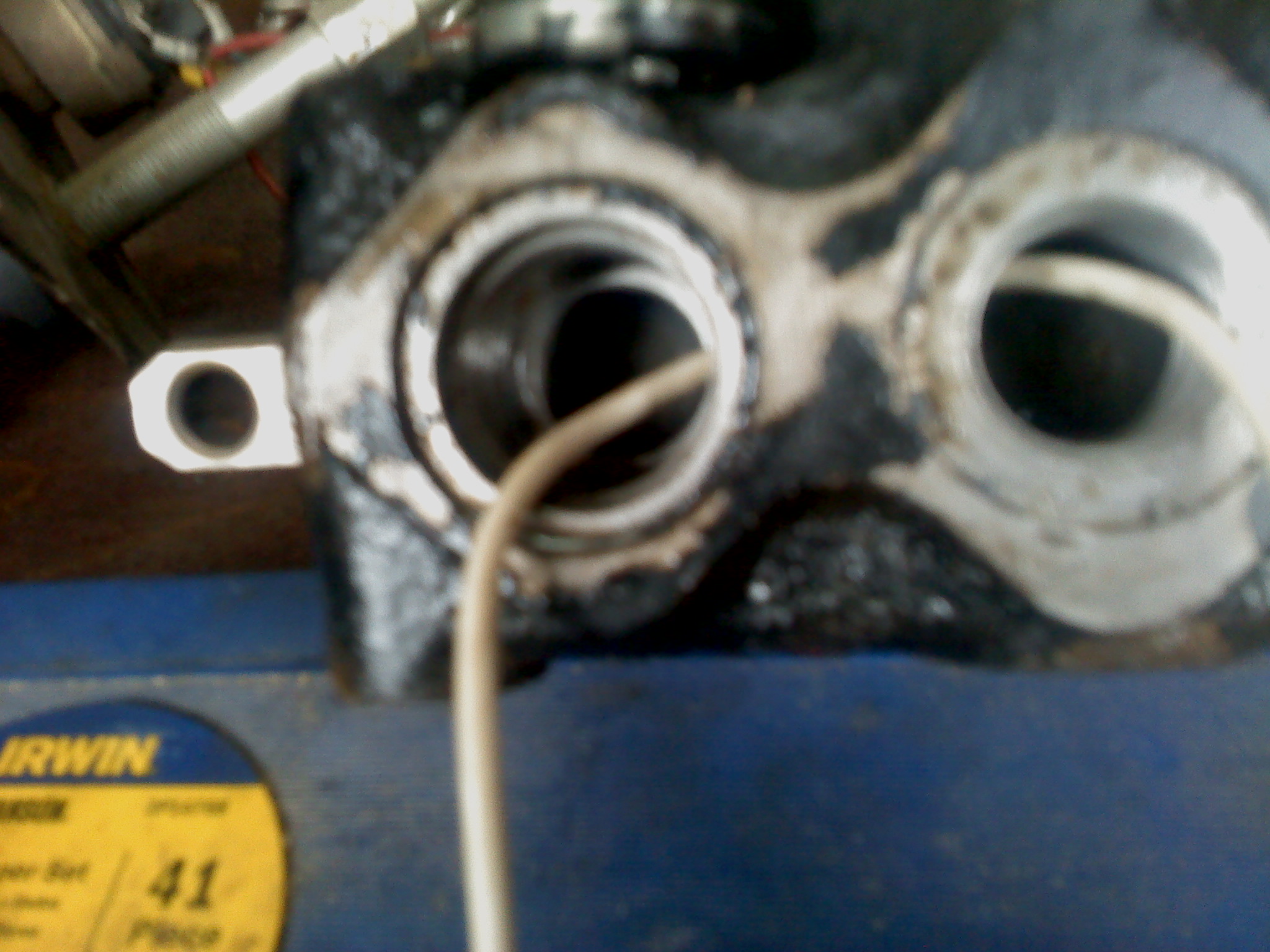

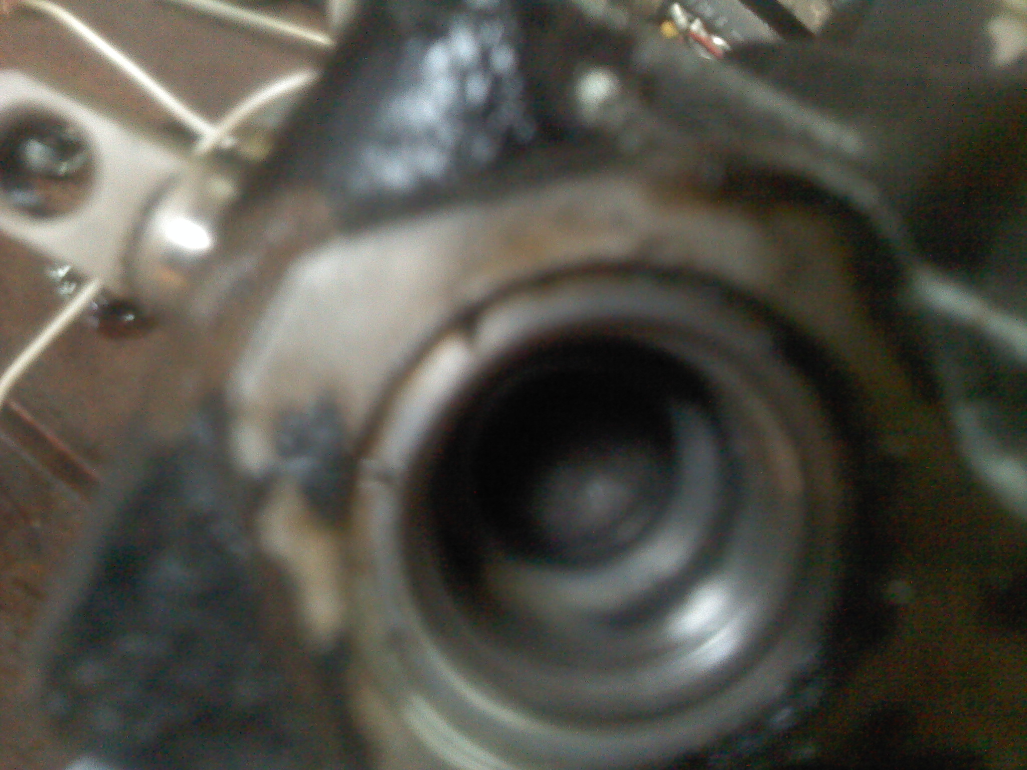

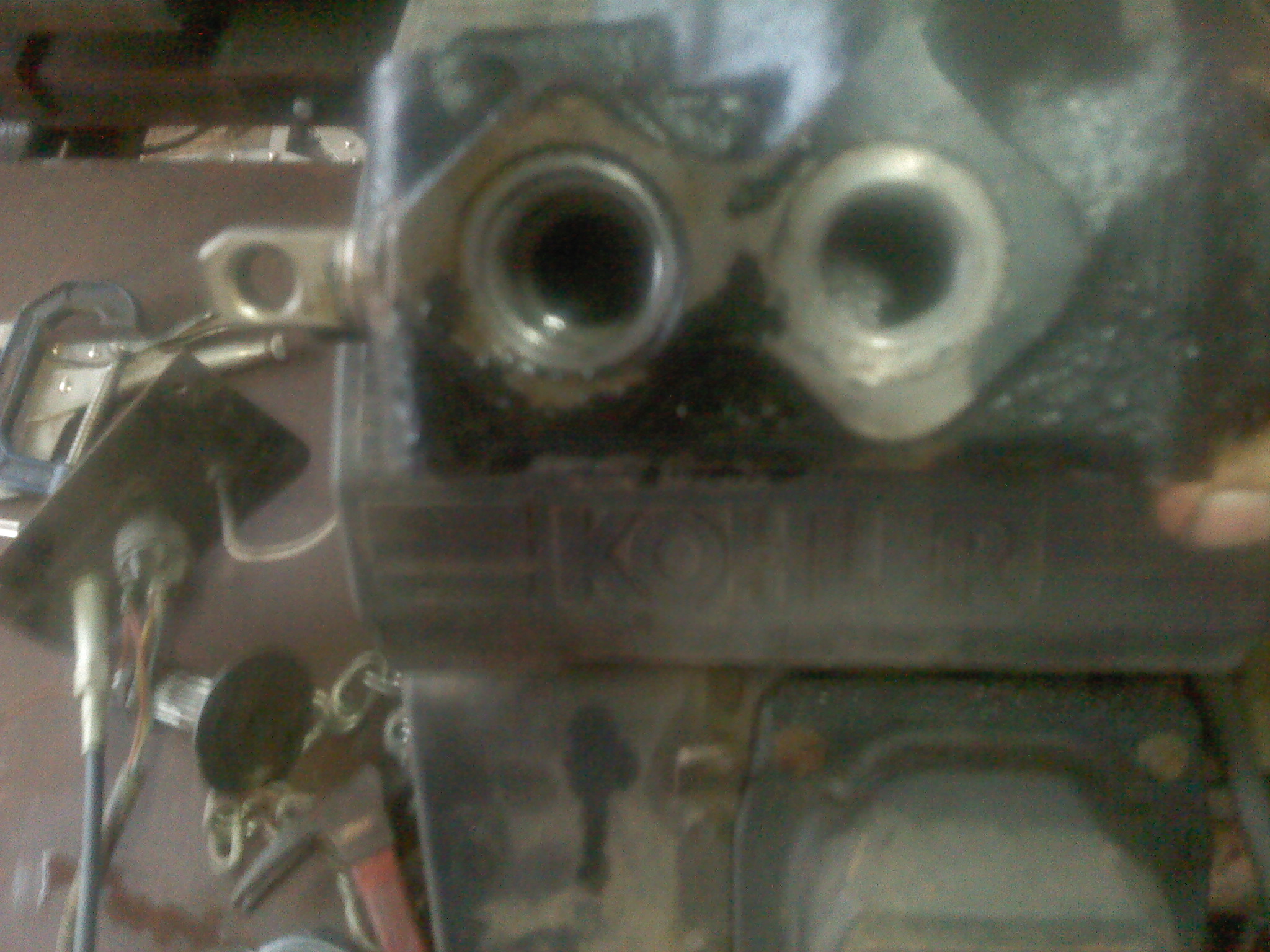

JJ, sorry about the pic's, they are from my cellphone and I tried all the different functions. I dont have a digital cammera.

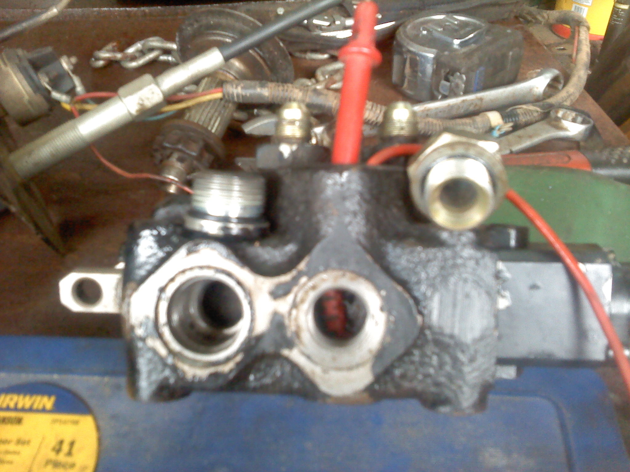

In the plugged outlet port, the bottom of the port looks to be a machined taper seat. The side of the port has a machined slot that connects it to the other 2 outlet ports. The plug in the port isnt long enough to cover the slot or to seat in the bottom of the port. I will also note, there isnt any manufacturers name or model numbers to be found on this valve. Even if it is convertable to a PB, I dont know where or who to order the proper sleeve from.

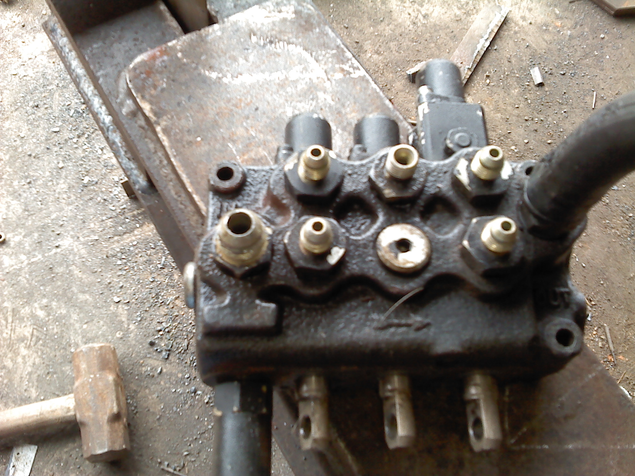

There are actually 2 pumps on the longarm. The small one (dont know capacity), I assume was for the boom assembly. The second pump, much larger, I am guessing for the hydraulic motor that spins the mower blades. The machine had an accumilator which I am guessing was to help boost the longarm. There is also another single acting valve, (large ports) I am guessing again that this valve was to direct the oil from the pump to the hydraulic motor. The machine was given to me to salvage parts from so i dont know and never saw how it operated. To the best of my memory, both pumps shared a common suction port on the tank as well as a really large return filter arrangement. As to how the valves where hooked together, I am not sure they ever where, except thru the return to tank line.

Someone used two of those OUT ports for something. One of them is for the cyl exhaust.
If there is no sleeve and just a plug in the two end port, they use the top OUT port for the exhaust. All three are connected to the exhaust cavity, and either port could be used.
If that valve is the only valve in that circuit, they would use only one port and plug the others ports. If they use another valve down stream, they would use a PB sleeve and pass the fluid to the downstream valve. Usually all cyl expended fluid goes to tank.

They might have tied the return lines from the two separate pumps common in this valve. Why add tees in-line if the casting is already machined.
If made in volume these mono block spool valves can be made with all types of special features that are application specific.
