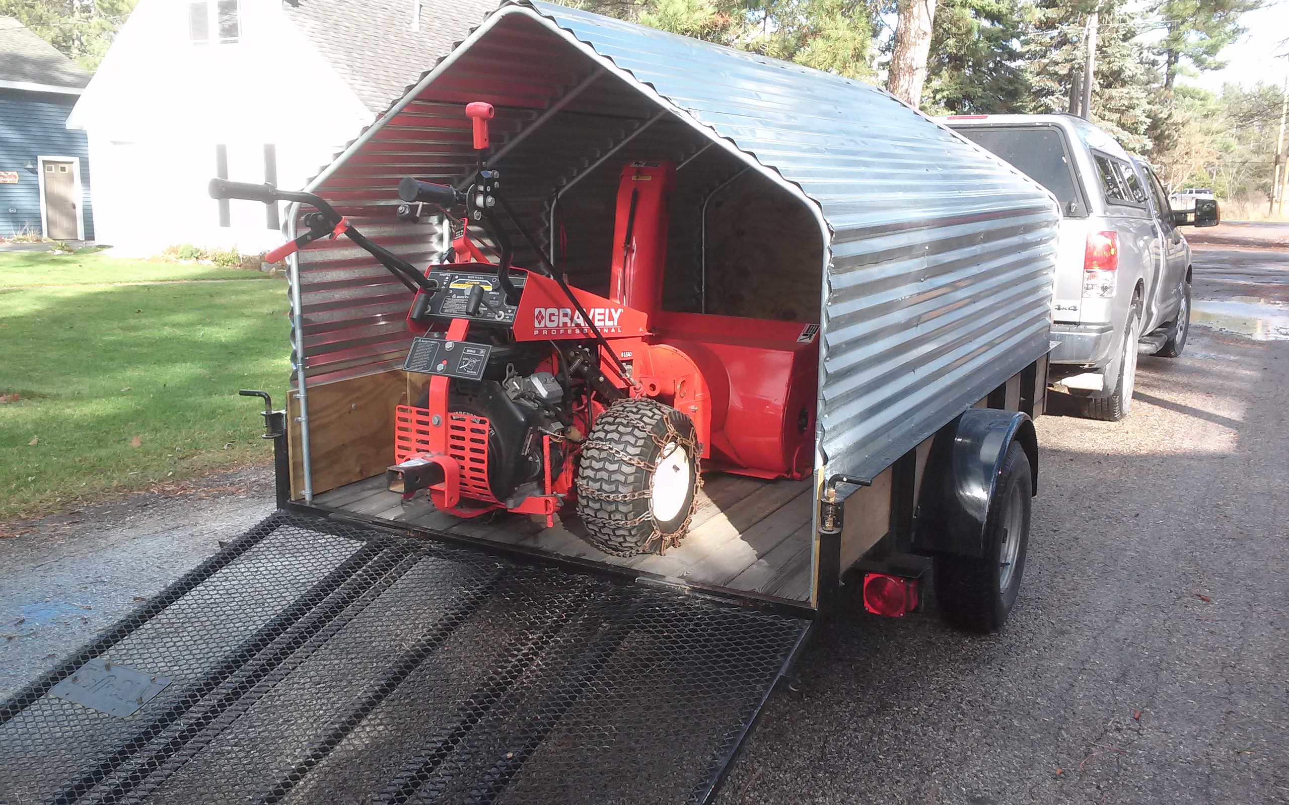

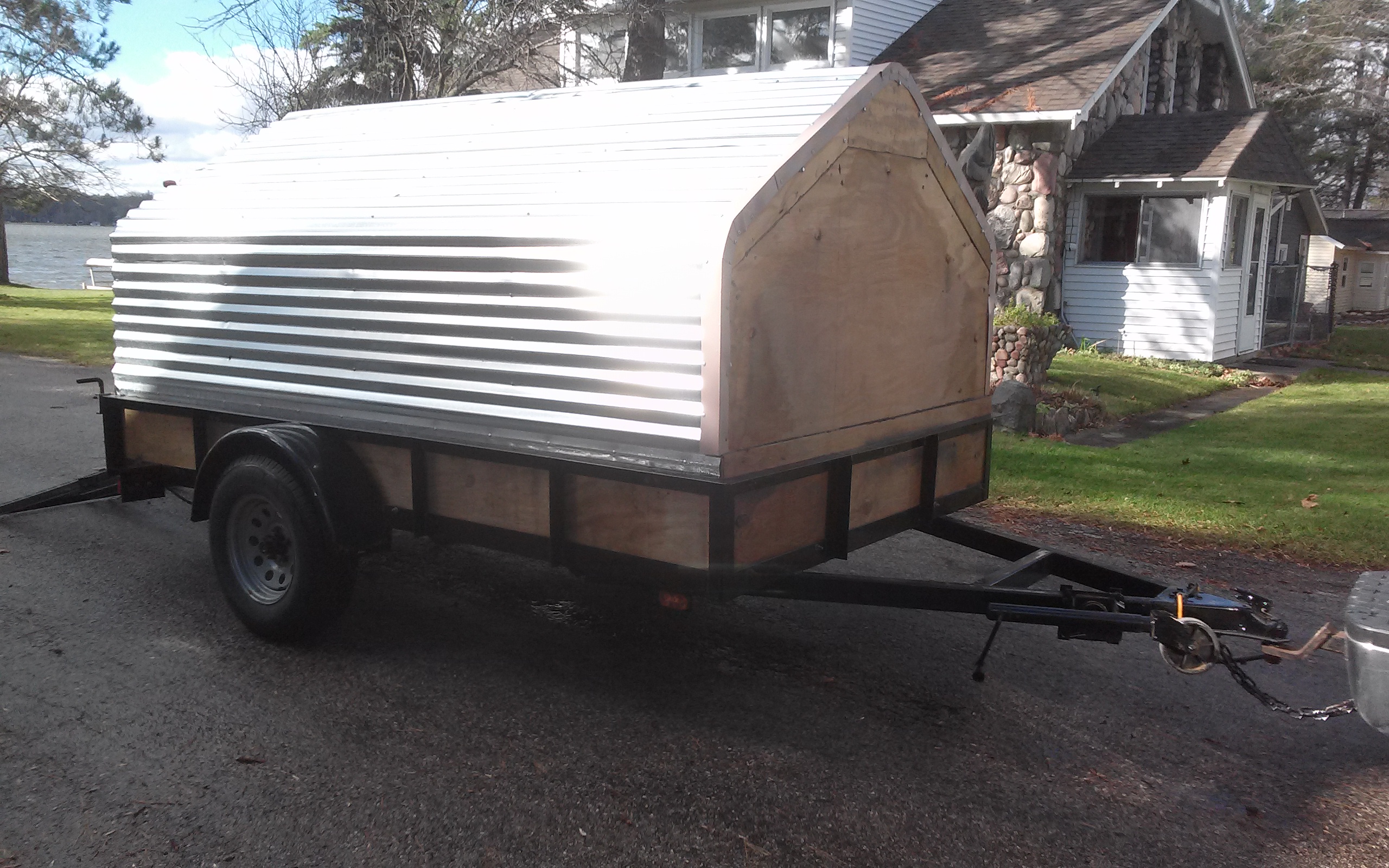

My 6 x 10 steel trailer can be moved by hand. However, this is on the trailer tongue wheel jack and good hard surfaces.. Also the tailgate has some additional angle iron runners on it counter balancing the tongue. But it can be a bear on loose dirt. Jon 1119151319.jpg1119151319a.jpg

I like the top on that. Did you use 3/4" EMT for the frame?
/ Utility Trailer Weight #17
Yes. Proto type was out of 1" pvc electricaltubing/fittings. (because I needed 45 deg elbows.) Had a tarp for few years until the wind destroyed the tarp. So I used a tubing bender to fab the supports and laid corrugated roofing metal over the bars. Works great, keeps snow and slop off the Gravely snowblower in the winter. Jon
