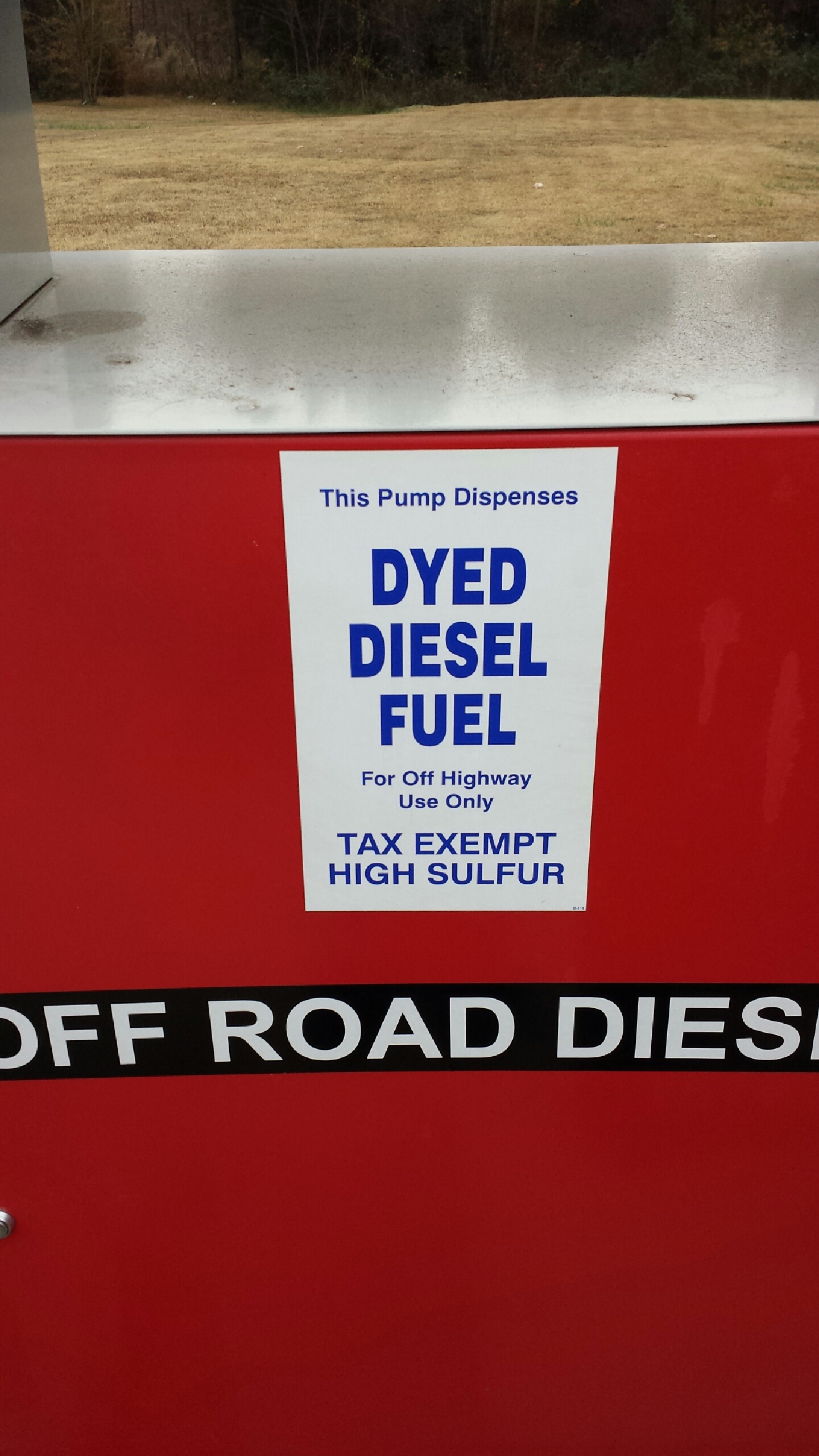

This is still confusing to me as well. Local stations can't seem to tell me that their dyed fuel is ULSD. Their pumps have stickers as follows:
As a result, I'm still buying on road diesel.
