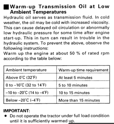

how important is it to let a K 3901 or B 7800 to warm up ?

Read the owners manual. It gives a chart of how long to idle before stressing the machine.
From working for companies that I've used very expensive excavators and loaders, the supervisors expect us to warm up the machine prior to use. Some machines won't let you move them or move them very quickly because of the safeties.

   / warm up #10
The below is straight from my Kubota's owner's manual:

I agree. Check the manual.
My mx5100 requires warm up from a few minutes to 20 minutes depending on the temperature. And that is at high idle 1500 to 1700 rpm. And the manual states this is to loosen up the hydraulic fluid which is circulating during warm up.
I choose to follow the builders and designers of my equipment not just make up my own advice. That never works out well.😄

Neither will I. Minimum warmup time in the is 5 minutes at 1500 RPM, again, following the owners manual. With air temp 40 or above that generally gets the engine up to operating temp. Actually, event at below freezing temps 5 minutes is all the engine requires. On my tractor the needle goes up to about 1/3 and I've never seen it get higher than that. The only thing I wish this tractor had that is doesn't is oil temp sensors.
