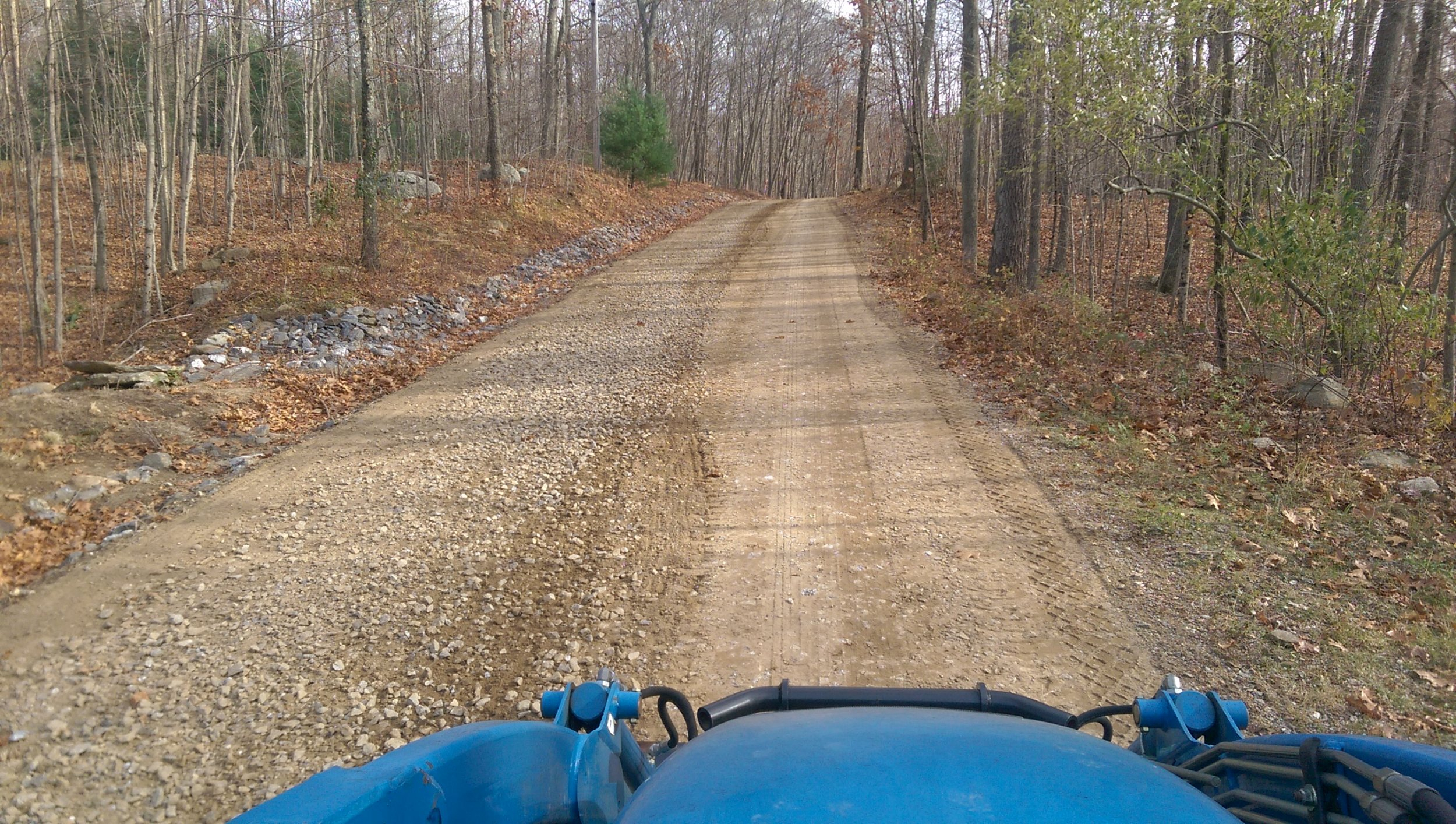

Those tonnage amounts sound crazy! And my driveway is longer than some of those projects. How many tons does a 7 cubic foot truckload of rock weight? Maybe it sounds like more than it is.
Anyway, good to know. I'm thinking I would have to substantially widen my ditch for rip-rap, which would mean a lot of tree work since the driveway is forested on both sides. Keeping trees out of the ditch is half my clearing battle.

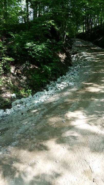

I can understand that... that's exactly what we had to do to create our drainage culverts... just under a 1/2 mile of it.... Since then I've been cutting the trees back a little further just to open things up a little more....

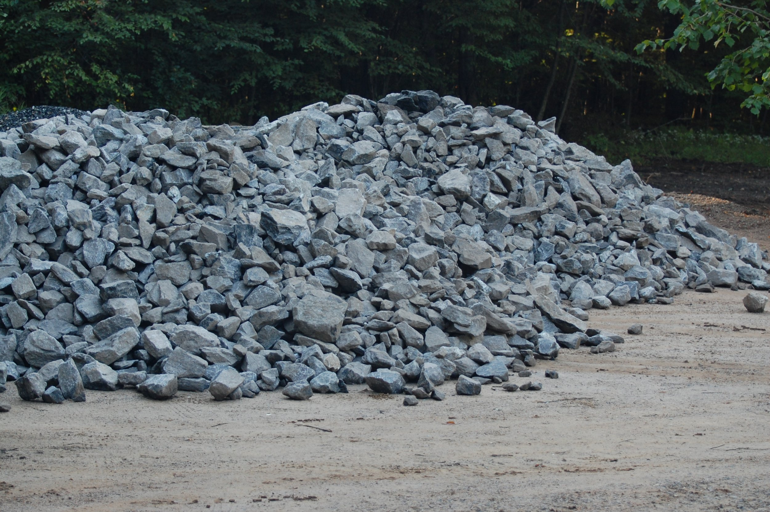

You can check with a local quarry they probably carry the 3" to 6" Rip-Rap which might work better in your drainage ditches... We went larger because I wanted the biggest, heaviest rock for the drainage trenches.... less likely to move / wash out. It really has held the driveway & dirt in place well...
Well... that is until Tropical Storm Elsa came in & dumped 5+ inches in hrs, & with all the other rain we've had, it destroyed part of the drive... :mad: But the Rip-Rap Stayed....

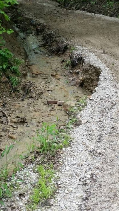

X2 on more pics and a better description about what the problem is. My take from the description and picture is that the culverts are functioning okay and water is NOT flowing over the road. I take it that the water rushes down the narrow ditches to fast and waskes out the SIDES of his road.
If he has room, he could dig out a couple of swales halfway down his hills, to deflect some water, and slow it down.
Don't know if it is a 50 foot problem or a 1/4 mile problem. More pics and fuller description would help.

Just to better understand your problem, doesn't your washout show water running alongside your road - not across the road?
Washout across your road = undersized culverts.
Washout alongside your road = Water moving too fast / ditch too narrow/ ditch material not stable enough.
