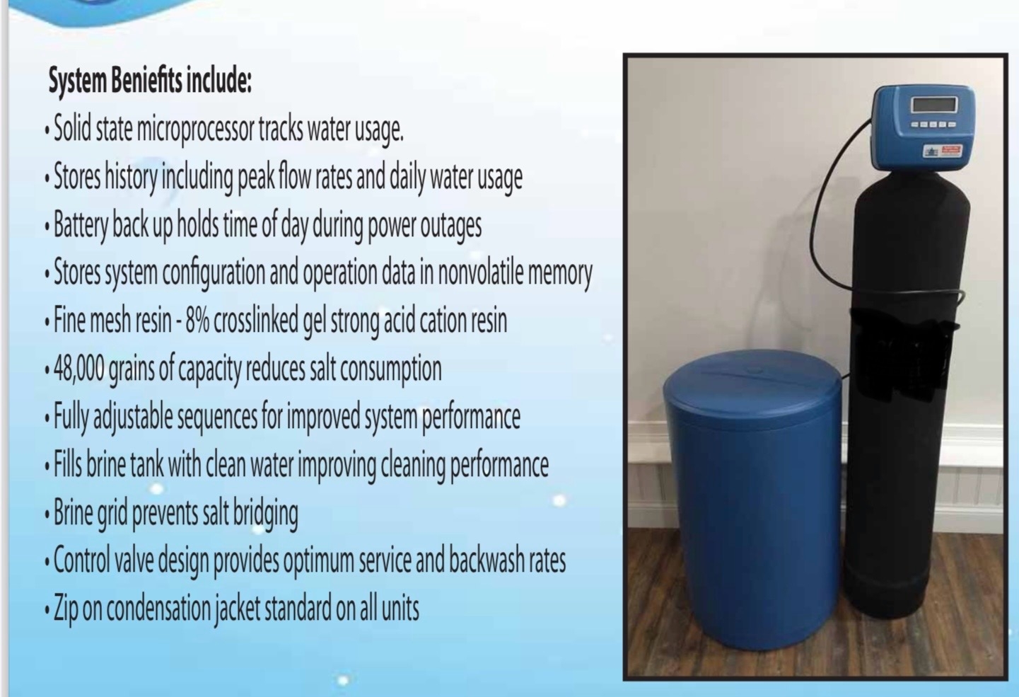

I am getting another quote but I'm anticipating it being similar and why I'm wanting to install a system myself. I've done pex work before with either crimping or using Shark connectors.
Here's what the system quoted would be.
48,000 gallons
/ Water softeners - do it yourself systems #5
48,000 gallons
I just looked back at the bill and I was wrong, it was $1900 + $100 to dispose of the old equipment, not the $1400 I originally posted, but still nowhere near your $4800 which is still more than double what I paid.
The equipment is basically the same as what I have. A standard 1.5 cubic foot softener. The control valve is a bit different and it is stamped with a different "brand" but it's probably manufactured by the same company (Clack). Here is what the guy that installed mine said, he liked to talk. These things are only manufactured by a couple of companies and they stamp them with different brand names and then they are sold by those companies. Any difference in price of equipment is all based on the markup of the company selling them. There is a 90% chance that it is exactly the same as mine.
The only extra this shows that I don't have is the condensation jacket. Condensation is not something I need to worry about because run a dehumidifier in the basement.
